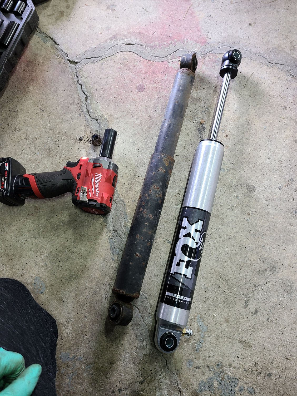

Has anyone installed a steering stabilizer made for another vehicle?
Reason I'm asking is bc I want a matching fox steering stabilizer but one is not listed for the d2. Another one must fit right??

As long as it’s an eyelet style end on both ends just get the extended length & compressed length and get one similar.
Did some research. Think this will work fox 985-24-063
I'll let you guys know how it goes

Good news. It fits with very little modification! Had to trim off a few mm's off the rubber bushings on the fox shocks and use a pry bar to spread the brackets on the truck.
My stock one must have been dead bc steering became a little stiffer.
