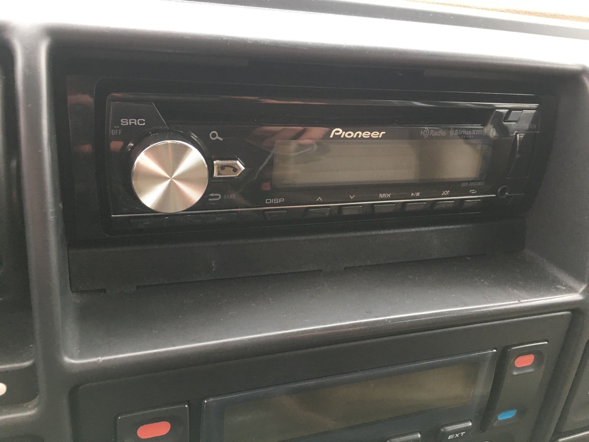

It’s just a Pioneer DEH X8800BHS, the above harness, the steering wheel control adapter, an the little thing that covers the space when you put a single DIN head unit in. The only tricky part was programming the steering wheel controls. OEM speakers, amp, wiring, etc. I think a PO put new subs in the tailgate, but that’s it.
