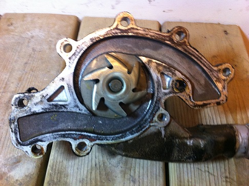

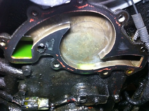

Just as an aside and personal experience. Four months ago I used Rislone (Bar's Leak in the US) Liquid Copper Block Seal Intake and Radiator Liquid Copper to help solve a valley pan gasket leak. It worked a treat. Last week I replaced my water pump and took these photos.
As you can see there are no deposits in the water pump or block at all (the blackness in the pump is just mild oxidation of the aluminum). There were no signs of the copper that you can see in the additive. I also replaced the Thermostat a couple months ago and it had no deposits in it either (I only replaced it for the 180 Grey Land Rover Thermostat to lower my running temps, the original was working just fine).
Just thought I would dispel some myths.
