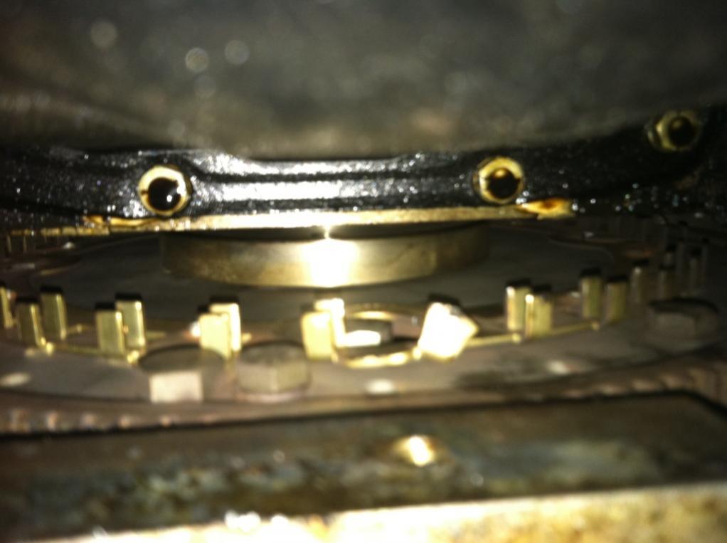

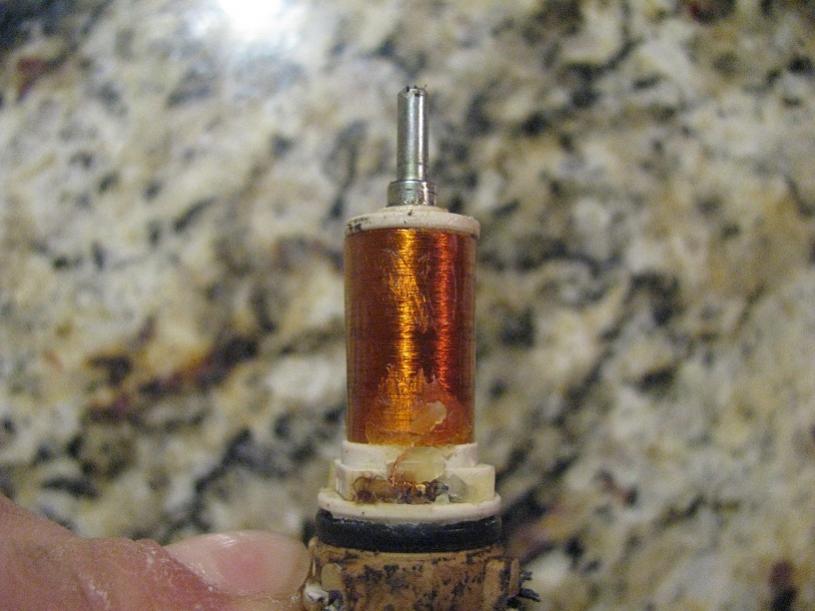

Spark easy to test for with spare plug attached to a wire you pull off, lay on manifold. As stated, the CKP sensor can fail in several ways, and in one way it "resets" when engine cooled off or water poured on sensor. It is a coil of wire around a point that rides at a very sensitive space in a slotted disc that turns with the engine. It does not contact the disc, but a signal is generated as the disc flys by just a few cat whiskers away. Attached pages from Bosch manual. If you replace this under $100 sensor, plug it in and let it hang, not a lot of room to work. Every nut and spacer must go back on exactly like in came off or truck won't start. The CKP sensor has to send a signal that the engine is turning at 80 rpm or better during cranking or fuel supply is switched off by one of the brain modules.
As for fuel pressure, you should hear the fuel pump run for a second or two when you turn on the key before cranking. The fuel pressure regulator and the fuel filter are part of the pump assembly inside the fuel tank. There is a pressure test port valve from the fuel rail on the driver side rear of engine, sorta under the top of the intake and hard to get at. All the fuel injectors get battery volts from fuse F1 under the hood, and the ECU grounds each one individually to squirt. Melted wire, skinned wire; these things happen, but usually result also in codes.
Pix of sensor (bent tip or covered with metal fuzz is also bad), disc it mates to, and pages about the CKP sensor.

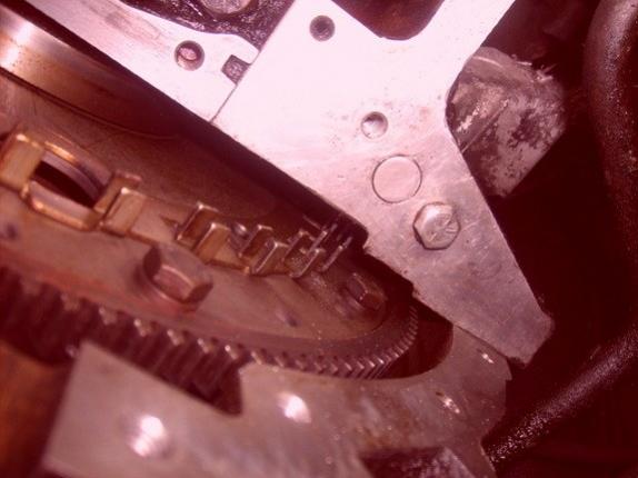

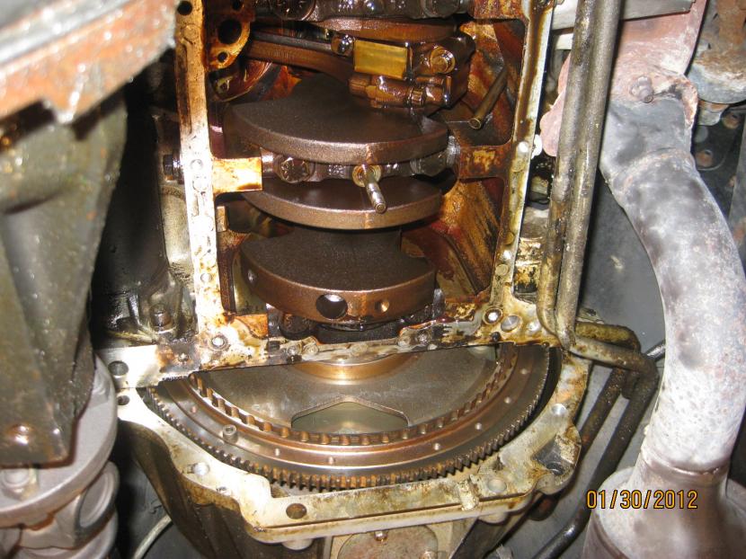

Pretty much, if it does not have a distributor. The sensor is triggered by teeth that fly by on a stamped metal reluctor disc. Sometimes teeth are savaged by bad starter, etc., get bent, break off, certainly when one rams a screw driver in there to rotate the engine.... On the D2 they have a drilled reluctor disc. In both cases there are 60 points that create a pulse, minus one skipped spot, that serves as the index to the ECU.
