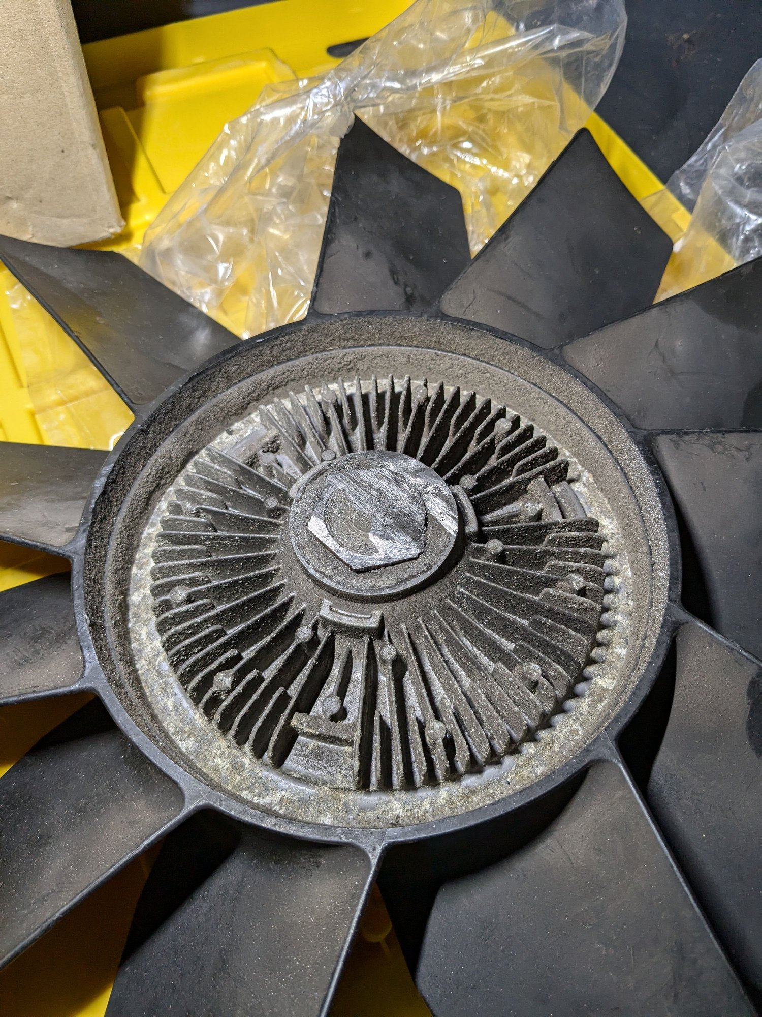

I've been fighting my fan for years. Even tried a Pneumatic fan clutch tool. Everything failed, bought a fan pulley holder etc, used two ppl tried it all. Eventually had to cut it off, sawzall with metal cutting blade. Took a while, probably 40mins.
Good news was I installed a flowcooler water pump, old one wasn't in horrible shape just chasing a few degrees with AC on
I bought the Hayden 2791 (half price of 2991) approx $40. Only difference is it sticks out about an inch. Still fits with ease. Had to buy 4 5/16 1/2 inch bolts from the big box store. Used some prestone coolant flush and water (plan to drain and refill in a couple days).
Everything running good, in 86 degree weather got to 179 (inline thermo with 170 stat) while driving. 183 with AC on idling about 20 mins. Can't complain, I would shut the AC off once it hit 194 in the past.
​​​New fan fan clutch and water pump

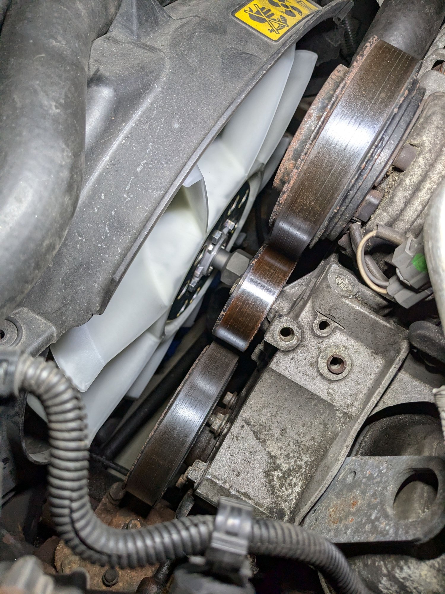

A little worried about your belt. Seems the lines are showing through to the back side.
Old Jul 20, 2024 | 08:16 AM
huggi's Avatar
Joined: Jul 2016
Posts: 210
Likes: 39
Good eye, it's at 45k miles. I'll replace it, cheap insurance. Thanks
