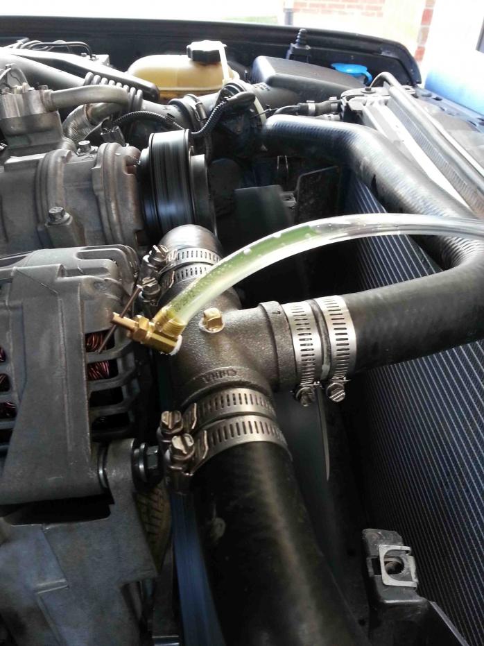

Just a basic screw from the parts bin.
You can also fab the whole thing from some plumbing parts, while there is no hardware store there must be pipe fittings around somewhere.
The trick in bleeding is not to stop after the first bubble. There will be more.
Attached Thumbnails Stuck in Northern Canada and need help trouble shooting!-20121012_163945small.jpg
Savannah. Is that your set-up? I like

coors - not my setup (D1 here), but one of the best work arounds posted. Valve inclined to clear the hood. Love the drain line, you can bleed into a bucket and not make a mess.
