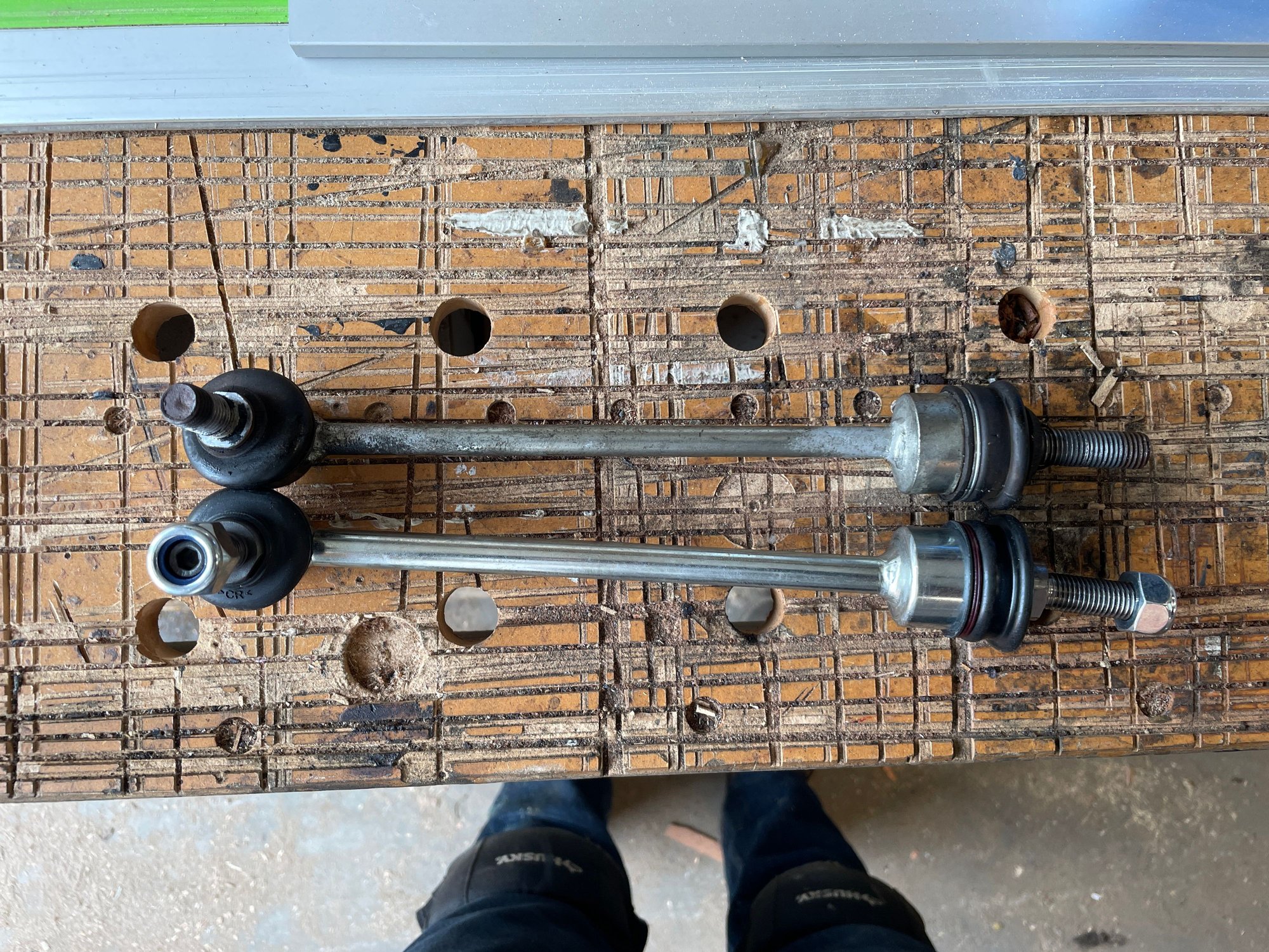

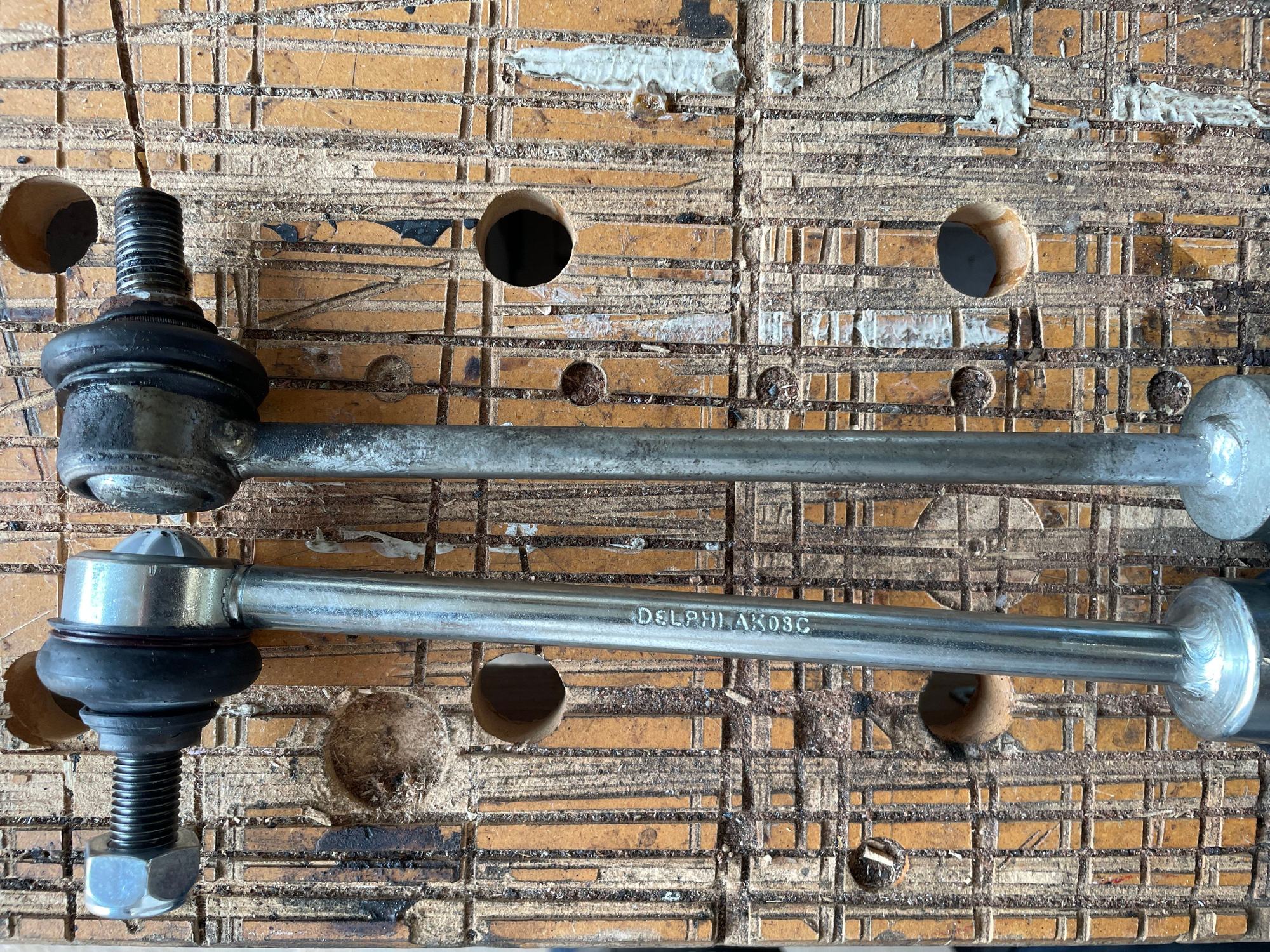

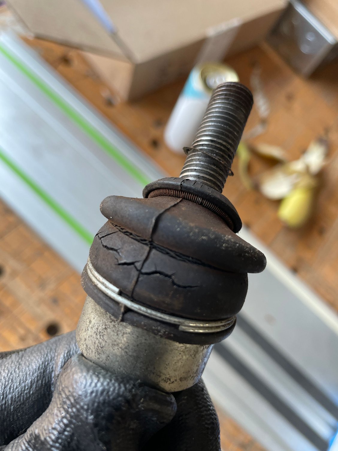

I was working on my brakes last week and noticed that the sway bar links I installed last July were already cracked and bleeding grease. Suck. They were whatever brand Lucky8 was selling. They were cheaper than the other usual sites, but gosh, I sort of expected L8 to have a baseline standard of quality for the parts they sell. Nope.

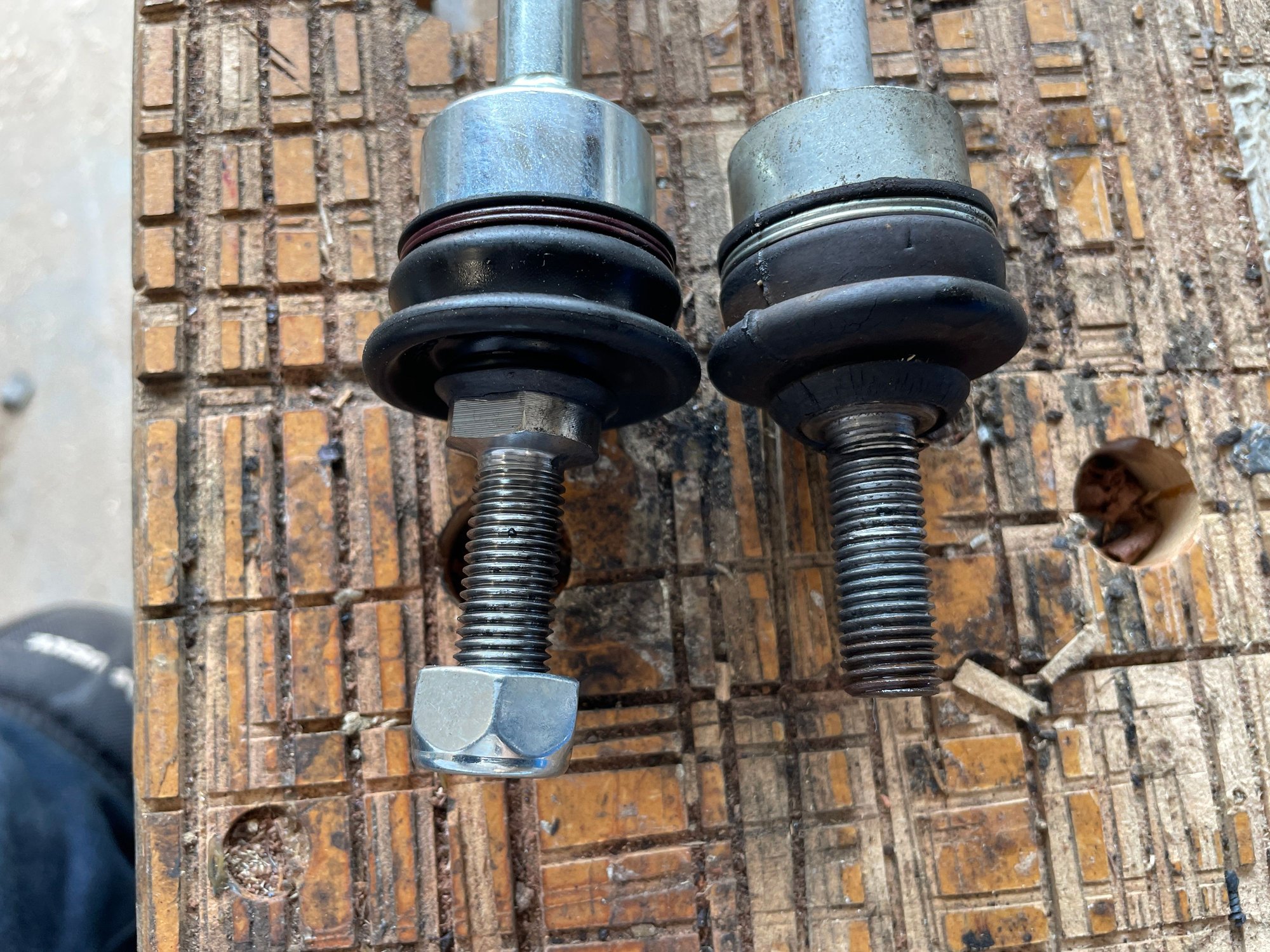

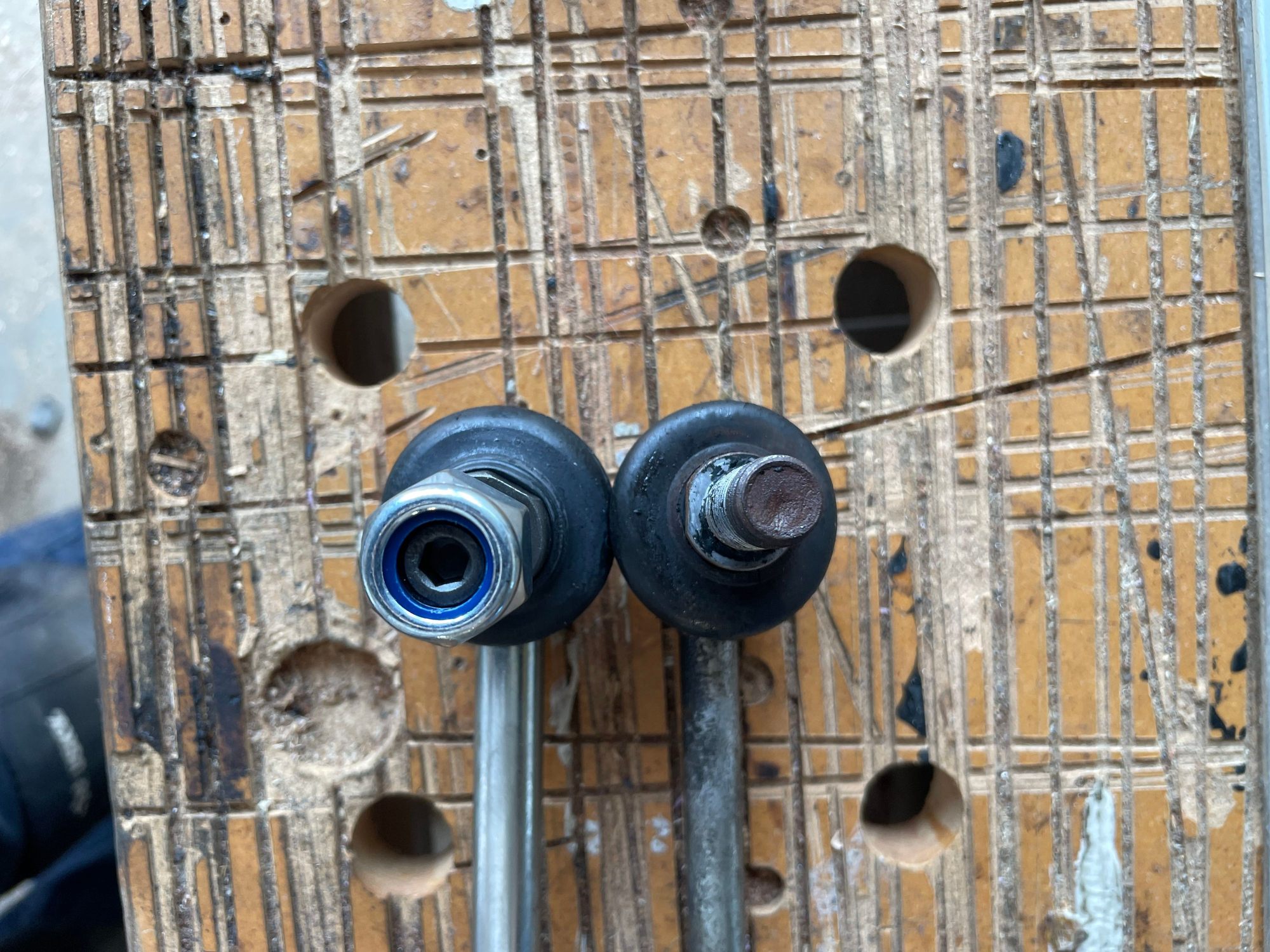

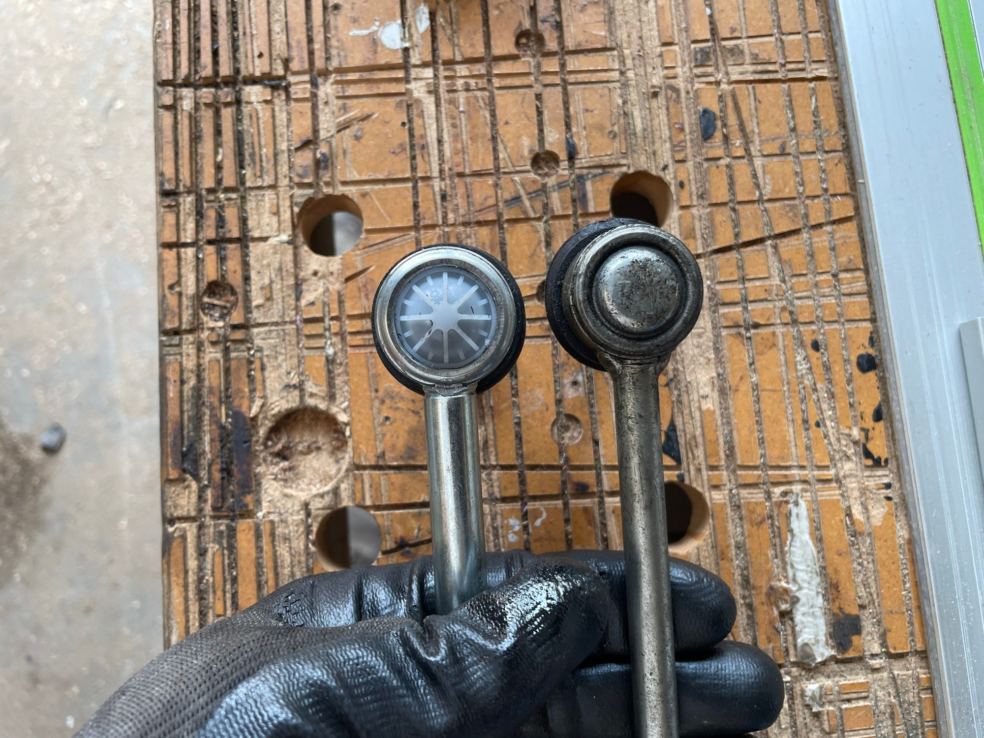

So I ordered some Dephi links from Atlantic British. They were about 2x the price but wow, what a difference. Basically everything that could be different is. Some photos below to show you what you're getting for the money. Something that doesn't photograph too well but is super noticeable in person is how much thicker the actual rod is on the AB part.
Moral of the story (telling myself this too) - the bitterness of poor quality lingers long after the sweetness of low price is forgotten. It would've cost me way less over the last year to simply by the Delphi parts rather than buy them plus the oatmeal that L8 sells.
