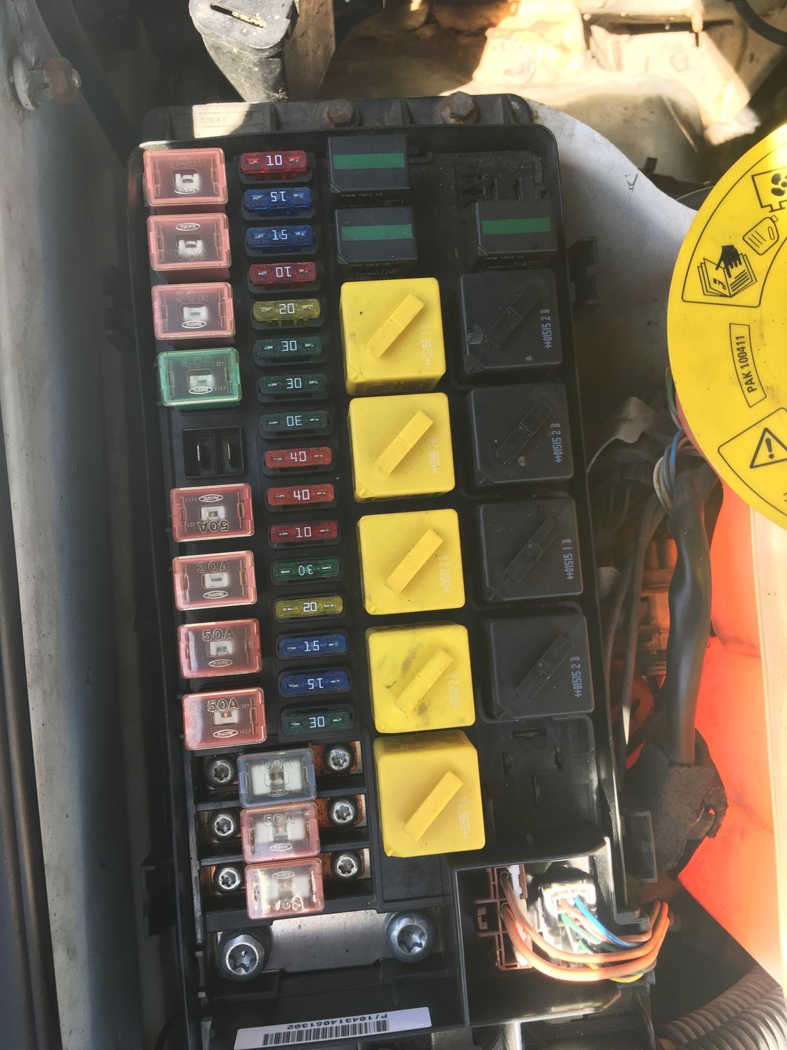

I have new question. This engine fuse box. Are there suppose to be ones missing? I’m so confused I looked up fuse boxes for sale and some have ones I don’t have and some don’t have ones that I do have? What in the world? Are they all supposed to have one in its place or no?

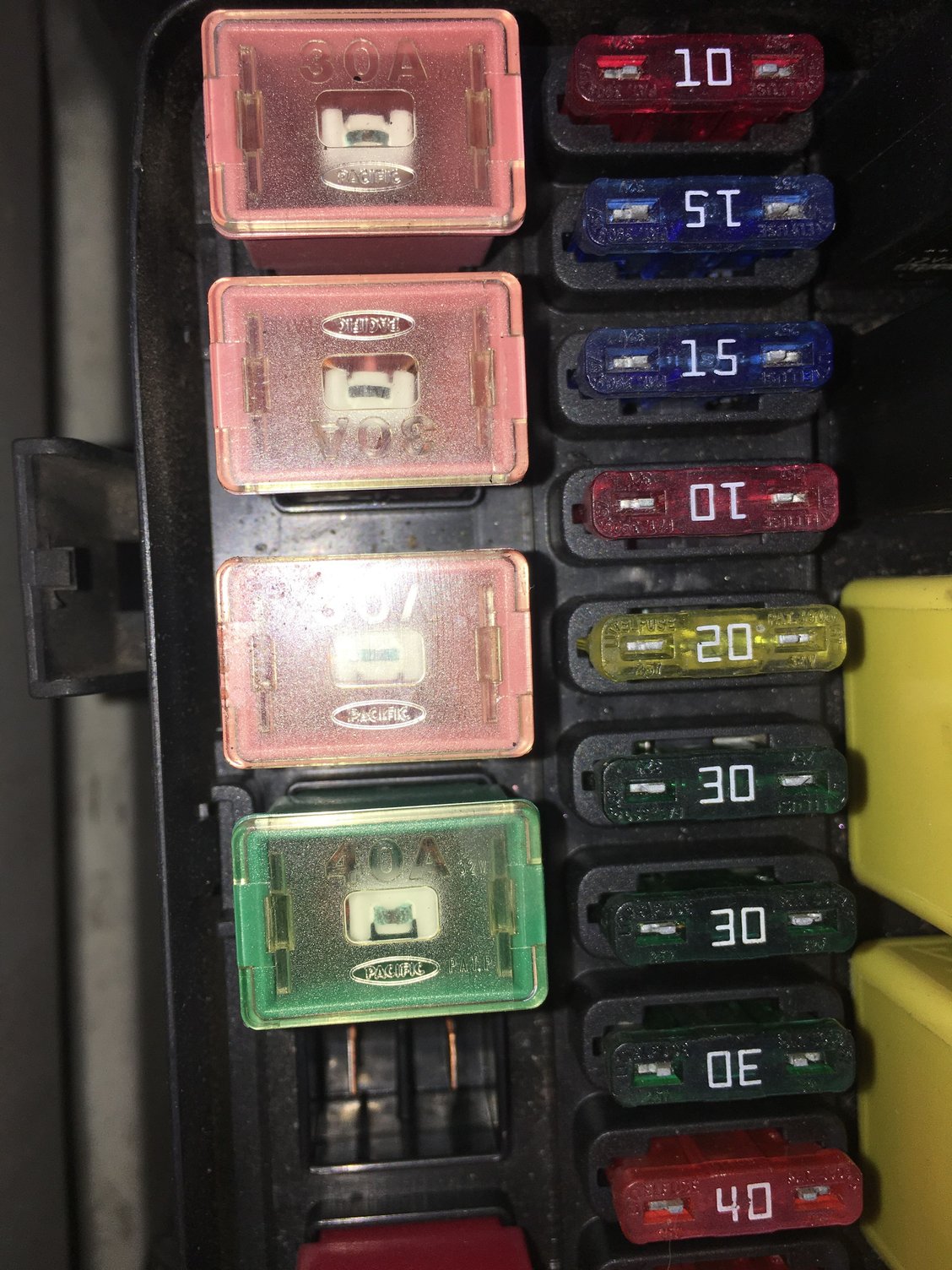

Idk who Paul or abram is but I might need to figure it out. O’Reilly says they sell 13mm bolts but have to know exact one to match it up etc so that means get it off then bring it back in. Stuff completed today so far~ back o2 changed, new MAF in, 2 new fuses from engine fuse box thats it. Again the engine fuse box confuses me I try and look them up and the ones ppl have for sale well some they have I don’t and some they don’t have I do I’ve attached a pic, other than 30a and 40 reg one, anyhow see any I would need? Also there is green corrison on some? Should they be changed due to that?

You can get a used fusebox with complete fuses on ebay which are cheaper. Often the green corrosion you see on the post goes even deeper than that. The fusebox itself is separated in the bottom half and can be replaced completely with a new set of working circuits. About the xyz, on 2003 the beige is really tight and you might end up rounding the gear and misalign it completely and its not a perfect fit but you can chance it. About your starter, i am guessing that it need to be aligned.

Yep you are right idk what to do at this point. I had someone helping foot on brake and idk I guess I just can’t get it, I tried but I think I screwed it up worse as it wouldn’t come outta gear at first then trying about 5x after that finally got P to light on the dash, N is still shifty but in starting to think it’s the tan one and you know when I replaced it I pulled a tan one off so it had a tan one on it, just heard how much better it was used micro something or other as opposed to the black but at this point I highly doubt I should drive it, will try again tomorrow in day time as it started to get dark and I have up, good news got those bolts loose of course, I think if I had a whole new cable it would likely help bc mine isn’t like the videos I found it isn’t just simple to adjust. I just gotta figure out what the Exact word for that cable is called so far I only find like whole new gear shifter assembly that’s like $200+ and so guessing I should just replace the entire fuse box? Does it look bad in those pics? I tried to take up close so you could see the green corrison on them. Man this xyz deal isn’t a joke when ppl said it will drive you mad they weren’t kidding. I’m thinking of calling the Land Rover repair job (guy only works on rovers and jags) to ask him what he’d charge to fix the stupid thing or maybe I should just buy another one~ a black one. I msg the guy on eBay to see if he might have just cable to sell that I bought the xyz from and it showed 90 day return deal so maybe return it idk it was $85 and maybe it’s not right cause the N deal I don’t feel like is something I can fix as it seems to be in the switch itself
