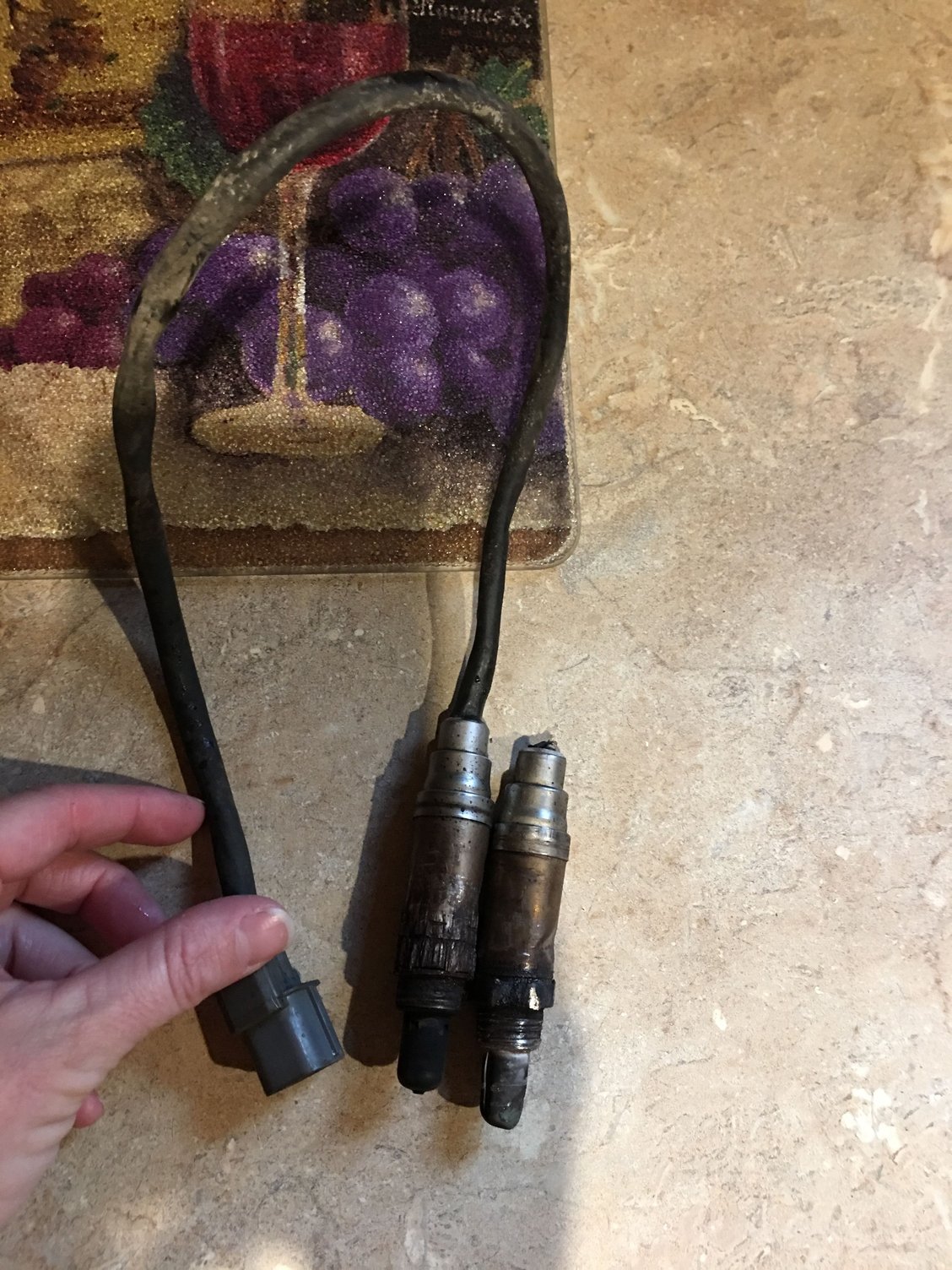

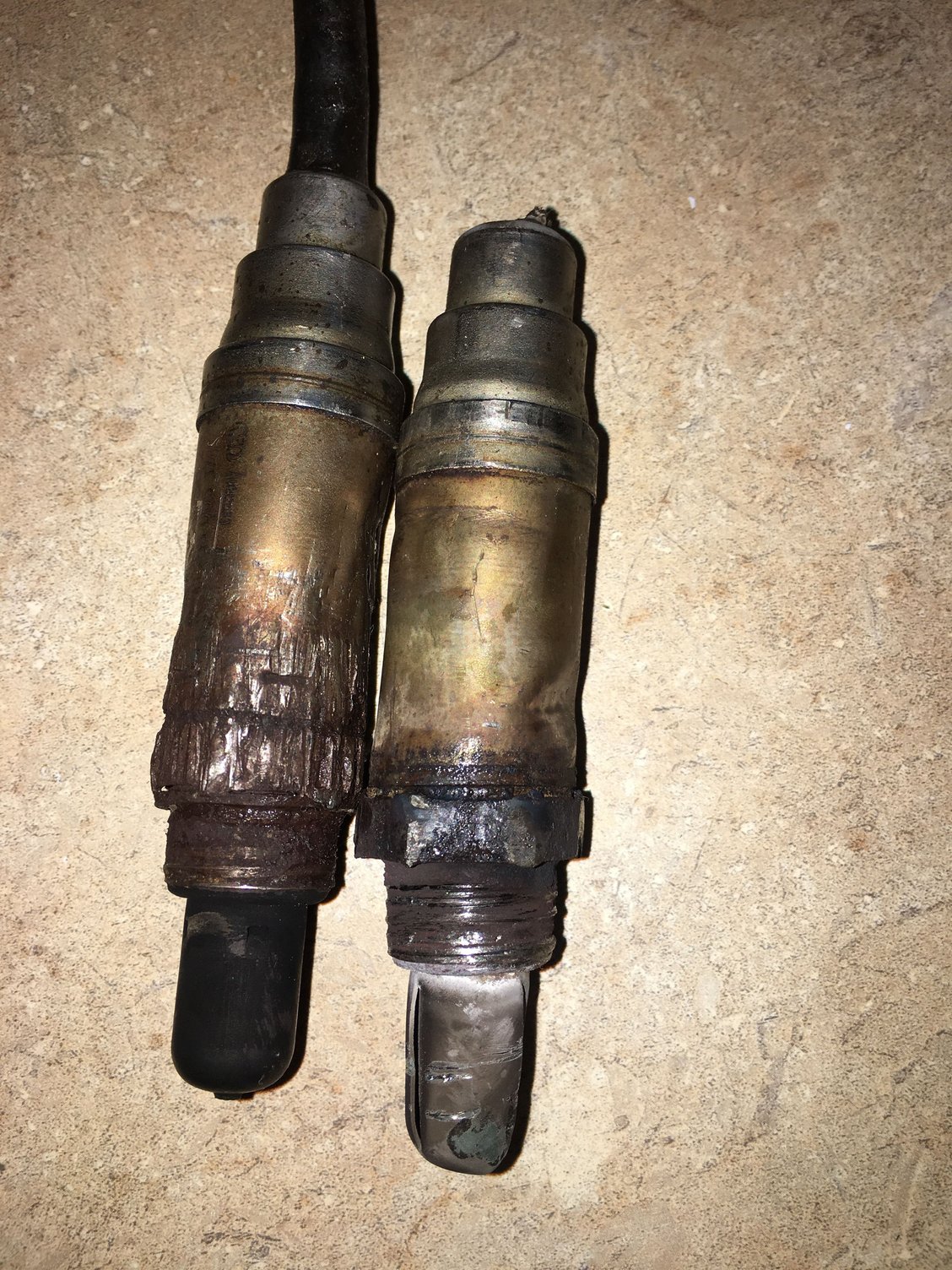

So here’s a back one and a front one, tell me those are bad lol. That’s why you threw me off saying it’s rare th back ones go bad but blow torch worked got the one front one off now omw to harbor freight to buy an extension to get the other one off
Looks fine to me! HAHAHA!
Great you got it out. Congrats! Youre on your way for a smooth ride. But yes its true the back rarely dies but needed replacement as well, you have a rare disco. LOL!
