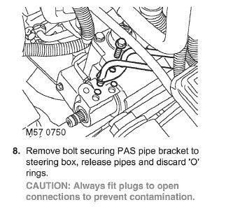

Definitely check these. Also the steering box feed and return o-rings may be worn or nonexistent if the mechanics messed with it.
