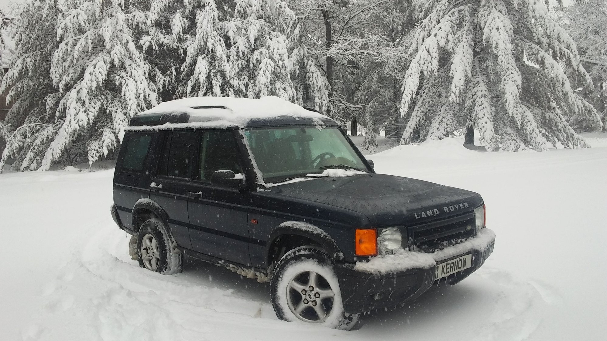

This is what she looked like before the tow strap slapped her:
I'm assuming everything aftermarket will show something unless I get a plate installed underneath, correct?

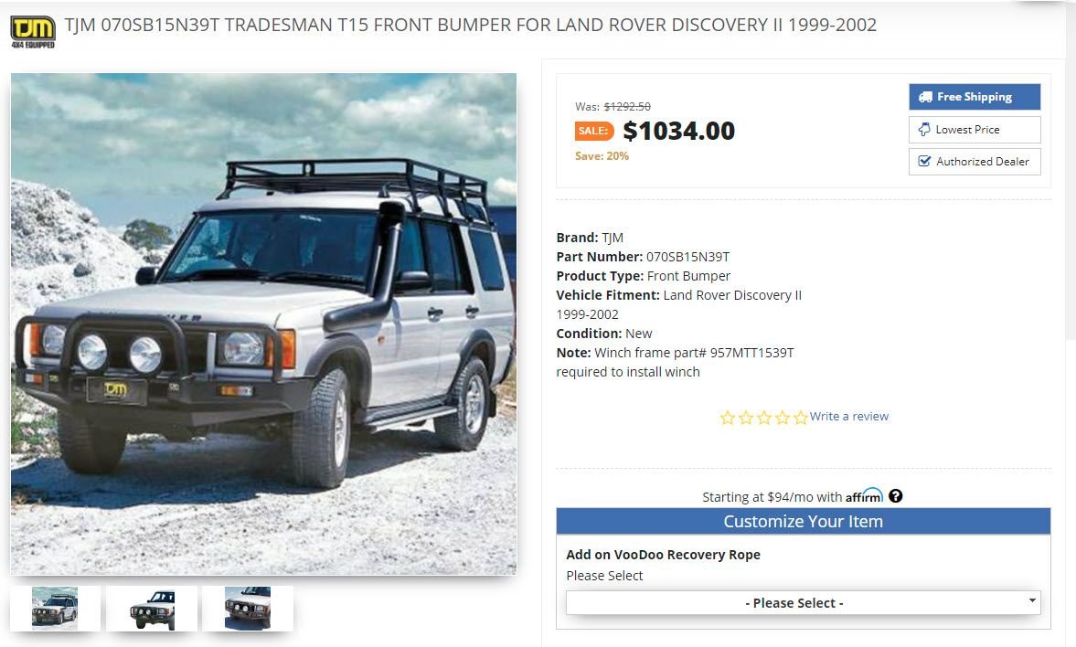

Here's a TJM I found:

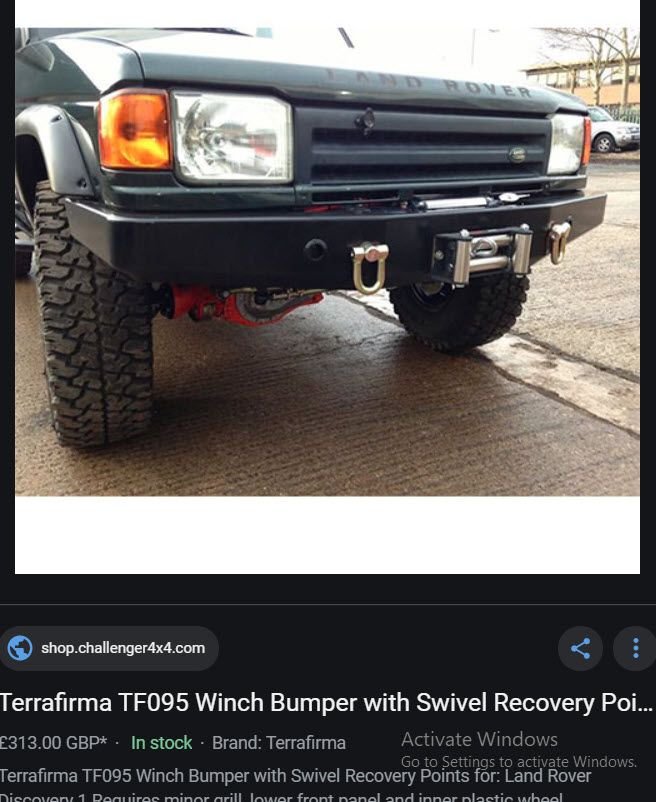

This one was on the Lucky-8 website but states 'Terra Firma' on the front? Not too sure which one it is:
I do like the bull bar look in both photos above, but again am concerned about what will show underneath and how hard it is for a shop to put it on.
Is this the low profile you're thinking with Terra firma below?:
Anyhoo... still pondering on what to do. Thanks for all of the input. I can see the pros and cons to each.

All 3 of those are nice and yes that is the low profile TF I was talking about and you should be able to get a Non Winch version. I've got a D2 TJM on my 95 D1 and I absolutely love it very sturdy and very nice looking. I've heard good things about the Lucky8 bumper as well. Installation wise = 4 to 10 bolts for the main mount/crush cans, and any smaller screws like with the TF for the washer bottle skid plate. Removal of the old one is the hardest part vs installing the new one A shop shouldn't charge more than an 2hr or they have no clue what they're doing.
