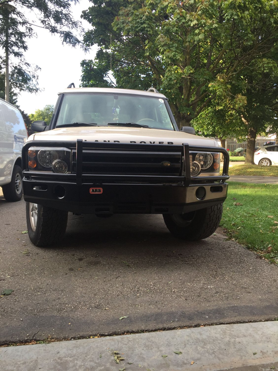

Arb bumper looks amazing but to my surprise there was no tow points on it

Yeah the ARB 03-04 units = deleted the front tow points. The earlier D1/D2 ARB bumpers had them, and yes on a sideways recovery pull = they would bend. I had one on the 99 D2 get bent after that 96 Chevy Truck ran the red light. I just got home, hit it straight with a 25LB sledge and it's good to go. Straight on pulls = they work just fine.
You can always install those aftermarket frame mounted front recovery hooks or for a pure emergency get a hold of the stock 99-04 D2 unit. It will be up in there a bit, but if you used a shackle and a strap vs a chain (chain would eat the bumper lip up) it will work.

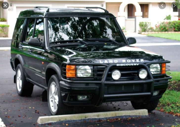

You want to know something pitiful about my decision making? I've been looking at all of these steel bumpers and saying to myself 'where am I going to put my British Kernow license plate?' haha... My husband bought that for me when we were apart waiting for immigration papers to go through - he was still in England and I was here holding down the fort a few months after we were married. A colleague of mine volunteered to put it on for me and it's been there ever since. 13 years ago! I did see this set-up in google images today... curious if this is a stock bumper with a brush bar over it? I like where the brush bar sits in relation to the lettering on the hood. Anyone have any idea what it is?

Those brush/bull/push bars show up occasionally on market place and other sites, usually for under 2 bills...depending on condition. Granted, you'd still need to get a factory bumper.
https://www.roversnorth.com/parts/dp...g_discovery_ii
The factory one is probably going to be 7 bills shipped. I've also noticed that some early Dll's have the outer portion color matched...so it is a possibility. Believe, "Saturmine" did this to his Dll (in his build topic).
Yes, that is a Land Rover brush bar over the stock bumper. I have that setup on my 2003, minus the extra lights.

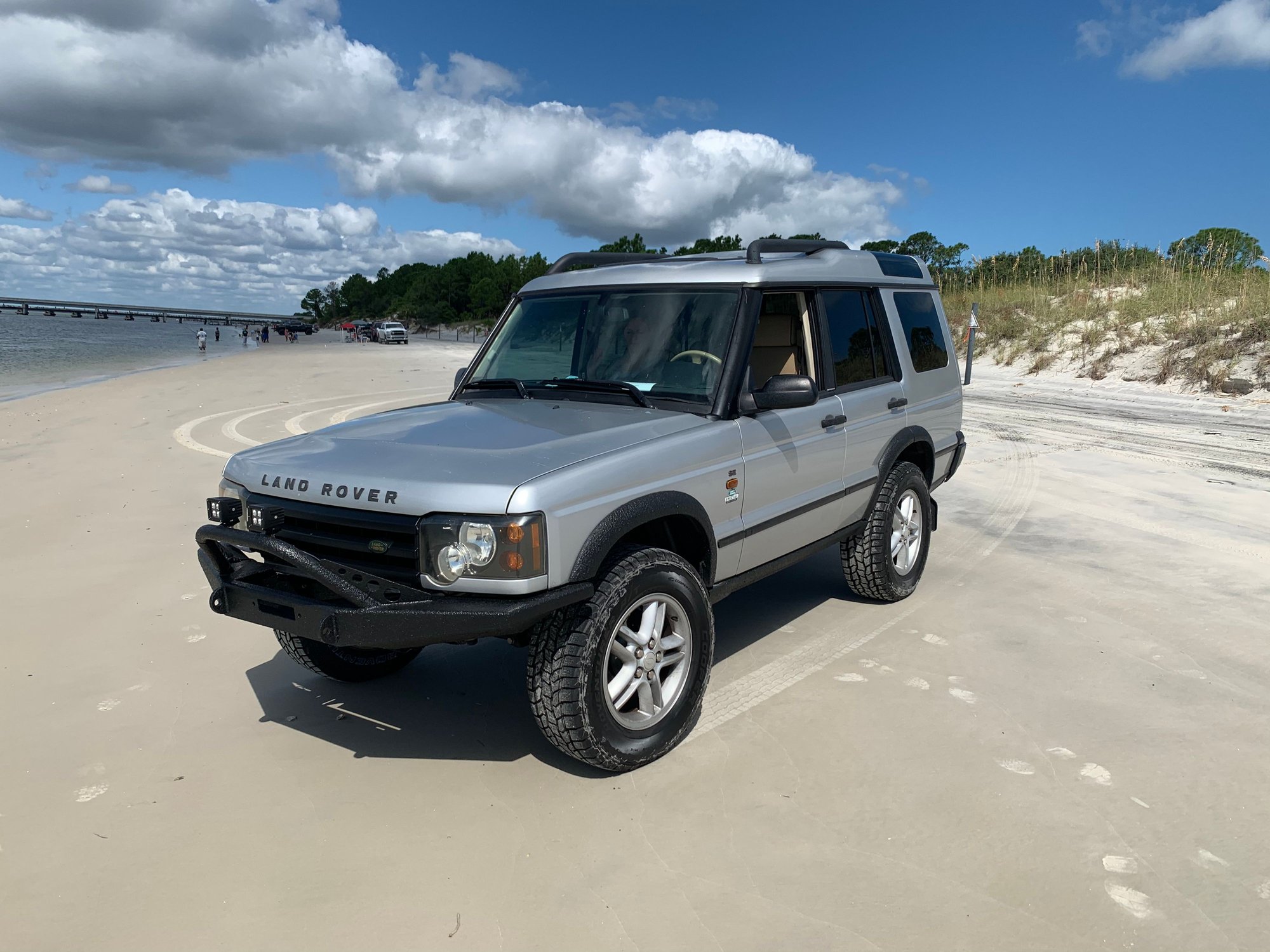

Are you talking about the recovery points? I think they honestly showed up on LR's first to be honest. Jeep bumpers usually always just had the 3/4 shackle mounts. I've got a set of those shackles on my TF bumper and I don't mind them vs the 3/4 shackles. You can tighten the Allen bolts and they won't make any noise like the 3/4 shackles.
The Jeep bumpers I used to HATE used the copy cat H1/H2/H3 recovery points. Rugged Ridge started that and then a lot of people copied it. They looked big and beefy, but if you actually looked how they were secured it was down right scary! I owned an H3 Alpha and those puppies went directly to the frame vs a 5mm piece of steel.
I do really like the look of the OEM LR brush guard, but I've also had one completely destroy the entire front end of my LR after being struck by an average sized deer. After that 6k repair bill I went with ARB bumpers, and 2 aux lights tapped into my high beams. After that I haven't had a run in with anything that got anywhere near 6K in damage. The worse I had was an aux light mount break.
My XD has the OEM brush guard on it currently only because it's got limb risers attached to it, and the aftermarket bumper I have for the XD doesn't have any hoops so I've gotta figure out a way to nicely mount em to the front fenders.
