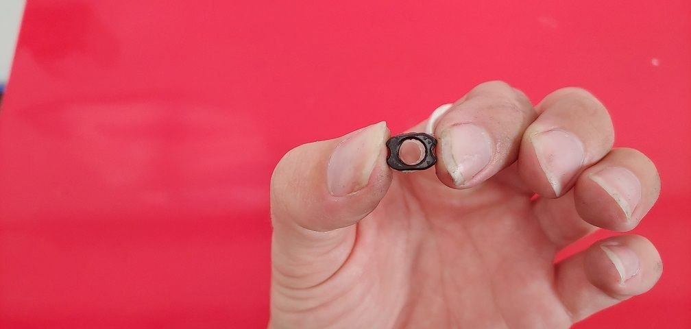

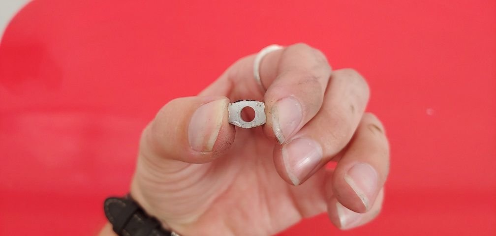

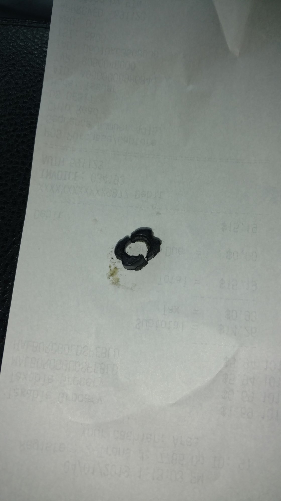

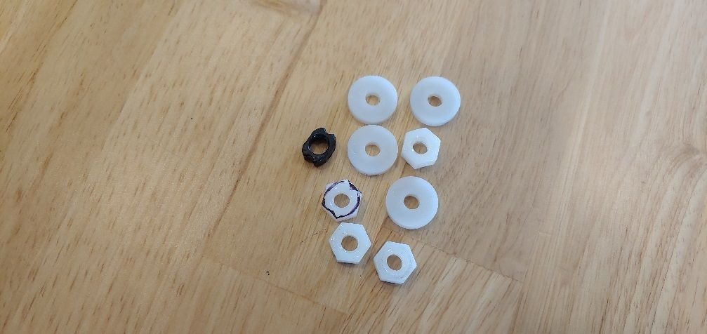

I could not find any being reproduced when I re-did mine recently. I ended up going to Ace hardware and getting some nylon nuts and washers(I brought one of my remaining good bushings to match size) and got the closest ones I could and modified from there.
The best option I found were white plastic/nylon nuts that were essentially the same width, so I only had to shave the top and bottom down, add a little notch to the left and right edges, open the interior hole a smidge and then I think I also took some of the thickness down a little as well. Photos kinda speak for themselves.
I can't stress how nice it is to not have them banging around over every goddamn bump in the road now.
Original
Assorted nuts and washers. the nuts were the best option for thickness as well as closeness in size
After rough cuts
Afterrough cuts, comparison
