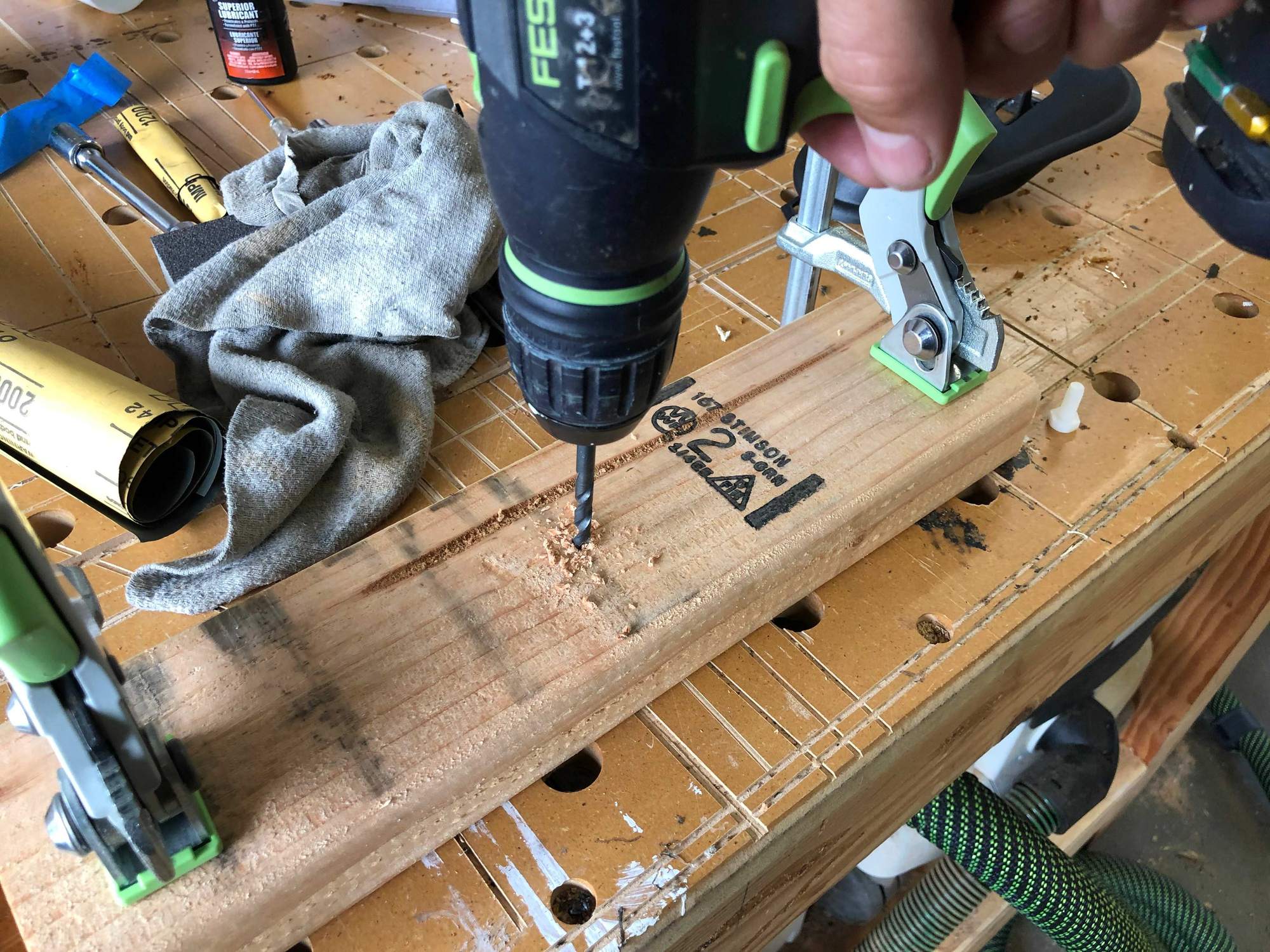

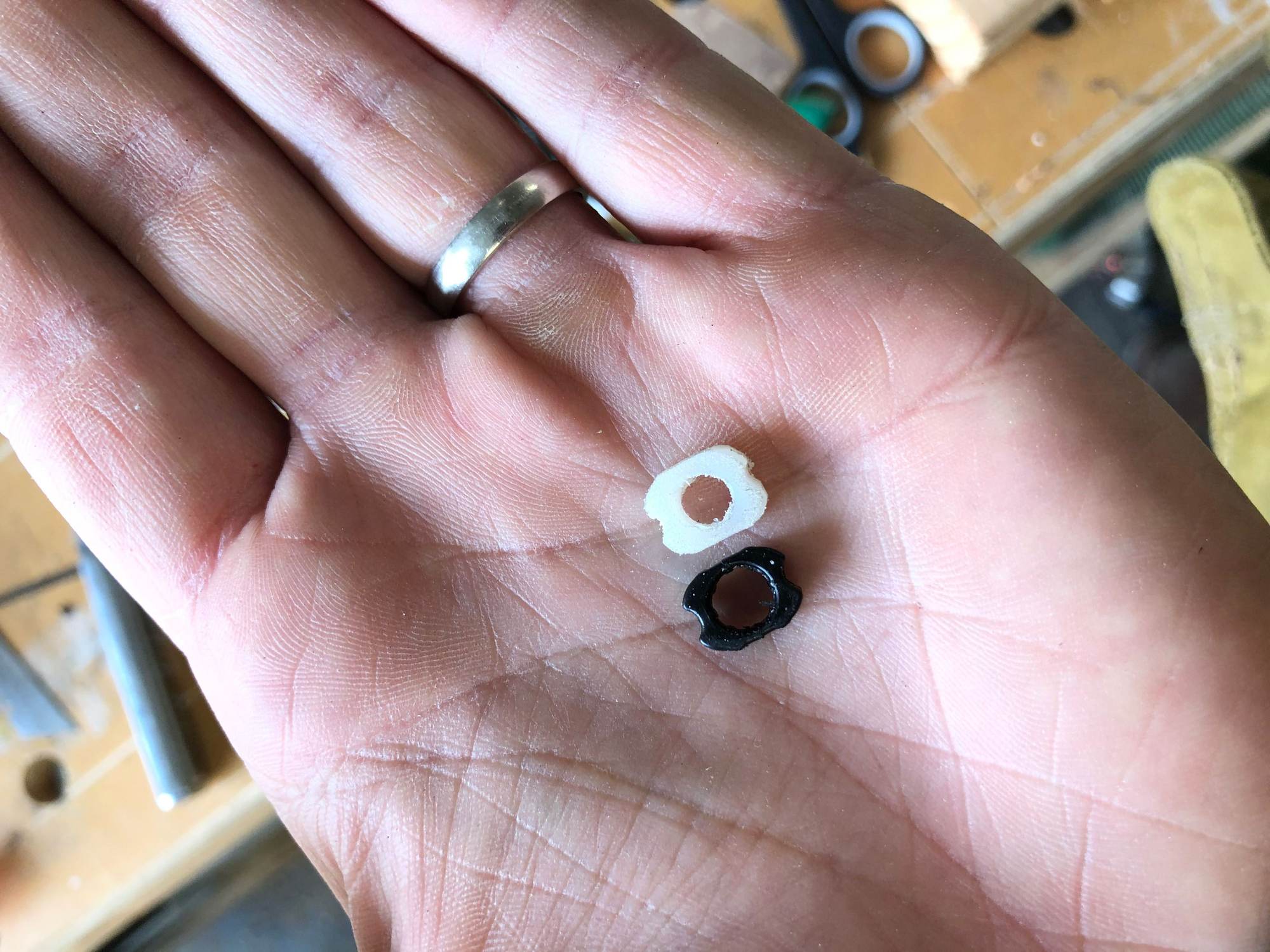

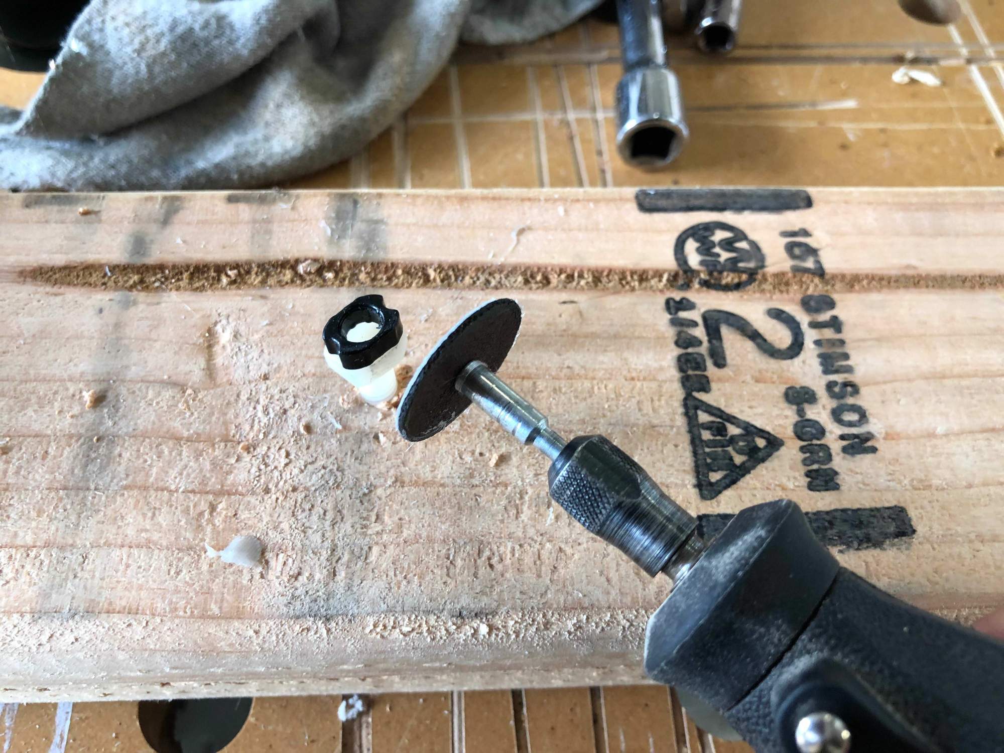

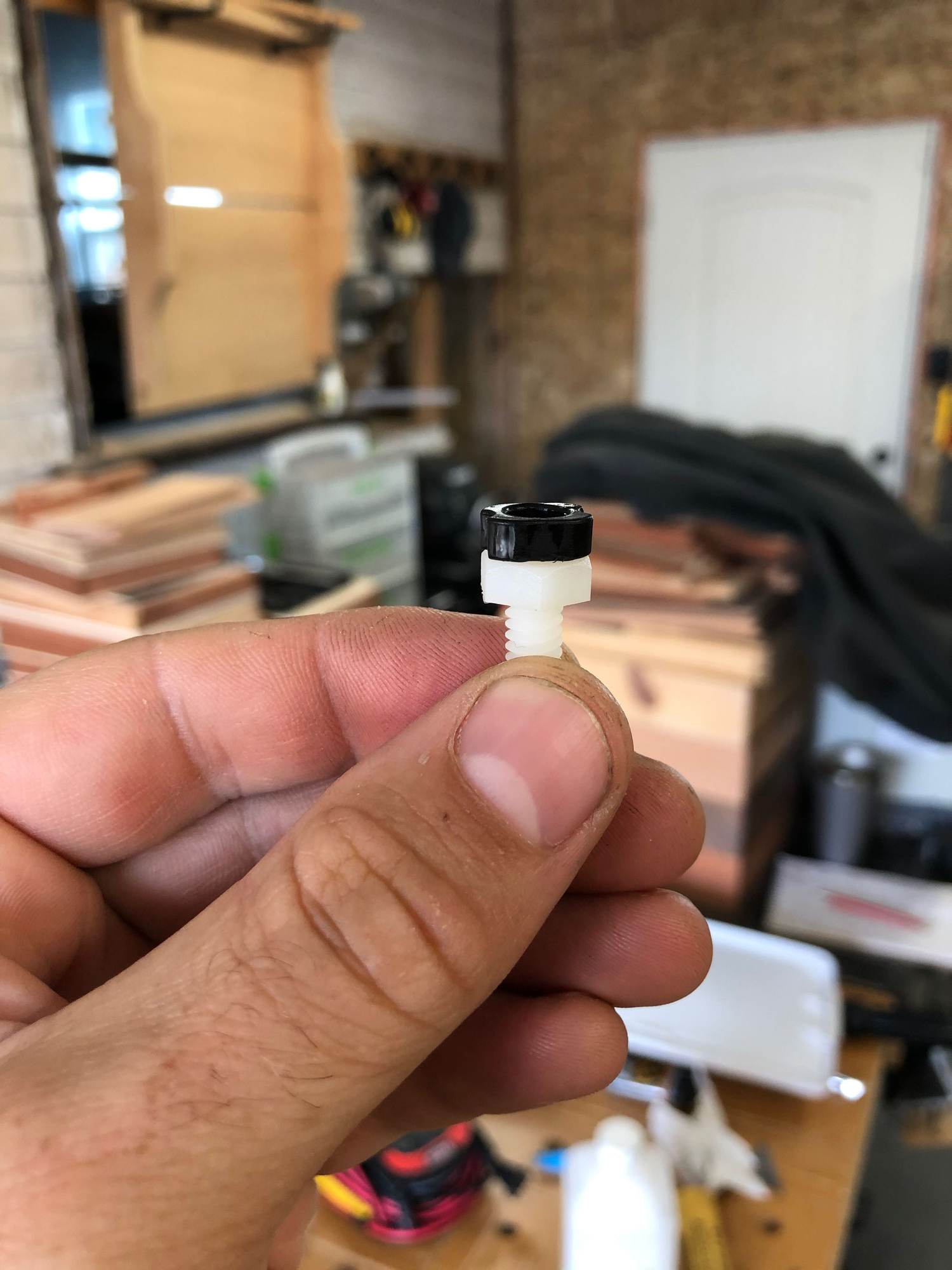

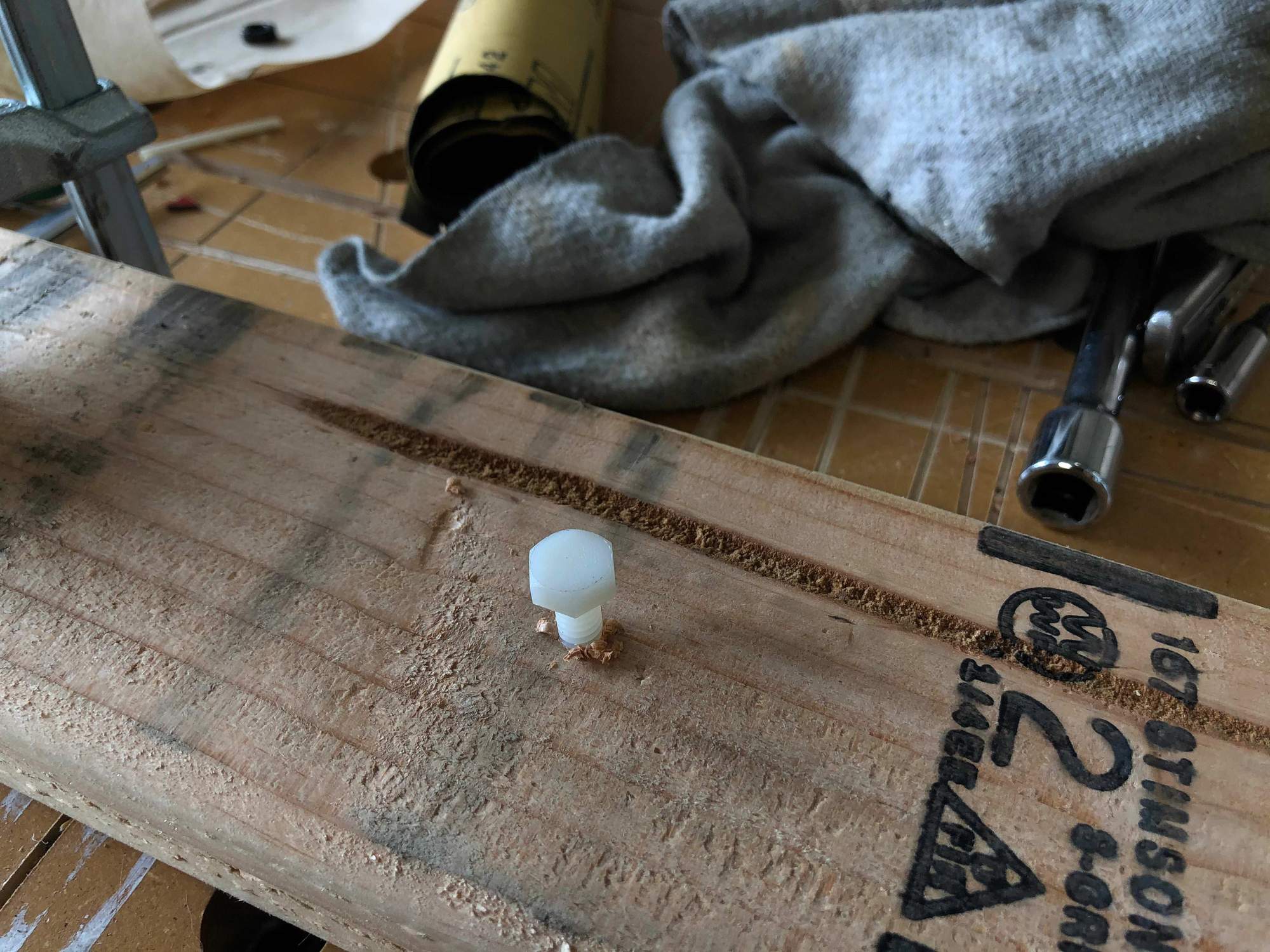

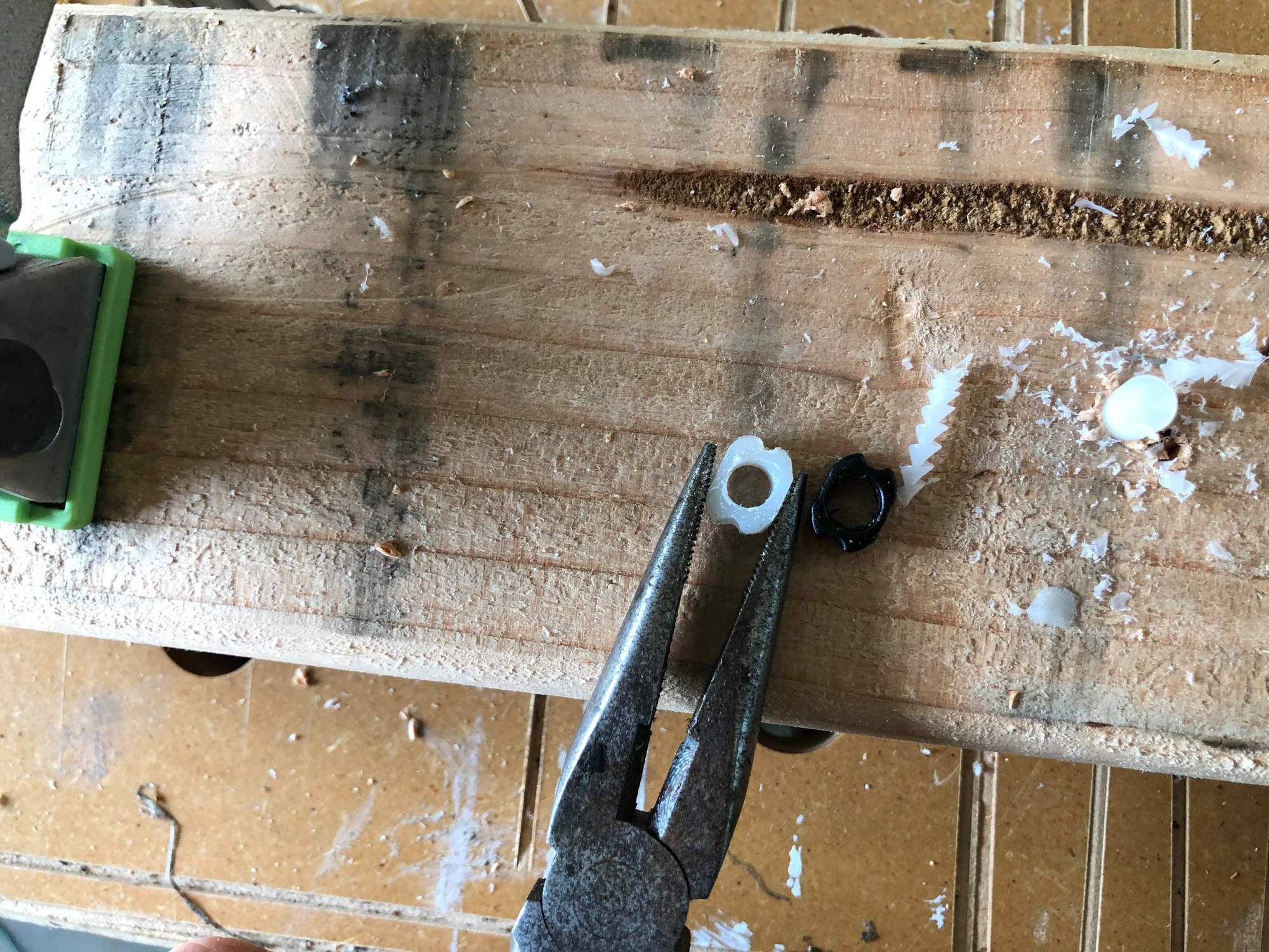

In the meantime, I fashioned four up using not a nylon nut, but bolt instead. It was way easier to work on with it screwed down into a block of wood, and the thickness was exact. The thickness of the nylon nuts at Home Depot were too think compared to the OG sunroof bushing. Installed them and the sunroofs work perfectly.
I did have to enlarge the hole a wee bit after the last photo was taken.
