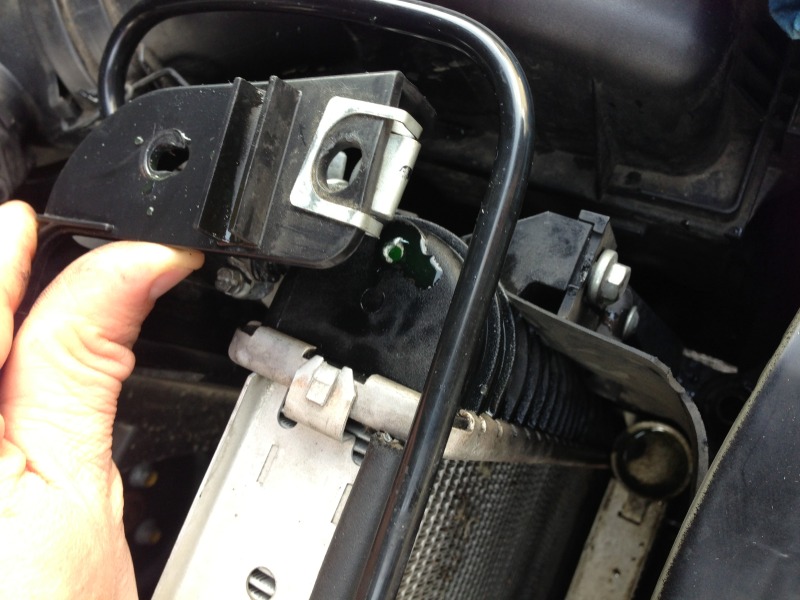

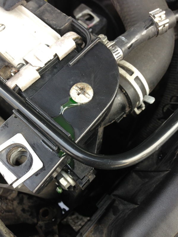

What is that about letting sleeping dogs lye? So temps were great on this truck, but figured I would be rid of Dex and fix the throttle body heater. Proper flush done and to Peak 50/50. Well I'd be damned if some preventative maint didn't once again bite me in the butt.
The day after, I noticed some coolant under the truck. I figured it might be for wining down from when I flushed it, or the overflow from the bleed screw. Nope. Today I noticed a big puddle after a drive. Dug in and sound the source. Looks like it is coming from under the plastic piece at the top. It is not the plastic overflow nipple or anything visible. I took pit the screw it was weeping from and it was flowing good out of there. Must be a crack under it somewhere, although no clue how it happened.
Would the 00 radiator fit? It looks the same, but the 04 looks to have a sensor where the 00 has a drain plug. I honestly don't have the time to do a swap right now. I know new ones are not a lot of coin, but still a pain to do. Maybe some k-seal as a band aid until I put a new rad in. Throw some in, let it get the leak, empty system and refill. Not worried about plugging. I know many who used it. Also, I would be replacing rad and stat regardless.

So can you "thread" the plastic hole, and screw in a threaded rod (short stud) with some JB Weld to act as a sealant? Maybe screw was too long to start with?
Not sure as I don't know where the actual leak is, and no way to see in. I tried a slightly bigger screw, put some thread tape in it and duct tape over the hole, but still leaked. I'm assuming even if I plugged that screw hole, it would leak inside there. I looked at an old rad I have from the last one, but can't tell if I just sealed the hole if that would work without knowing what the actual insides of the plastic piece look like.

Mine also leaked at the exact same spot. I used jb weld on it and it lasted for a couple months until I put a new radiator in.
Just pour it in the hole?

your about the 6 or 7 person who has had that exact leak posted in the last 6-months.
I would have to agree with Sav. let it cool tap the hole and insert a plastic screw with JB Weld and let it set.
