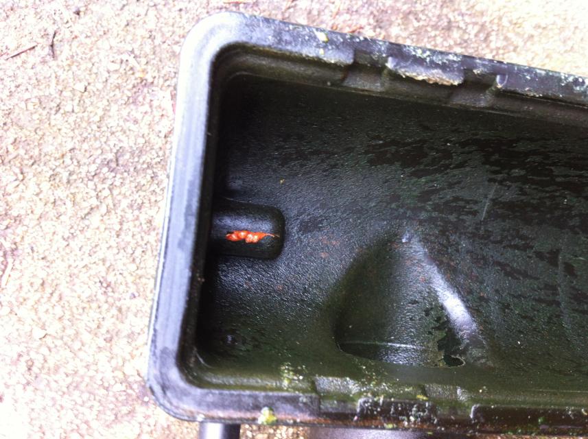

Hope the K-seal keeps working. My only concern would be the changing dimensions of the plastic during heating and cooling. A flxible sealer like RTV would be better in that situation. I had the same leak and I just pulled the screw, dried up the hole as best I could, pumped in some RTV, inserted the screw and that was it. I replaced the radiator a week or two later and when I pulled the tank I found this:

For plan C I could throw some in there if needed. Without knowing what the size of the hole was I was worried about dropping in a bunch of it. Hopefully I will just be able to swap it out soon anyway.

I had exaçt same issue... Coming out of a local store i saw the puddle... I was inside for about 1.5 hrs so truck was pretty cool and i only have about a block to get home and i have an onboard computer ( ultra-gauge) so i knew exact temps... I risked it and made it home before truck heated up... Anyway, i dried and cleaned off that area and used a fibergalss radator epoxy patch kit and it worked... For about 6 months lol anyway.. New radiator and water pump go in monday! ( water pump only because its preventative but may have a little leak behind it on gasket... Im not running hot but hotter than i think is normal... Also adding new hoses and lower temp thermostat
