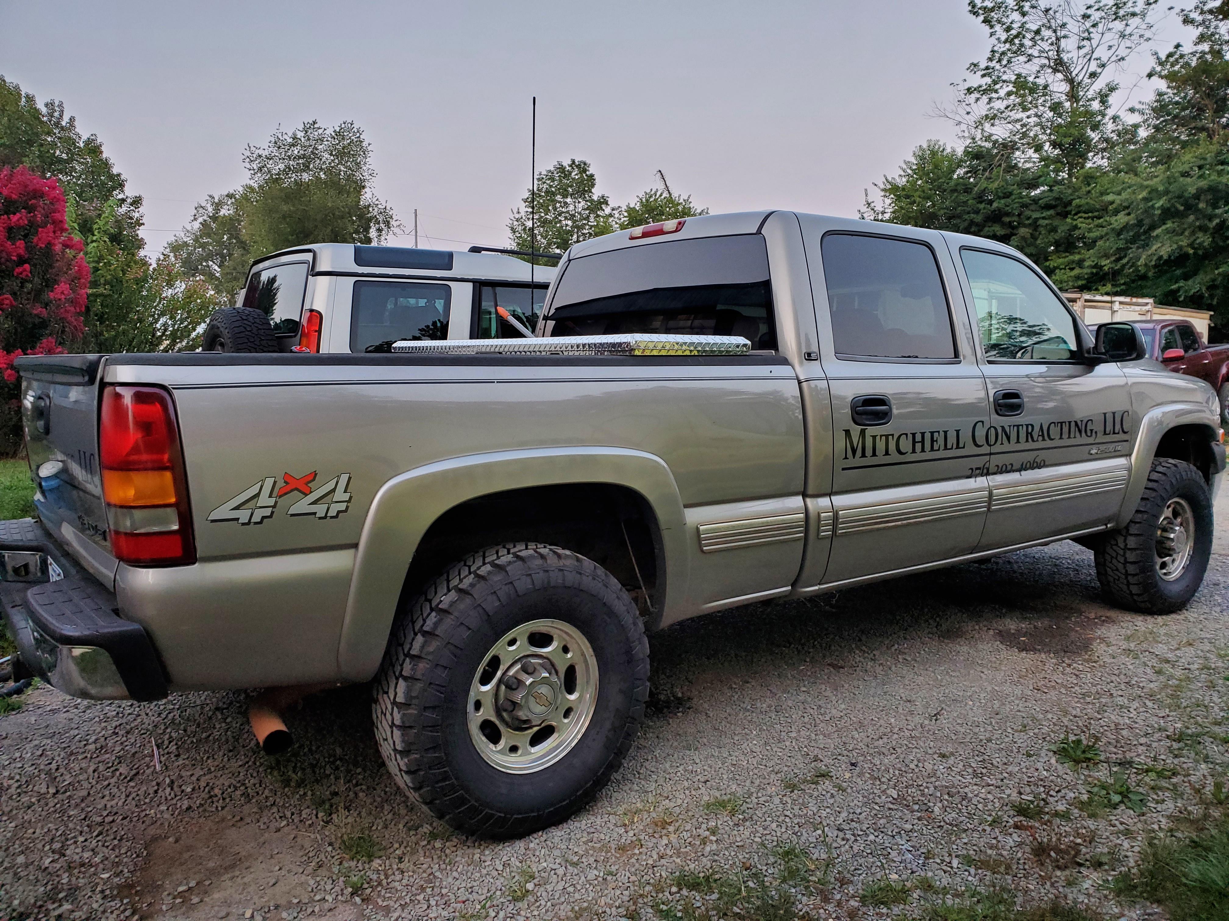

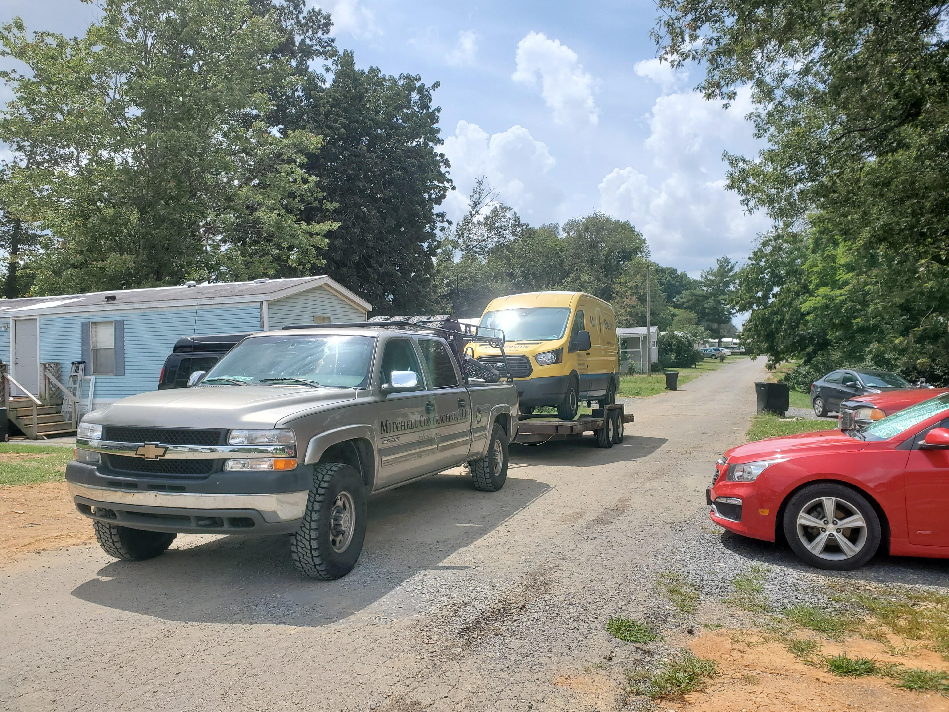

2500, here's a couple shots of it. I intend to run the same tire in a 315/75r16 (35") on my Tahoe/Family Hauler when I SAS it. You may notice a small loss in ride quality, the additional sidewall height may make up for it and you never notice it. Myself, I run E rated tires on almost everything.

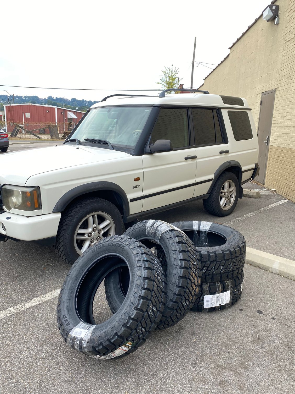

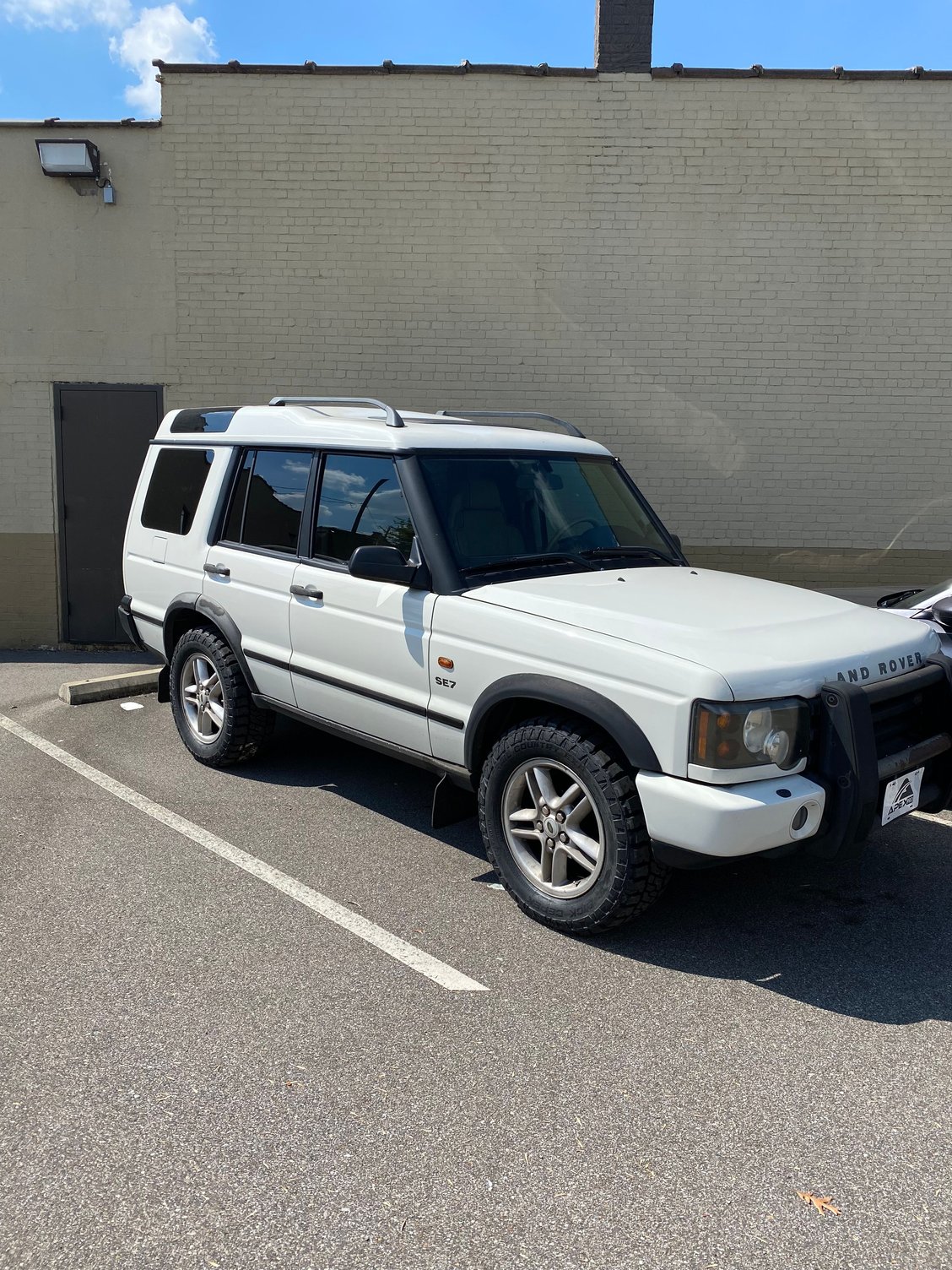

I ordered some of the Dick Cepek’s, they should be in tomorrow. I’ll post pictures here, excited to see how they look!

I’ll post pictures once they’re mounted tomorrow
