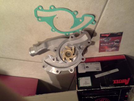

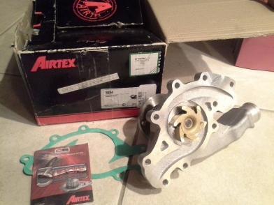

I was going to reuse my water pump, but there is a some movement in the bearings. I found what appears to be a Airtex Spain 1694. Its casting looks identical to the LR pump, but the part no. is W0133-1610251. Here is the same p/n shown with a brass impeller http://m.autopartswarehouse.com/sku/...3-1610251.html.
Amazon Warehouse had one with 1% cosmetic damage for $40. it should be delivered Thursday. Hopefully it will have a brass impeller.
They do have one more for sale with 10% cosmetic damage.
Amazon.com: Airtex Water Pump - w/ Gasket: Automotive Amazon.com: Airtex Water Pump - w/ Gasket: Automotive

the real advantage to the airtex is not so much the bronze impeller that for some reason everyone thinks makes a difference somehow. but if i remember correctly it uses needle bearing rather than ball bearings.
Old Jul 30, 2014 | 08:31 AM
RicketyTick's Avatar
Joined: Feb 2014
Posts: 1,125
Likes: 24
If I remember correctly, and I could be wrong about this, their are two different grade Airtex water pumps for these trucks.
The premium grade would have the brass impeller and probably the needle bearings that drowssap mentioned above and the other would probably have neither. That's just a guess based on the big price difference.
The one in the amazon picture that you linked to looks like the good one.
Good deal...let us know how you make out with that.

Airtex Spain 1694 and the Airtex (US) AW9369. The 1694 is the LR pump.
A while ago I emailed Airtex and this is the response that I got "We produce this pump in Spain for LR Service and our Airtex Spain ref. is the 1694,"
The pump from Amazon should be delivered today. I will let you know which one it is.

<p>The water pump was delivered today. It is the Airtex Spain 1694. It even has a STC4378 sticker on the box. It was a return, it had the original purchasers paperwork in it. He returned it because the box had no packing in it and the pump poked holes in the box damaging the pump. There were no holes through the box and I couldn't find any damage on the pump.</p>
