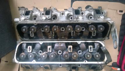

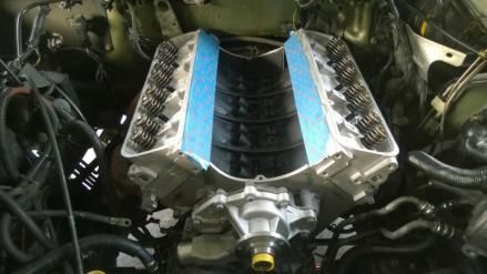

Before and after photos of the heads.
Attached Thumbnails Taking heads off this weekend, exhaust manifold bolt concerns-forumrunner_20140820_231839.jpg   Taking heads off this weekend, exhaust manifold bolt concerns-forumrunner_20140820_231857.jpg
