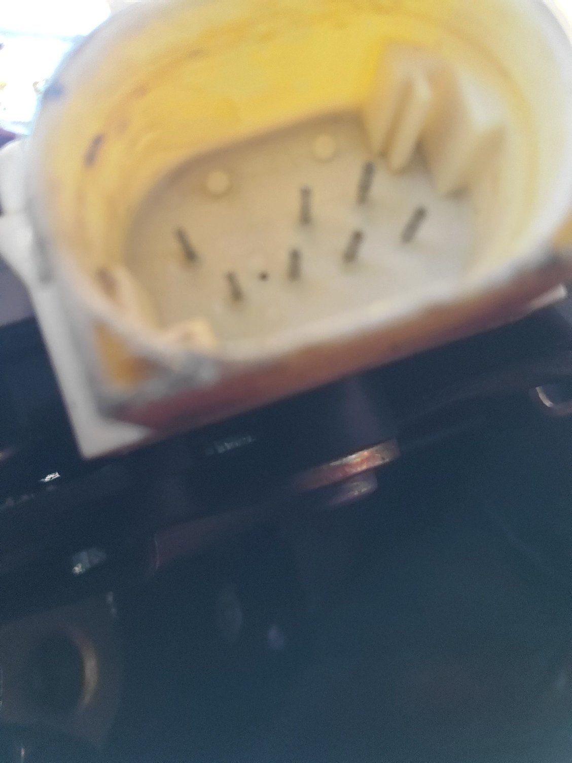

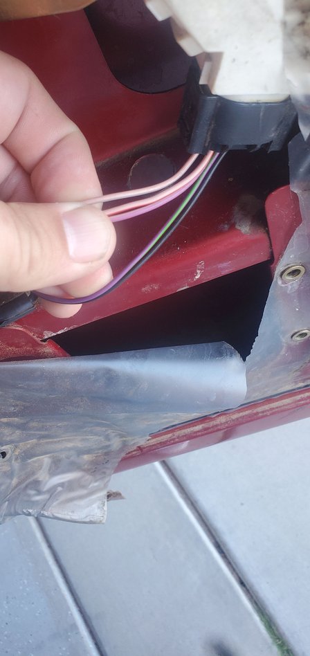

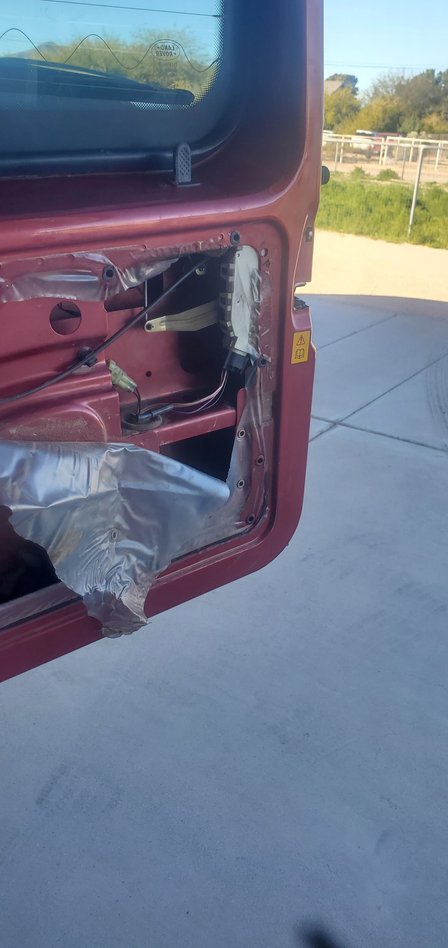

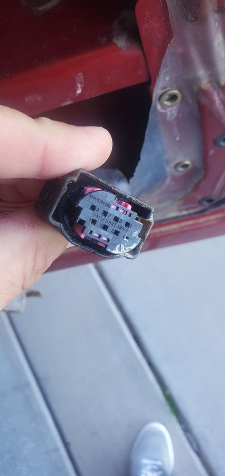

This is the rear trunk door and I am attaching multiple pictures showing the wire, the wiring harness and the lock actuator in question - thanks
Location - rear door
5 wires
7 pin actuator
8 pin plug

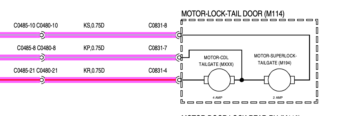

Well crap, I posted the wrong part of the wiring diagram -- sorry (that was an upstream connector... I was incorrect) -- here is the connector C0831 from the electrical library
I'd say you have to test the wiring to make sure it's getting voltage, the ground (more likely since it will neither lock or unlock), or have a bad actuator.
Any tail door actuator 99-04 will interchange.
