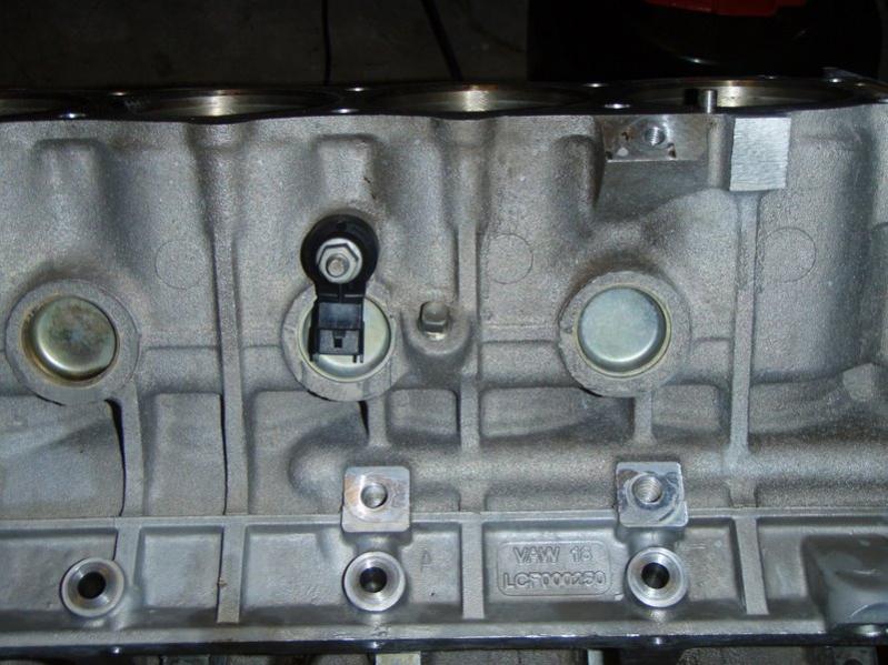

Knock sensor: there is one on each side of the engine block. As the name suggests it detects engine knock or pre ignition or detonation or pinging. Check the wire going to the knock sensor, mine was damaged by the PO when they did a head gasket job. The knock sensor is the black plastic part in the photo.
