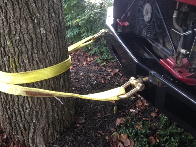

Thanks again Tom. I'm loathing the idea of taking the bumper off again but I really have little choice I suppose. I'm not even sure how I can get it off now given the hammer-and-block-of-wood persuasion I've used to get it on this far. I may need to wrap my tree strap around a tree and then slide my old log chain through the loops and connect each end of it to each of the two newly-installed swivel eyes, then back up slowly until it is pulled off the frame and drops to the ground.

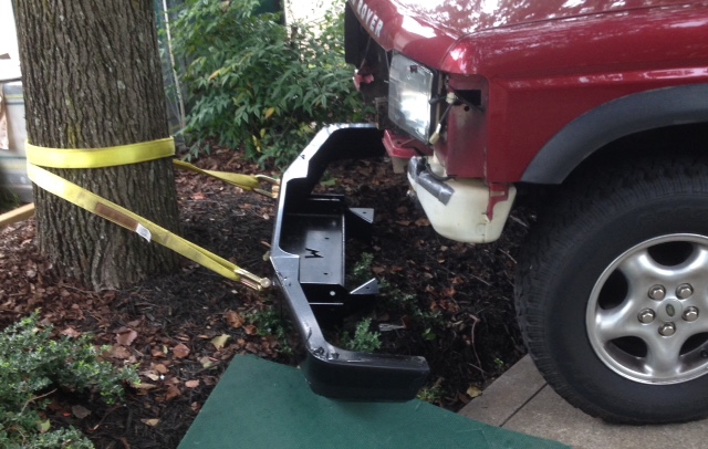

Well, the bumper is off the truck again. I love innovating.

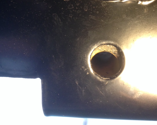

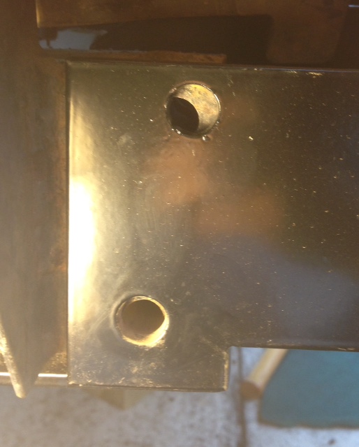

The first pic, TF22, shows the Terrafirma mounting holes from the RH, passenger-side view (U.S.-centric of course). You can see that the lower hole is lined up pretty well (bumper needs to move down a 16th or so perhaps) but that the upper hole needs to move both back (i.e. left in the pic) and down maybe an 1/8th or so, maybe 3/16ths. The next two pics, taken from the opposite or inner side of the RH farme horn, show roughly the same moves needed to reach The Promised Land. Thats’s good news; I’d been concerned (still am a little) that the holes in the bumper were misaligned even with respect to each other and would never line up with the holes in the frame horn. The circumstances on the other side of the truck are quite similar.
Tom wrote about scribing marks to help identify where the hangups are but I think these pics should help a lot to provide the same guidance.

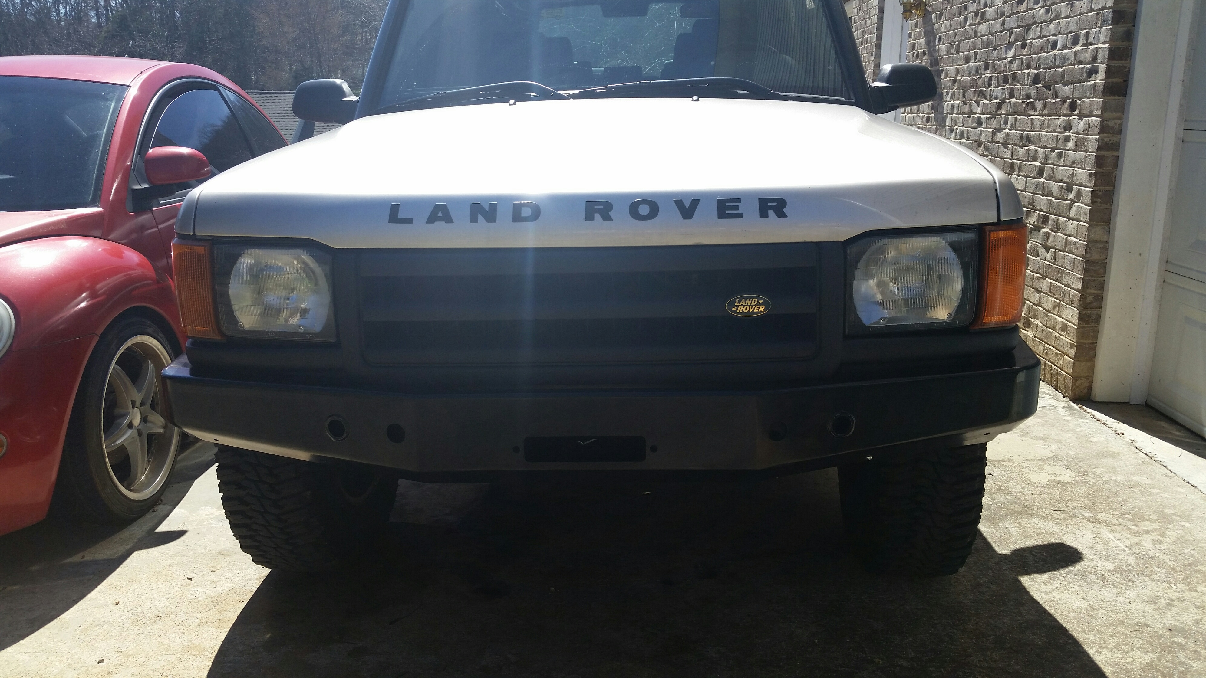

I purchased this same bumper. I had somewhat of an issue mounting it as well. I haven't mounted a winch on it as of yet but I did see on this forum or another LR forum that the metal strip u spoke of would need to go for a winch to be installed, I also had to trim my grill about a 1/2 inch, will be even more when the winch goes in. as for the holes not lining up, I used the method described in said post that showed the metal strip being cut out. 1 bolt hole on the passenger side needed to go back bout a 1/16th or so to let the bolt slide in, after reading this thread the grinding method would have been better, but I went with what worked for the guy who posted his install which is find a tree and give it a push. probably a dumb idea but hey it worked, especially after an hour or so balancing the damn thing on a floor jack trying to get it to go. I also wrecked a few 2x4's beating the **** out of it before going with the tree. I also had some issues with the washer bottle guard lining up. I've since deleted the install pics, all that's left are a few of it on with the grill trimmed. but where you have a winch much more trimming will be needed. here's one with it on though.

A grinder isn't going to help the bolt hole alignment as much as is needed. If the bumper just needed to be rotated up or down, pivoting on the lower hole, then yeah, it would.
In TF22 if you pivot on the lower hole it will correct the horizontal alignment but will make the vertical alignment worse as the upper hole will move up.
It looks to me like either your chassis horns are tweaked or the bracket holes were drilled or punched wrong.
Be careful grinding the welds. Take off as little as possible because what you're grinding off is the weld reinforcement.
