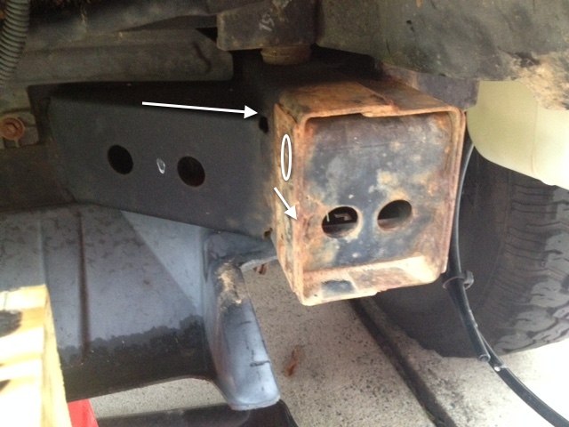

I've been trying to figure out how to put together labeled pictures to show why my initial problems with mounting it could not be related to any frame tweaking or frame alignment problems from the accident. But not only have I not yet figured that out but at this point I'm exhausted from the process and haven't had the energy to do so. Plus I have other things in my life that need attention too.
But here we go. The attached picture is the best I have to try to illustrate the problem. The biggest problem was the vertical distance between the top of the diagonal and the top of the mounting holes. Even a frame "tweak" that misaligned the frame horns wouldn't have changed that without some obvious damage to the welds. The same goes for the horizontal distance between the vertical weld that joins the diagonal to the frame horn and the mounting holes.

Its boxed and gusseted, its not going to bend there. My frame is tweaked slightly where the pan hard rod connects to the frame from someone hitting the passenger wheel (I guess) before I owned it. That front section is so strong the stock front bumper slid on and off with no problem even with the tweak.

It would be hard for this alignment to be from a chassis problem unless the side rail was crushed top to bottom at the front
That doesn't mean that other issues might not be from a chassis tweak, but that isn't.

I would have to agree, once pix were posted it was pretty hard to see that lining up.
Holy crap. That's not a chassis problem, that's a QA problem.
As in, do they even have a QA process?
