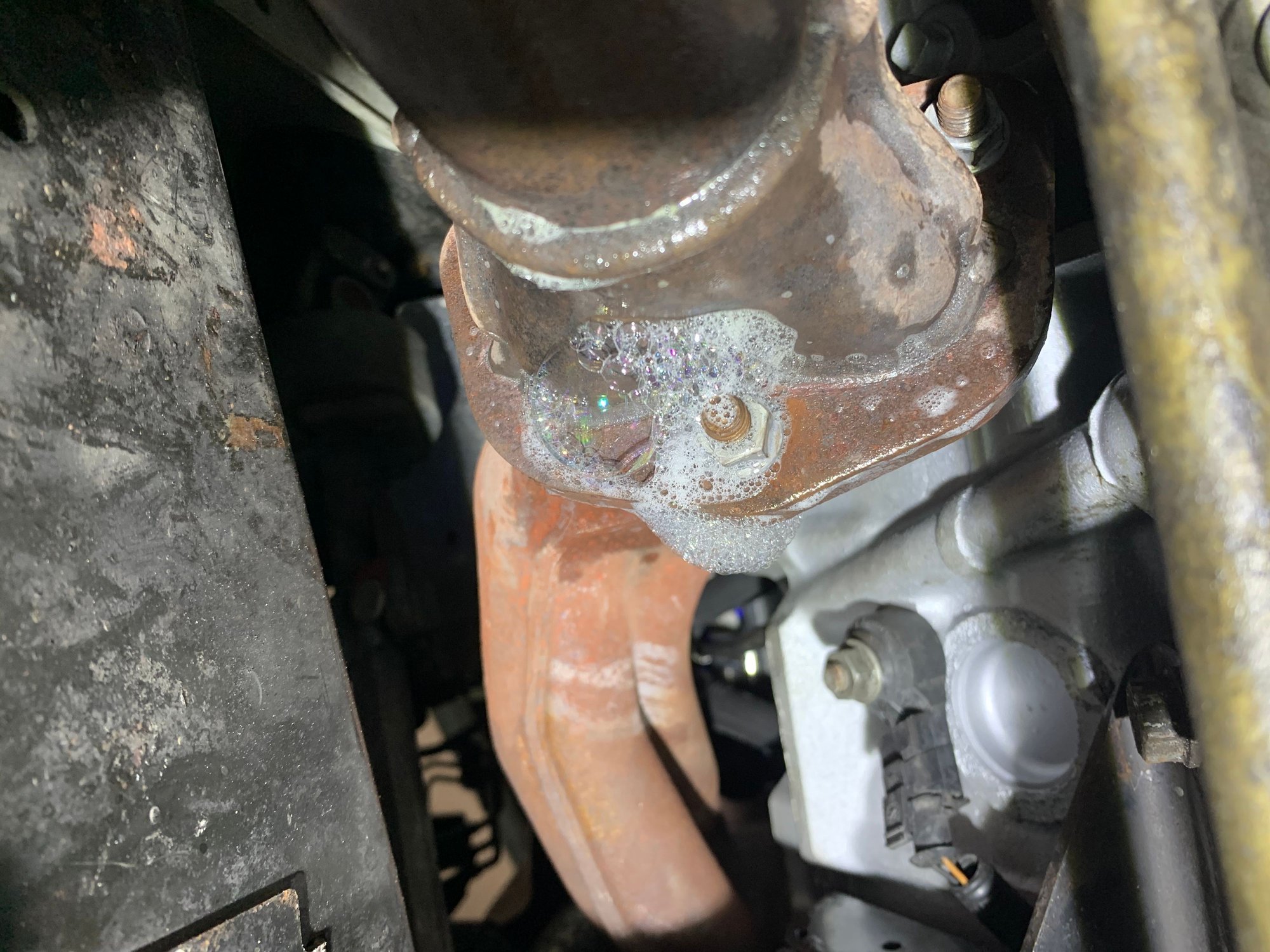

Testing for exhaust leaks with smoke tester.

With my shop vac and tail pipe no duct tape was needed. The shop vac hose fit snugly enough inside the tailpipe.

maybe I'm the only one with a bashed in tailpipe? lol I would certainly need tape. I need to weld a new tip on as well....also should check for where my leaks are..some good simple ideas here.

@Jason_B I did this with a leaf blower and sprayed down the entire exhaust and SAI. It was no problem except I had to come back and do a second round a week later.
