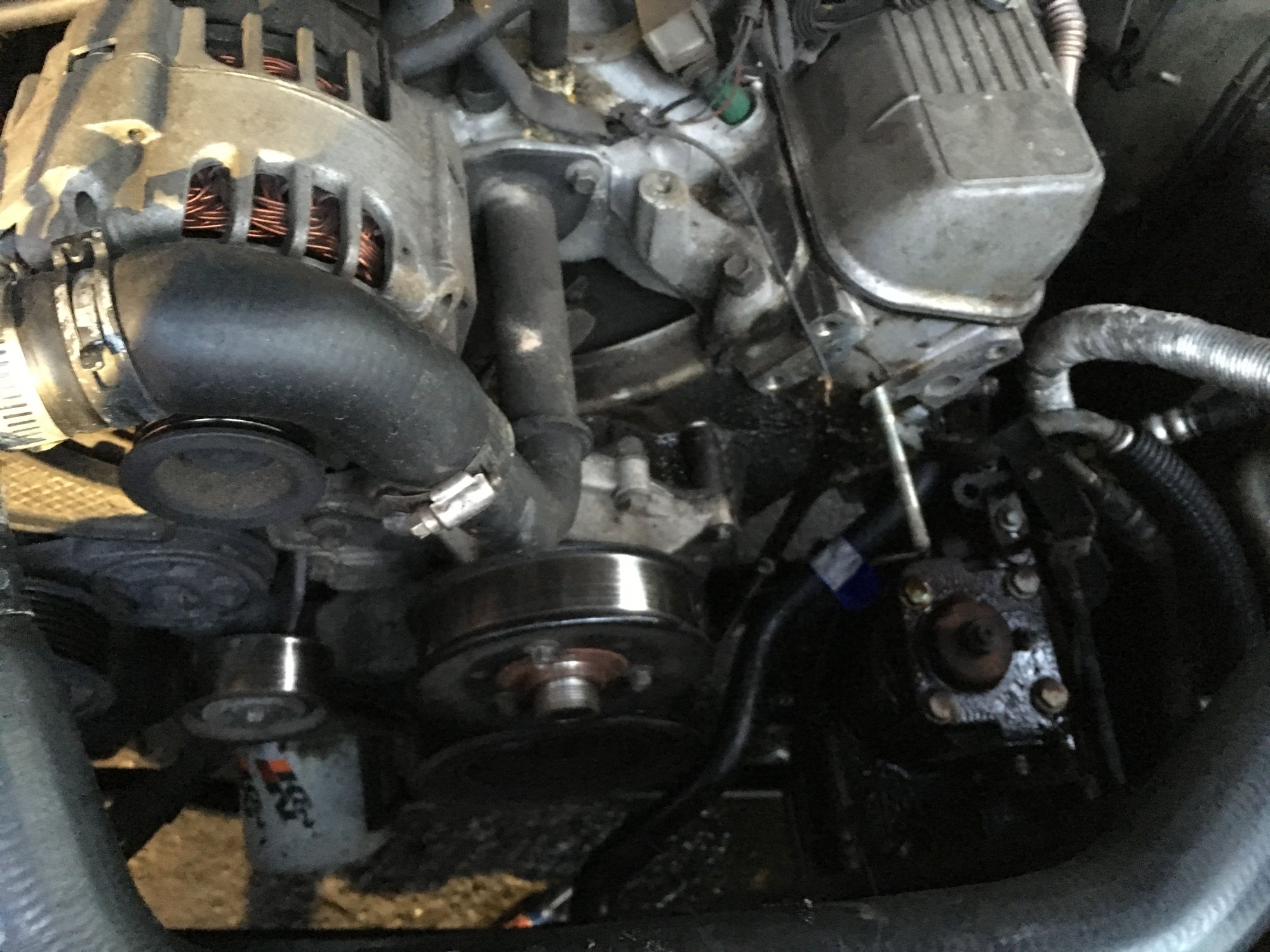

Originally Posted by LR03NJ
Why is the other coolant passage blocked or built closed off? Is this normal?
The heads are designed to be interchangeable so they can be used on either side. That means that they need to have all the water and oil galleries open that could need to be open regardless of which direction things are flowing in. (If you took a head from the left side and used it on the right, you would rotate it through 180 degrees so that what used to be the "exit end" for coolant flow, for example, would now be the "inlet end.")
But the block is designed to restrict or direct the flow as needed. The place where you see it blocked off in your photo has a small hole rather than a full open gallery. That's done on purpose to control the flow of coolant. Nothing is wrong there!
That was the question in my mind. Why? Since these trucks are relatively hot, why not make that passage the size of the other one? Anyway, just a thought. thank you. Can you drill a larger hole on that side? HEHEHEHE!

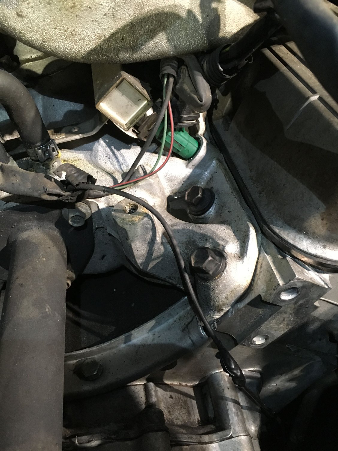

Just to add to what I found with the pevious HG job. I found a black stranded wire coming from the top of the manifold leading all the way to the bottom of the truck. It got pinned and cut between the ac compressor mount.

Default Pictures of the wire
Here are the photo of the wire that was disconnected. What is this wire for? It was not connected for a long time.

Hard to say what that might be for. There are so many wires and sensors on these things that it could be anything from an unused ACE ram to a critical emissions component.

Knock sensor?

Looks like a knock sensor to me too. It is a coax type cable that has splices with electrical tape at the end, Inside the casing. Absurd.
Should go down to the sensor under/inside the motor mount.
