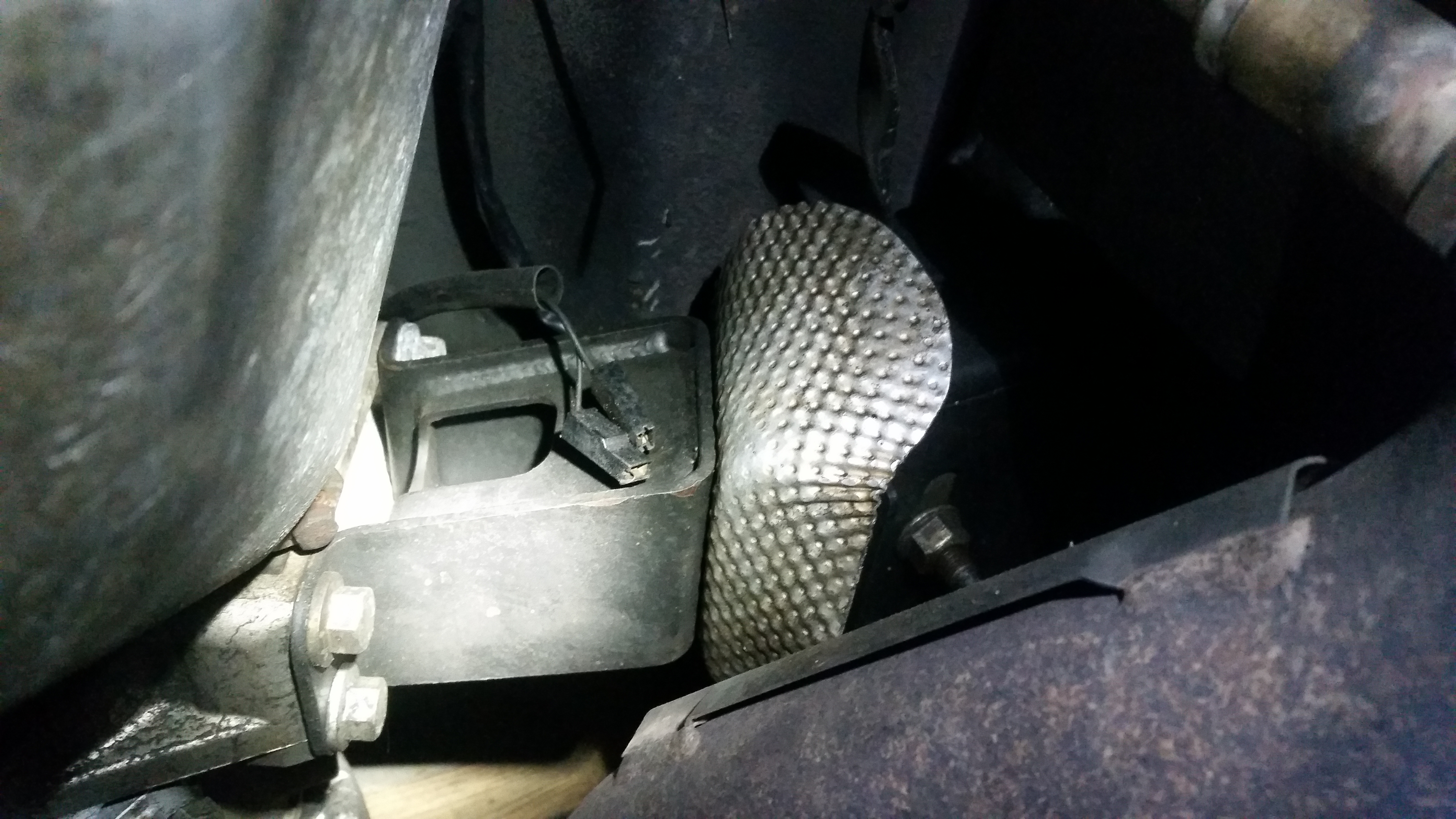

Question Are these wires why my truck throwing codes?
I was underneath the rig to change out my O2 sensor and noticed these 2 wires sitting there. I had to drop the trans mission a few years ago to replace the flex plate between the trans and engine. I apparently didn't reconnect these 2 wires... The truck has been throwing P0741 Powertrain Torque Converter Cluthc Circuit Performance or Stuck Off...
Where do they go?? this is on the drivers side of the transmission near the Bank 1 Sensor 2...
Thanks!

Question Black/Green and Solid Black
One of the wires is Black with green stripe and the other is solid black... Is there a wiring diagram to help me with these 2??

I know I have seen one or two sets of plugs like those that plug directly into exposed 'blade' male connectors, either on top of the transmission or transfer case. If you don't have the center console pulled out, you'll have to dig around the RAVE for a diagram of the transmission / transfer case or just feel around blindly for a while. I know the ones I saw can be reached from below because I unplugged mine and plugged them back in while fiddling around.

This might help: https://discoii.files.wordpress.com/...al-library.pdf

they plug to the sensor on top of the front output of the transfer case. My center console is out and ill get you a picture

Which side do I reach up to find the place to plug them in?? can it be seen from below or just felt?
