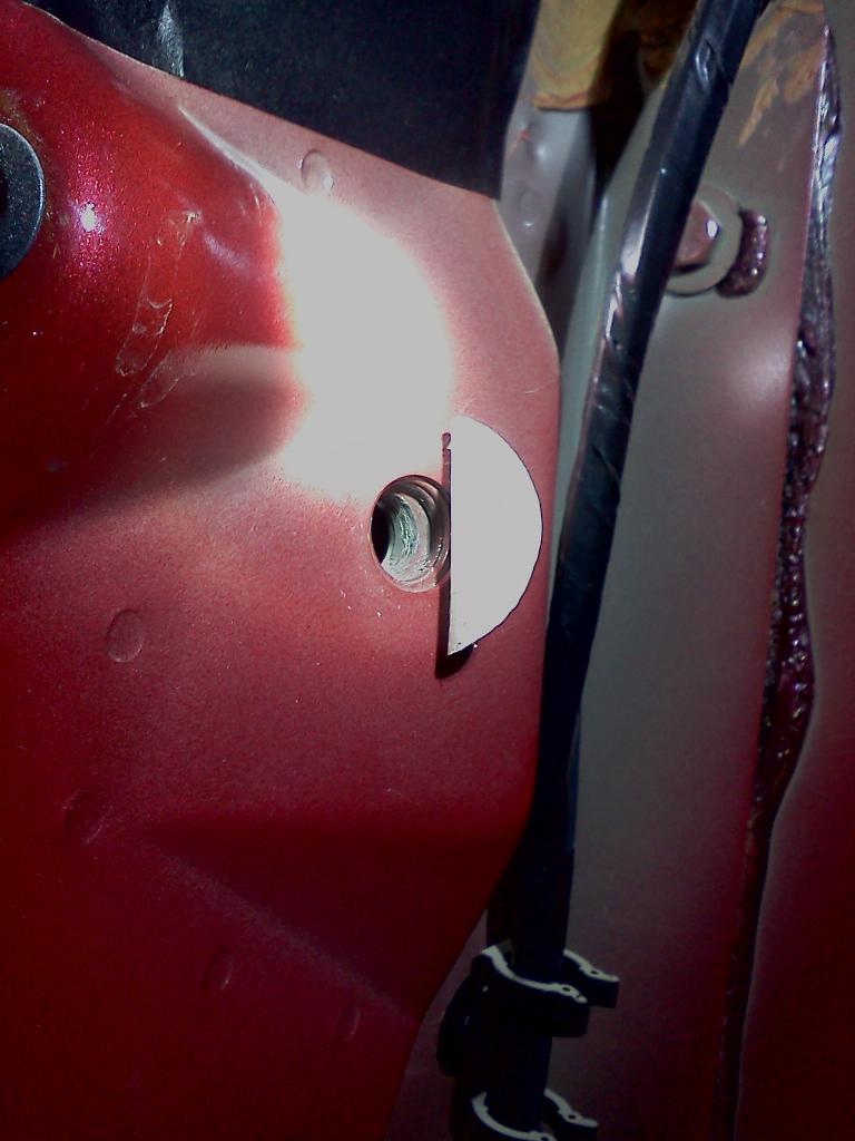

So all the legal stuff aside, if someone that has done this before could could give me some advice I'd appreciate it, as I've just picked up a complete set of third row seats and bits but I'm stuck on the seatbelts.
The top mount for the seatbelt is (I think) where the arrow points, but as you can see there is no thread in it... Is this normal?
And the bottom mount for the seatbelt seems to be missing a bracket. I'm going to contact the guy I got them from to see if there was a bracket there, or if I need to fab something up.
I'll take some more photos as I go since I couldn't find any photos anywhere to help with this (although most of it seems relatively straight forward).
Cheers in advance
Steve
