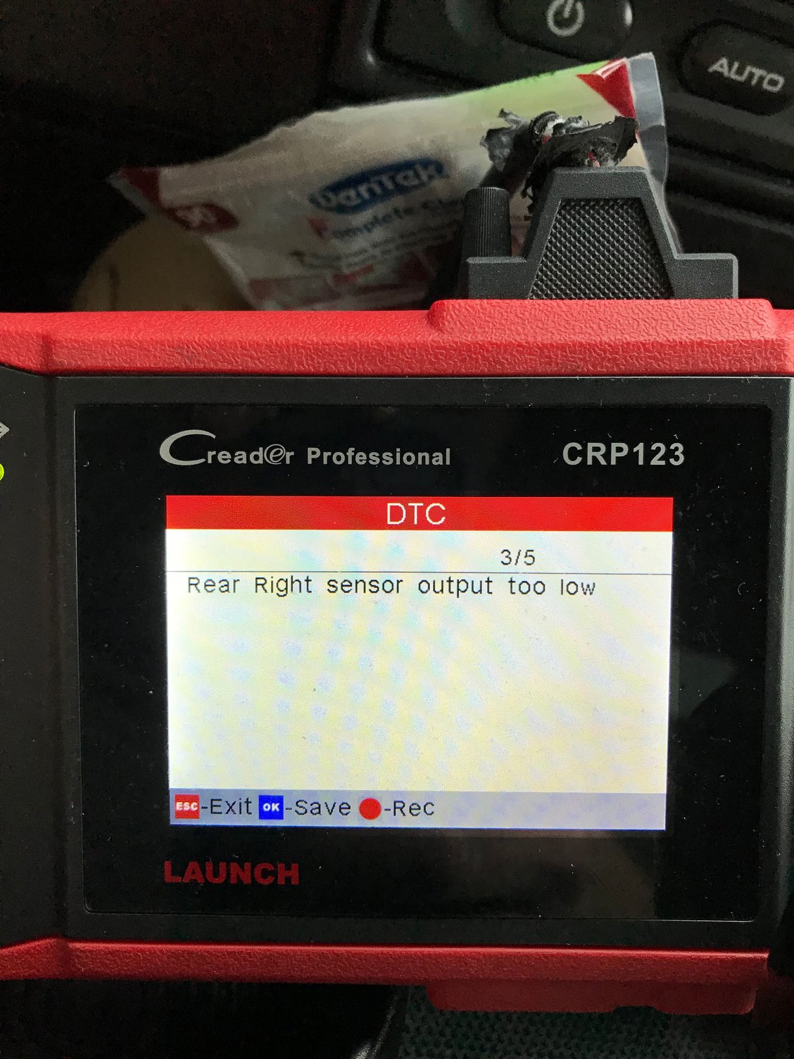

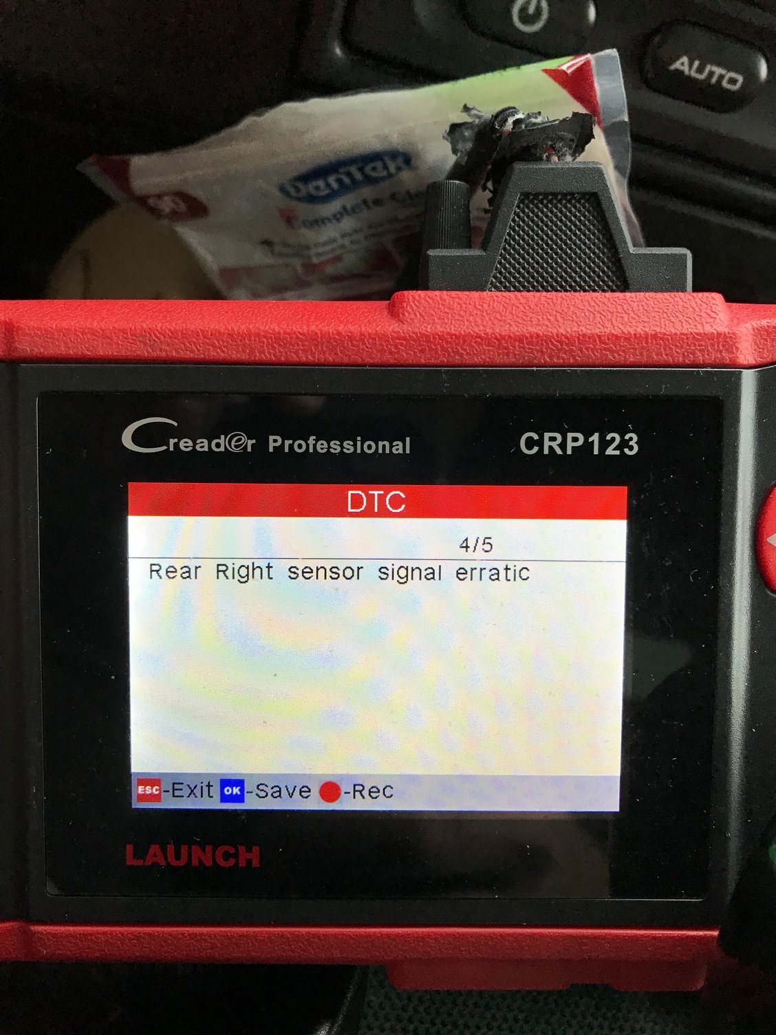

I’ve been diagnosing according to Land Rover Troubleshooting - Test Procedure And Instructions for Shuttle Valve Switches
and have found no electrical faults so far...
Here are my scanner screen shots:

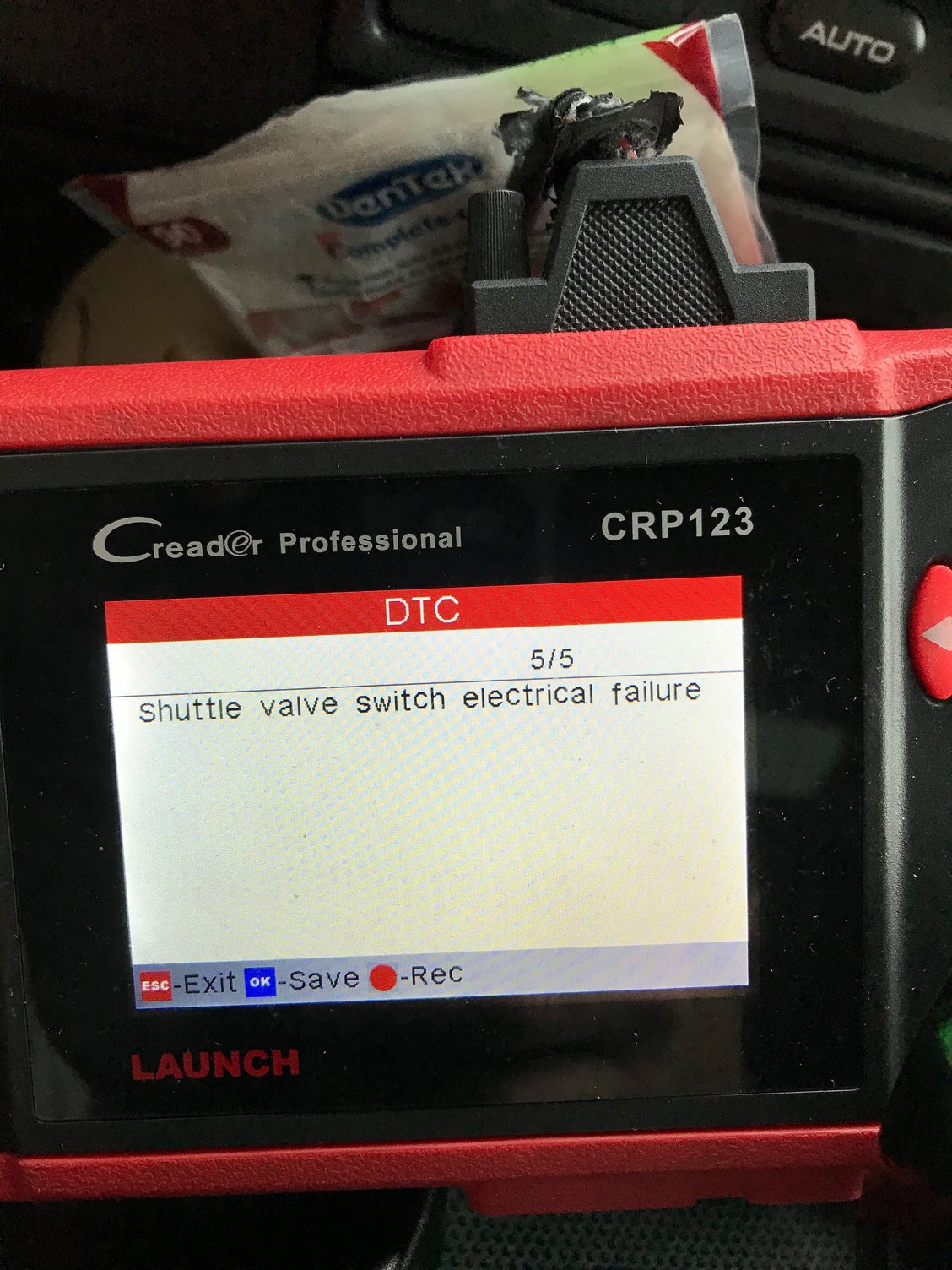

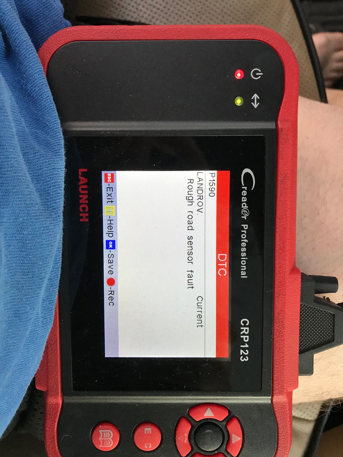

Then after all the continuity tests showing good, I got this fault:
Any ideas?

The right rear sensor itself looks good btw. I didn’t check it’s continuity though

Perform Option B to bypass the weak link inside the Wabco unit. The internal connector that the shuttle valve switches plug into is a common weak link. If you bypass the internal connector with Option B using a nice external connector (looks similar to a 4 wire trailer plug but it's just 2 wires) you cut the yellow/green striped wire back about 4-6 inches from the original plug, tap one side of the new 2 wire connector to the yellow/green wire going back into the cabin/SLABS unit (do not splice into the yellow/green striped wire heading to the Wabco Unit/Plug), and then you take the remaining wire and ground it (HVAC line tie down bolt is a good ground right by the Wabco unit), then at the Shuttle Valve switch side you chop off the connector and splice in the other side of the new 2 wire connector and BINGO job done and you've successfully bypassed the weak internal connection inside the Wabco Unit.
P1590 is a generic ABS fault code and it's triggered whenever there is an actual stored ABS fault (AKA 3 amigo's/3 musketeer's). I'd inspect the ABS sensors at the connectors, and make sure the Allen bolts that secure them are tight and that none of the internal o-rings are floating around in pieces inside the ABS sensor hole causing bad readings.
You can meter out the original shuttle valve switches and use them, but at $45-55.00 it's a cheap part to replace and be done with any Wabco Unit related failures for a long long time.

Just to update for others researching etc:
after i cleared codes on the day of the original post;
“SVS electrical failure” recoded. So will be doing the Option B repair and will post results
