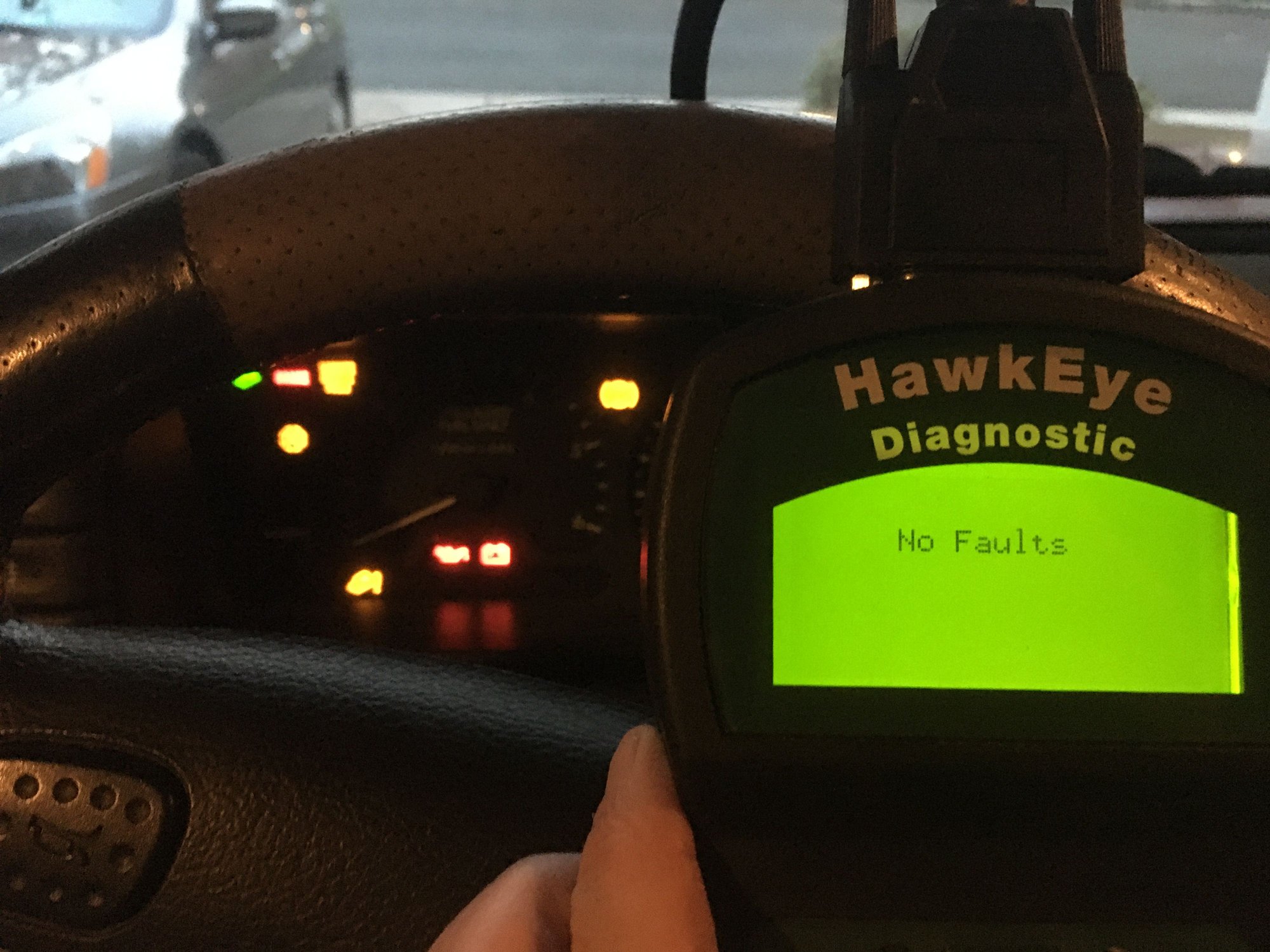

Here's a new one, I think. After a couple Amigo-free days after I replaced the left front wheel speed sensor (more on that to come in another post), the Boys from South of the Border made an appearance late yesterday as I neared home after a short trip. As soon as I got home I plugged in the Hawkeye and was surprised that the ABS DTC reading was "No Faults." Huh?
So I next plugged in the ABS Amigo, and when I connected it into my laptop I found the same answer - "Active Faults: None Logged Faults: None."
I checked the calendar and it was not April Fools Day. Maybe it's just a fluke. Weird. Have any of you seen this happen?

I have had the same twice, in my case it was related to a very rough steep downhill and trying hill descent. I think the system got confused. Foxwell cleared it without issue, but the same no codes I did a clear code just to be safe and all was good

My 04 was going Amigo crazy, tracked it down to a loose ground for the Option B mod. Tightened it up & mystery Amigo's took a hike.
