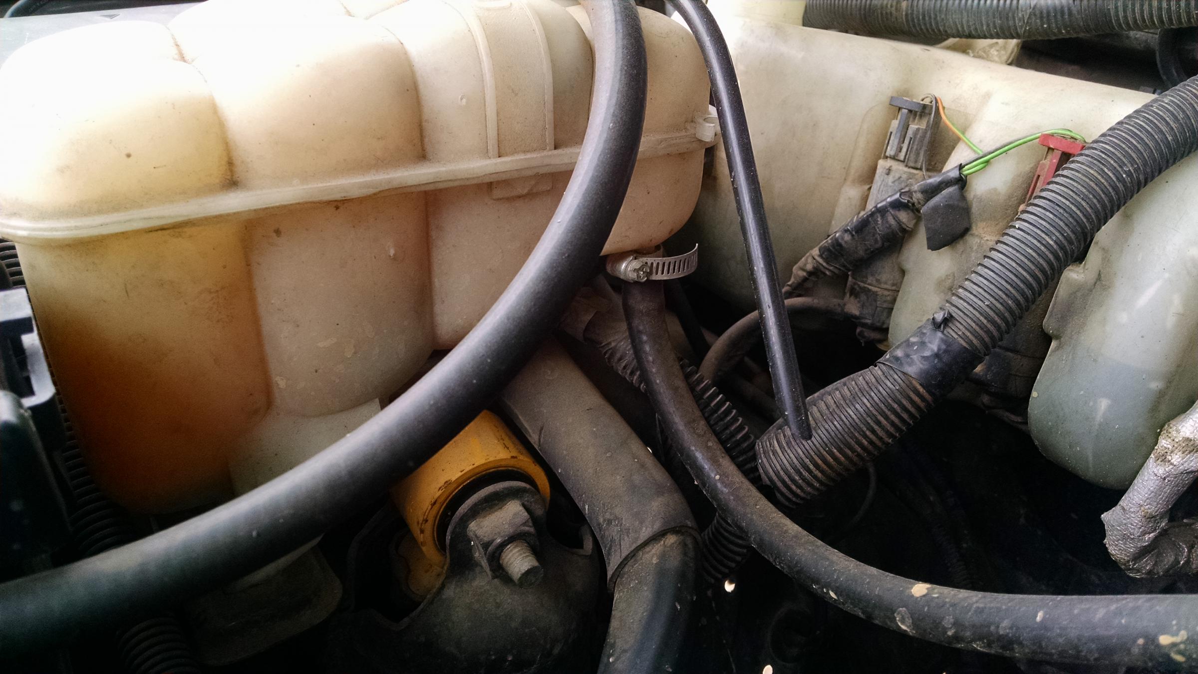

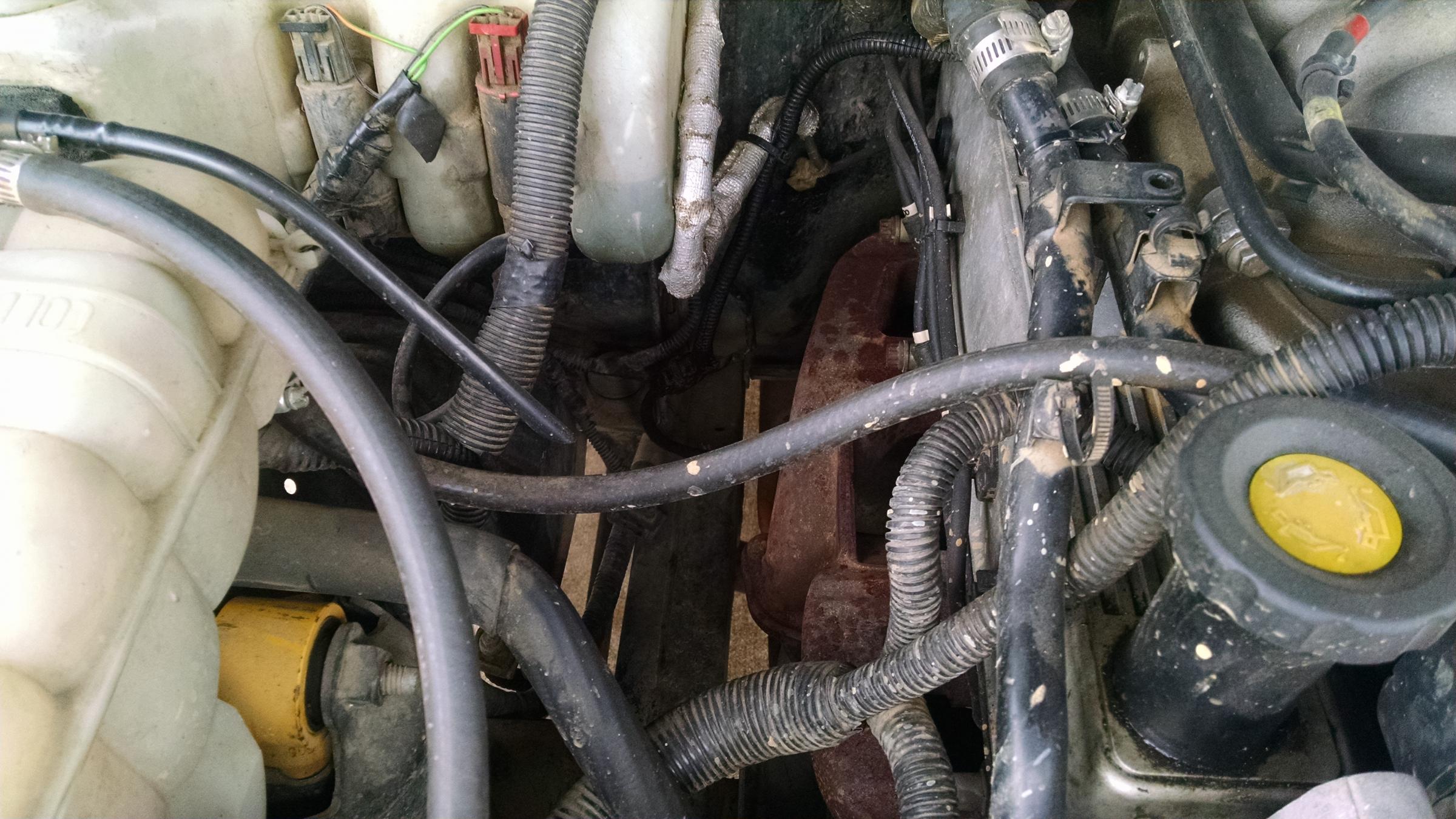

5/16 heater hose, measurer then get a foot extra that what you need. Got to watch your bends, don't kink the hose. I can't remember exactly how much I used. I'll pose a photo. You will also need 2 new hose clamps if you don't have some laying around

Here are some photos of mine.

You don't even need to connect the two loose ends. You can just stick a properly sized 1" bolt into the end of each hose and plug them. The coolant does not need to flow through the hoses.

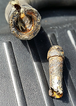

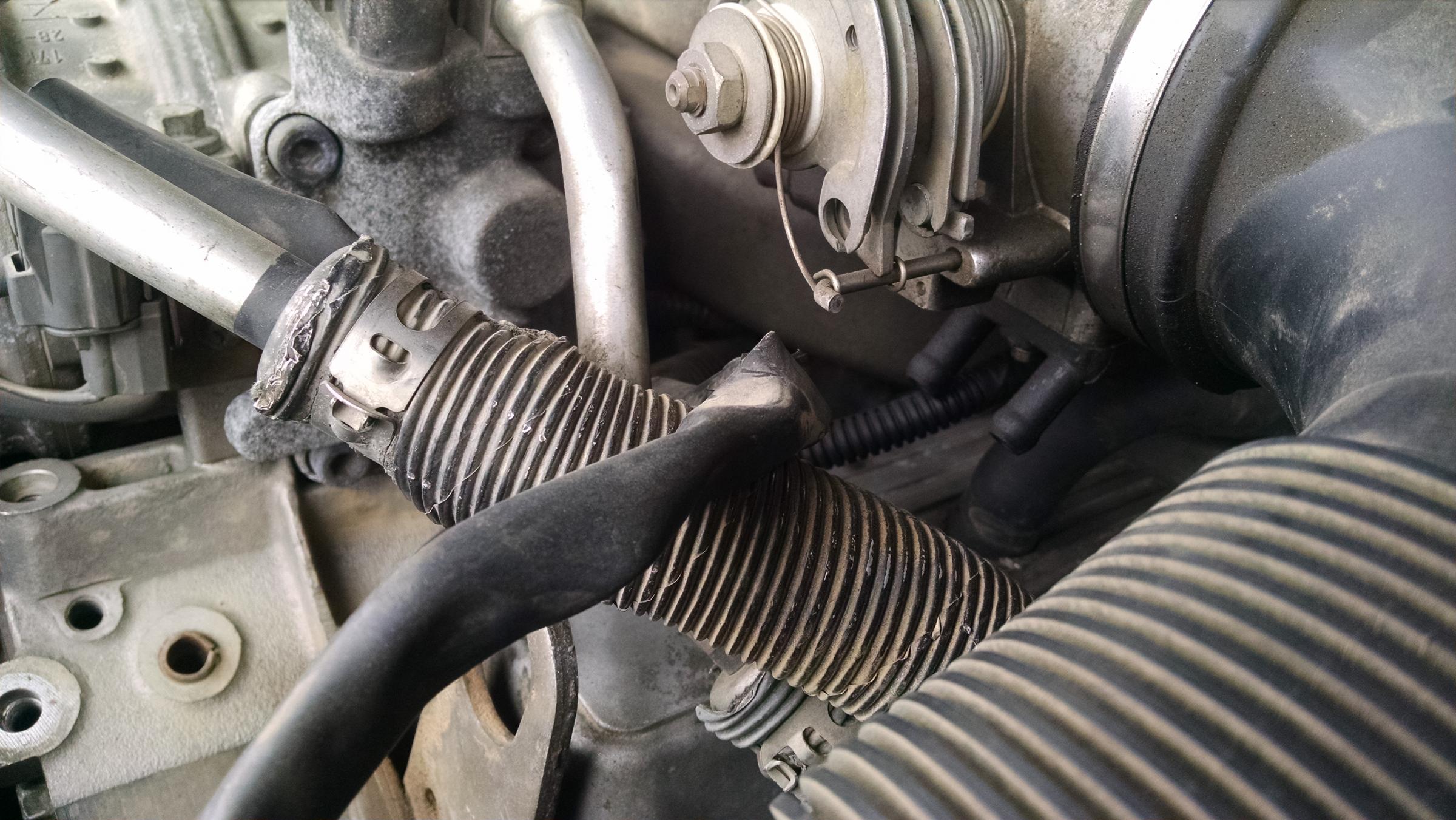

Thank you all for your feedback! ...unfortunately things have gone south for me, or so I think!
Finally found the time this morning to put and end to this bypass issue, but when loosing the clamp that holds the hose coming into the upper intake, the tube where the hose fits, broke off! ...yes, I had seen some moisture around it before, but thought that once replacing the hose and the clamp that prob would go away. I'm assuming age and "water" (not coolant) did its work on that little "metal" tube... it was badly corroded and stuck to the hose; once in my hand, had to cut the hose to get to the tube... the tube is so corroded that is very thing and with cracks and holes, so I guess it was just a matter of time before it made my life more miserable on the side of a road... at least the Disco is well parked in front of the house now!
So now one prob solving has led to another, and I'm looking for ways to solve it, so new feedback will again be very much appreciated!
I'm attaching photos "after the fact" ;-{#

now that is real crappy luck..........
replacement intake manifold is in your future, unless you wanna really try to shade tree this.
either you replace the intake or drill that wonderful corroded tube out, tap it and put a bolt in its place, but that comes at the risk of having a bunch of metal particles floating around your cooling system.
me personally, i'd just replace the damm thing.
