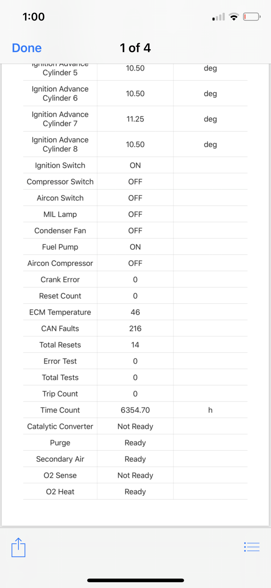

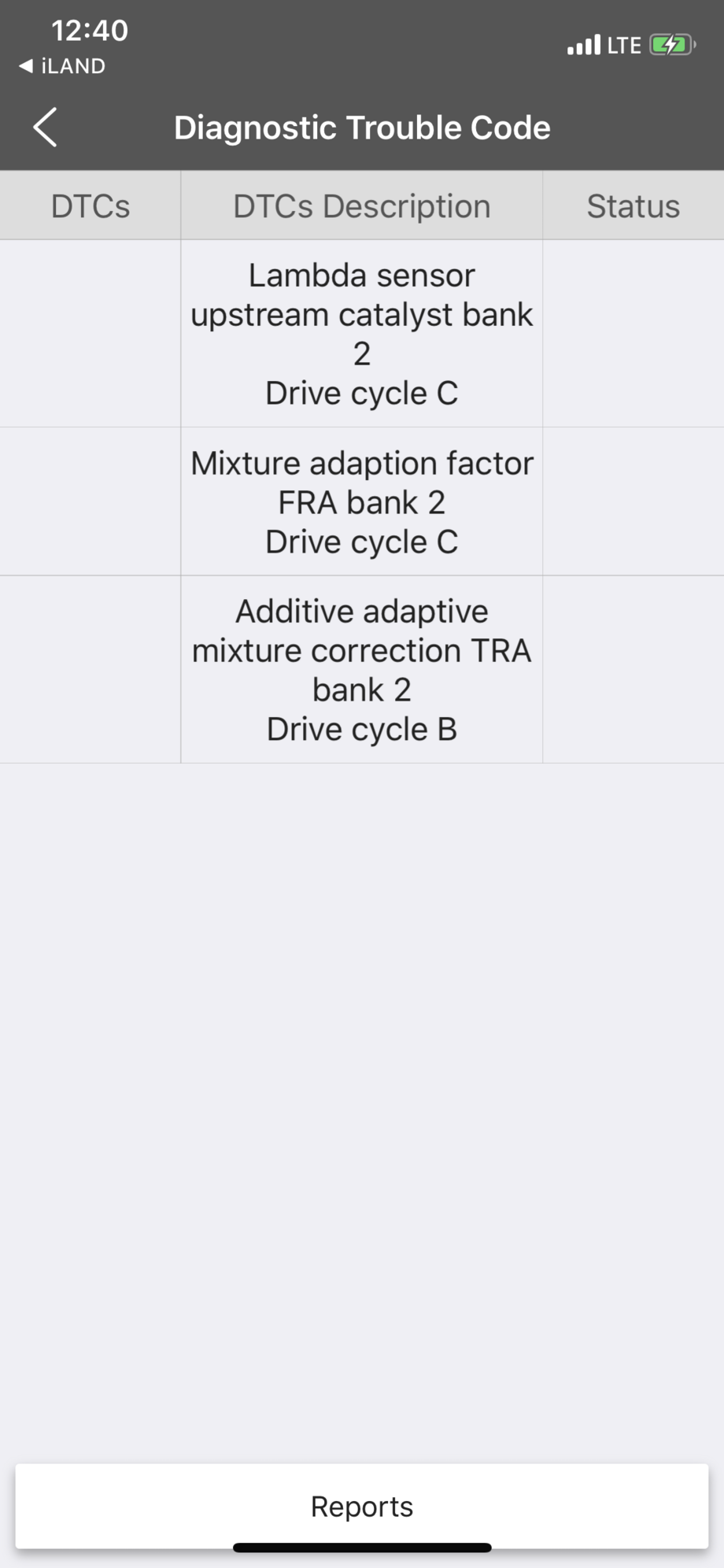

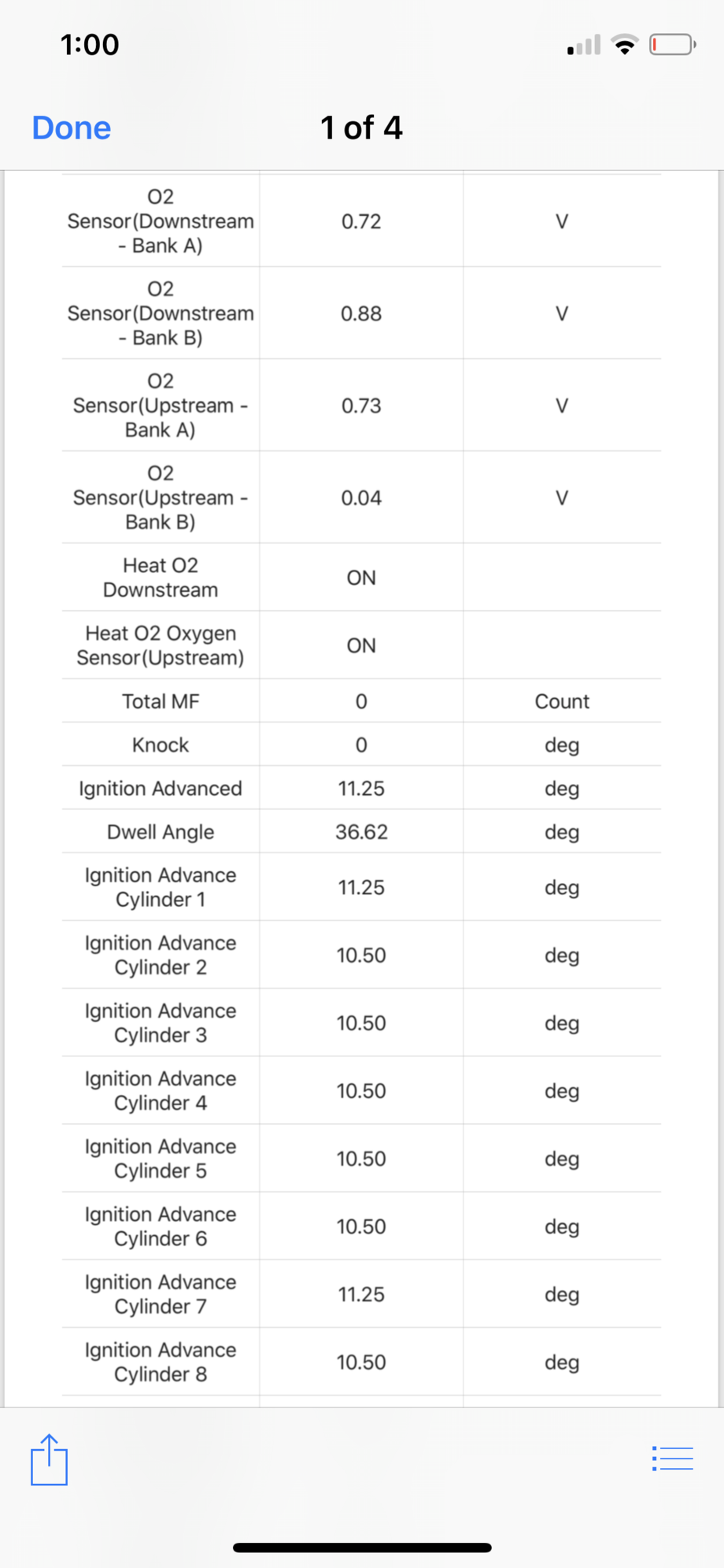

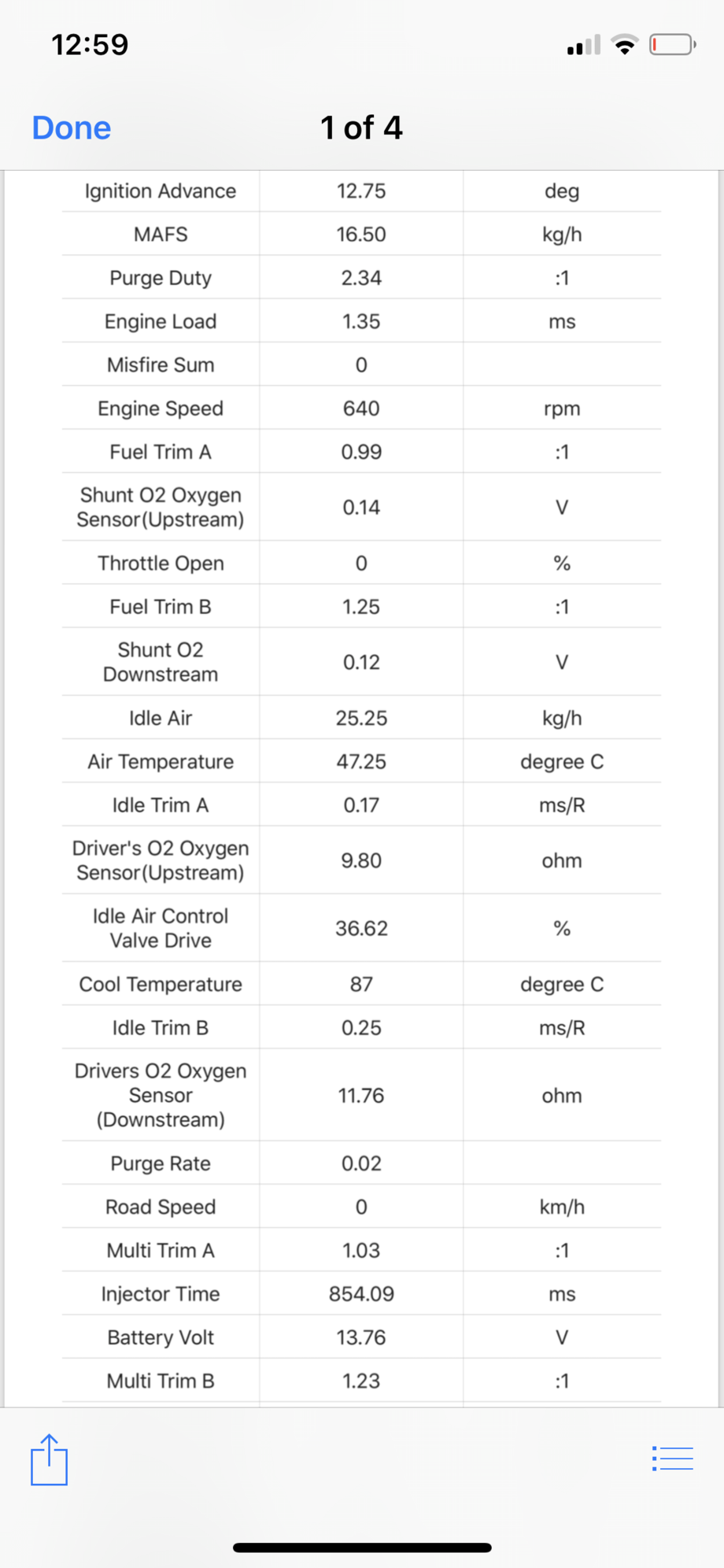

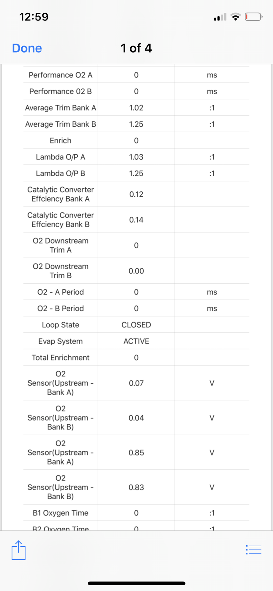

Here is some live data for anyone who can give me some input.
