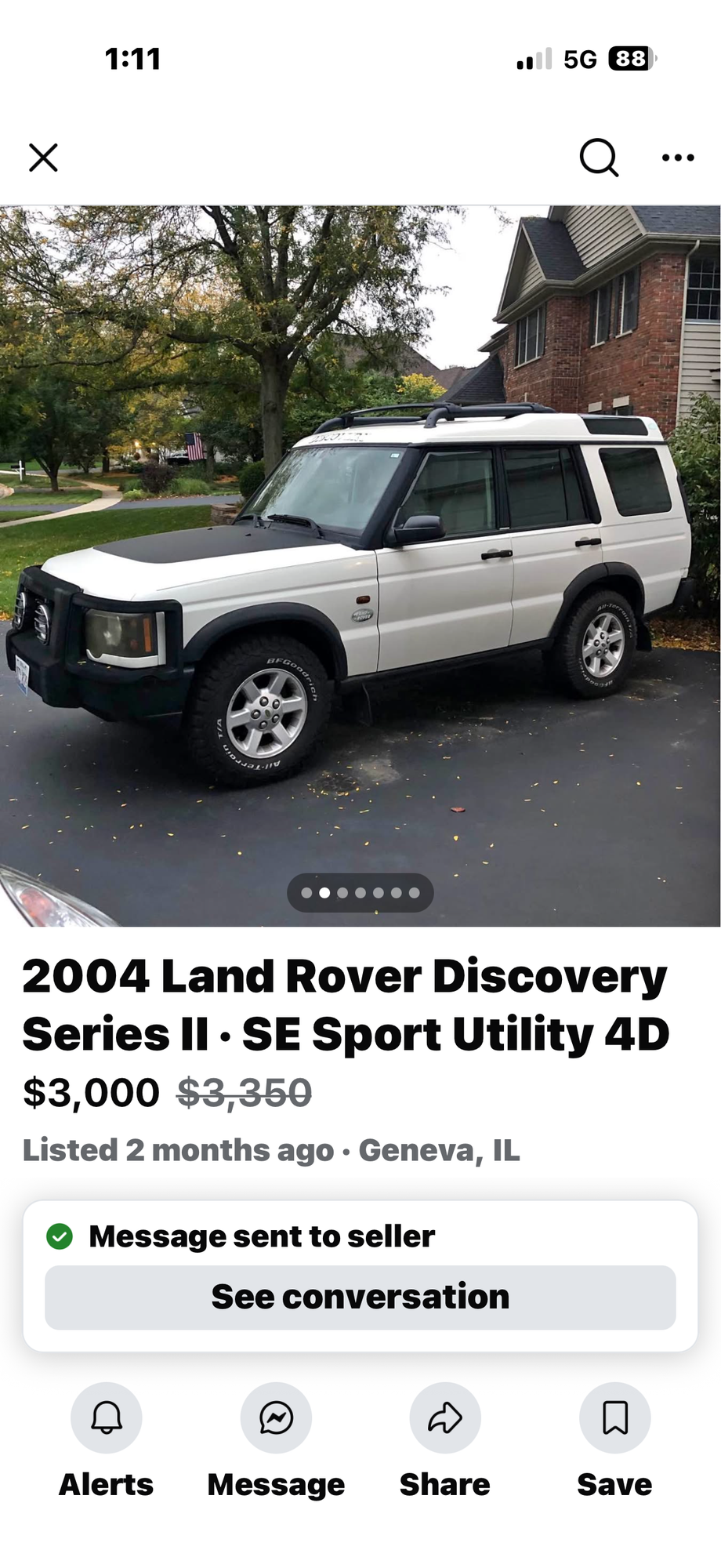

Again, thanks Extinct for your valuable posts. I will move forward with the pressure test. The coolant tank does have a small amount of seepage at a seam area when at running temperatures . Gonna install the new tank and a new stat, bleed system, test. Take it from there. A pic from the ad when I picked it up for $1800.

Good looking truck. I hope you have a long happy time with her.
