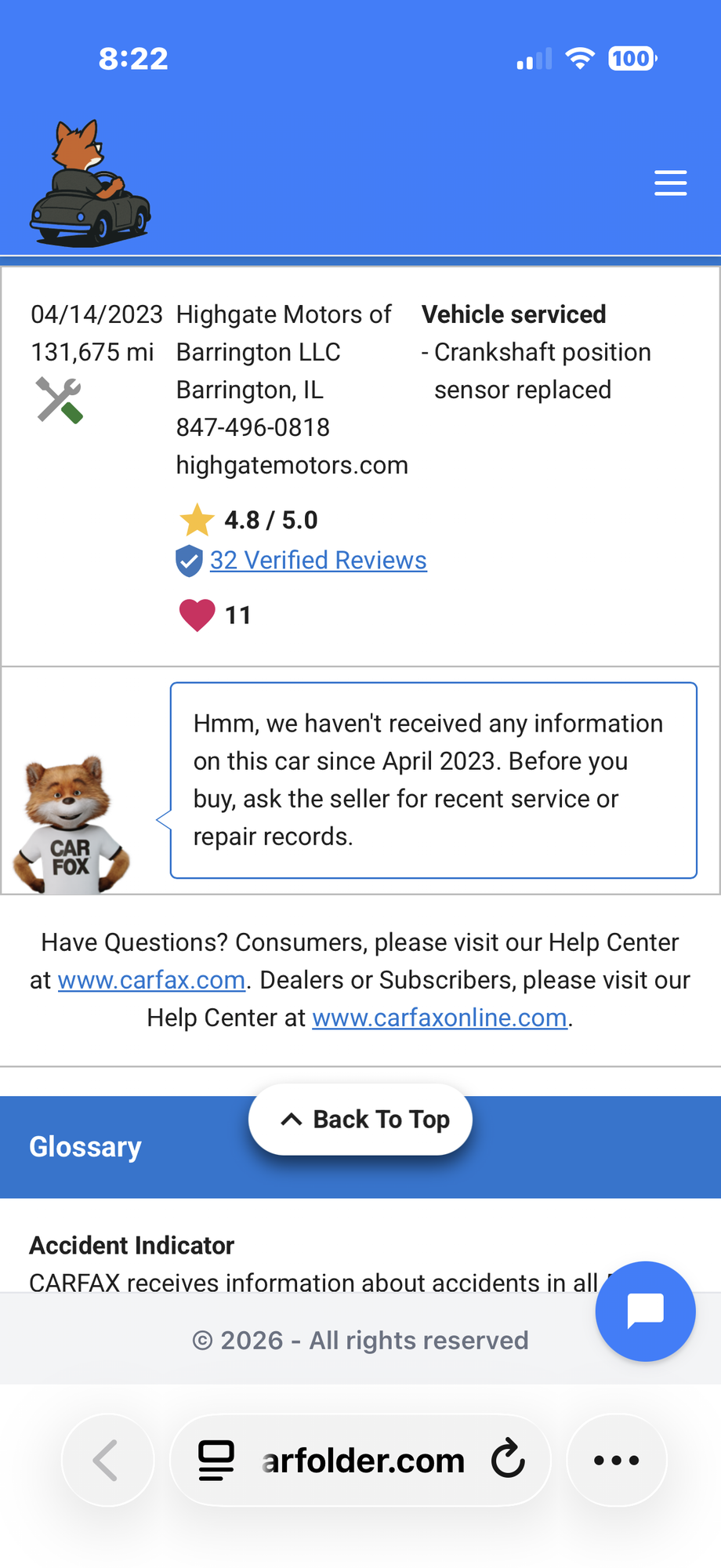

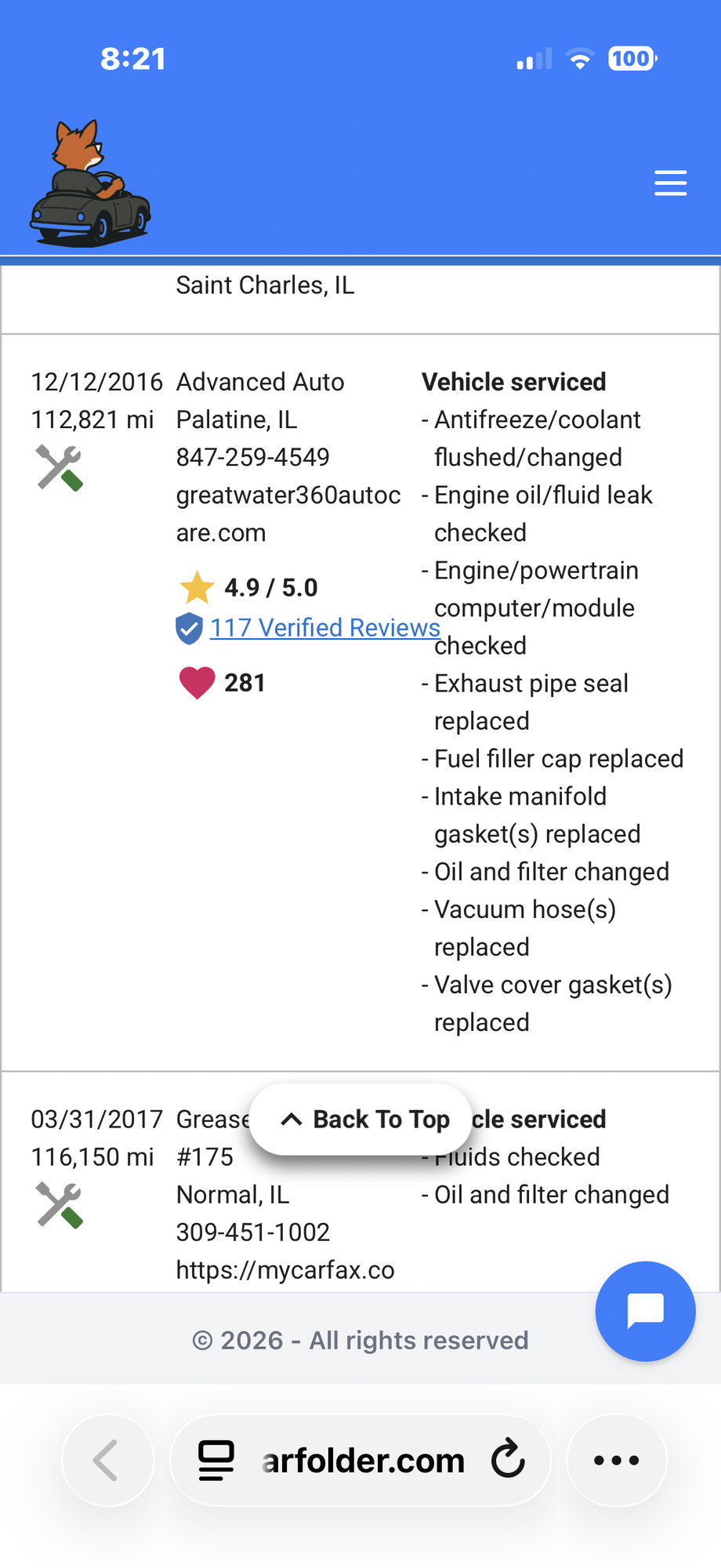

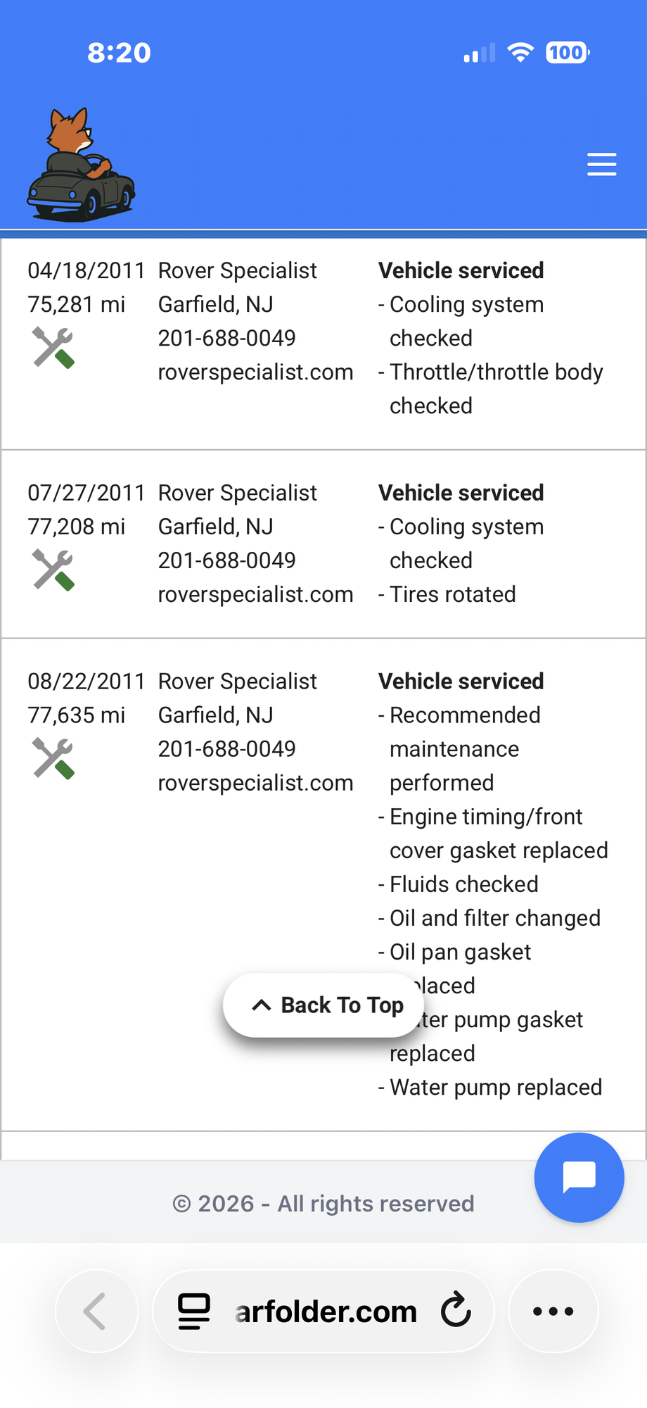

Nice looking truck. Did previous owner reveal any issues? Have you signed up for a mycarfax.com account (free), you can look up service history.
Thanks Extinct. I got a Carfax on it after I bought it. Just a couple notables on it. Could’ve had an overheating incident. Also sat for 2.5 years before the kid I bought it from got it. He only put 300 miles on it in his 6 months ownership.

Looks like they were chasing oil leaks maybe. PCV mod done? If not, do it asap. Does not affect your ticking but ticking is not urgent nor fatal and no one likes working on an oily motor. As it is new to you, you should also read the stickies and all my blog post on my site.

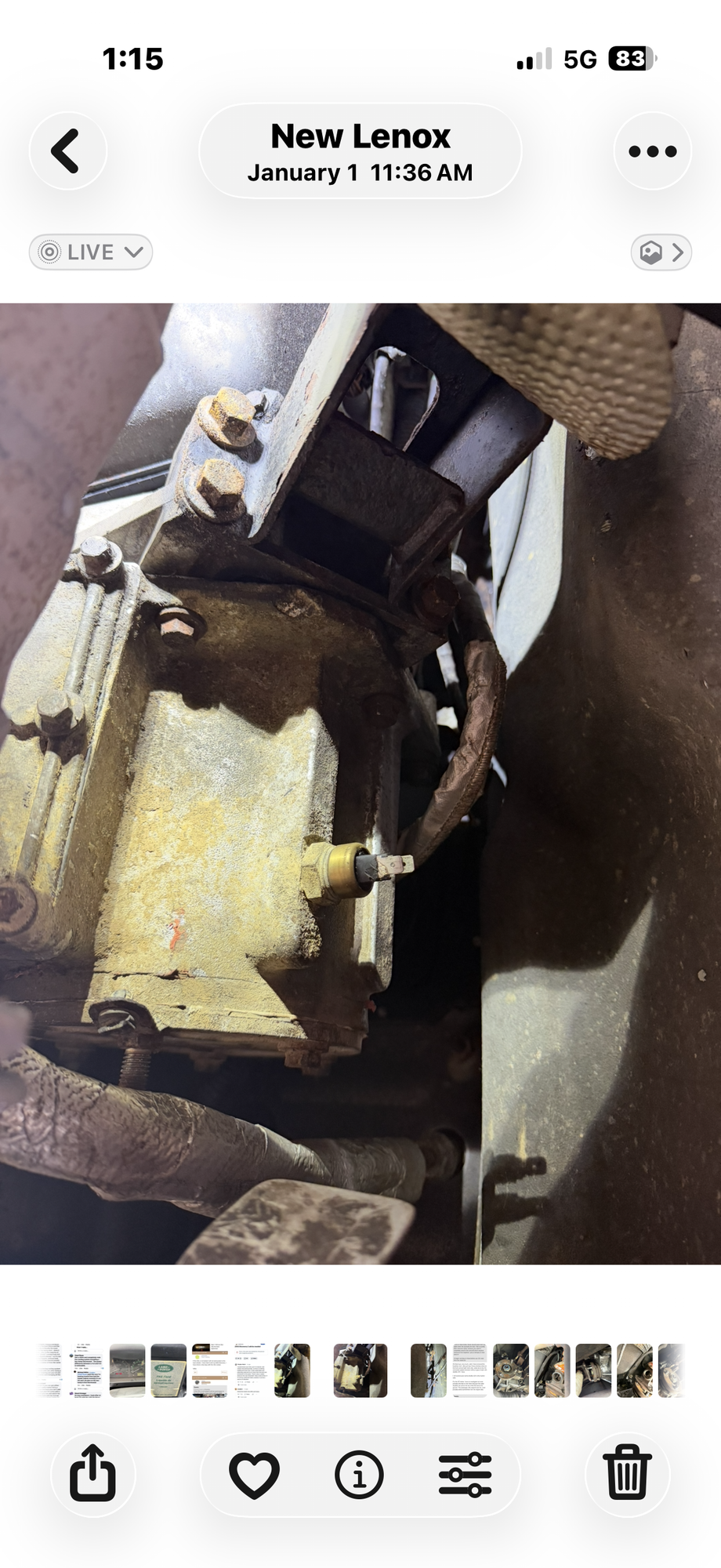

It’s been awhile since I posted. Been down with a lower back issue but healing. I did replace the front hub assemblies and cv/ axles. Still have the grinding metal noise so I got a used front differential to install. Hopefully get to it soon. I know I’m throwing parts at it but so far all these parts I’m replacing look original so it’s necessary I think.
The previous owner had the gearbox replaced and there’s a vacant electrical connector on the side of the replacement box ( pictured). The original has a plug in it. Wondering what it’s for. Thanks
Old Mar 24, 2026 | 11:18 PM
  #30
JohnZo's Avatar
Joined: Apr 2021
Posts: 1,416
Likes: 397
From: SE Washington State
Looks like a temperature sensor.
