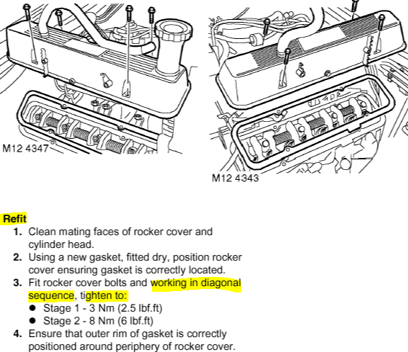

I have the right socket and some blue loctite on the way. What's the recommended torque on the valve cover bolts? Do you recommend unscrewing them completely, or just enough to get some loctite under the head?

IMHO, if you are going this far just replace the valve cover gaskets with a quality set from FEL-PRO and be done!
Rockauto has decent prices on these.

Pull the outer screws, put the loctite on the threads, tighten until snug. If it does not stop leaking, then you can do the gaskets. I've got a fiver that if you do the FV308 and tighten the screws the leaks will go by by.
