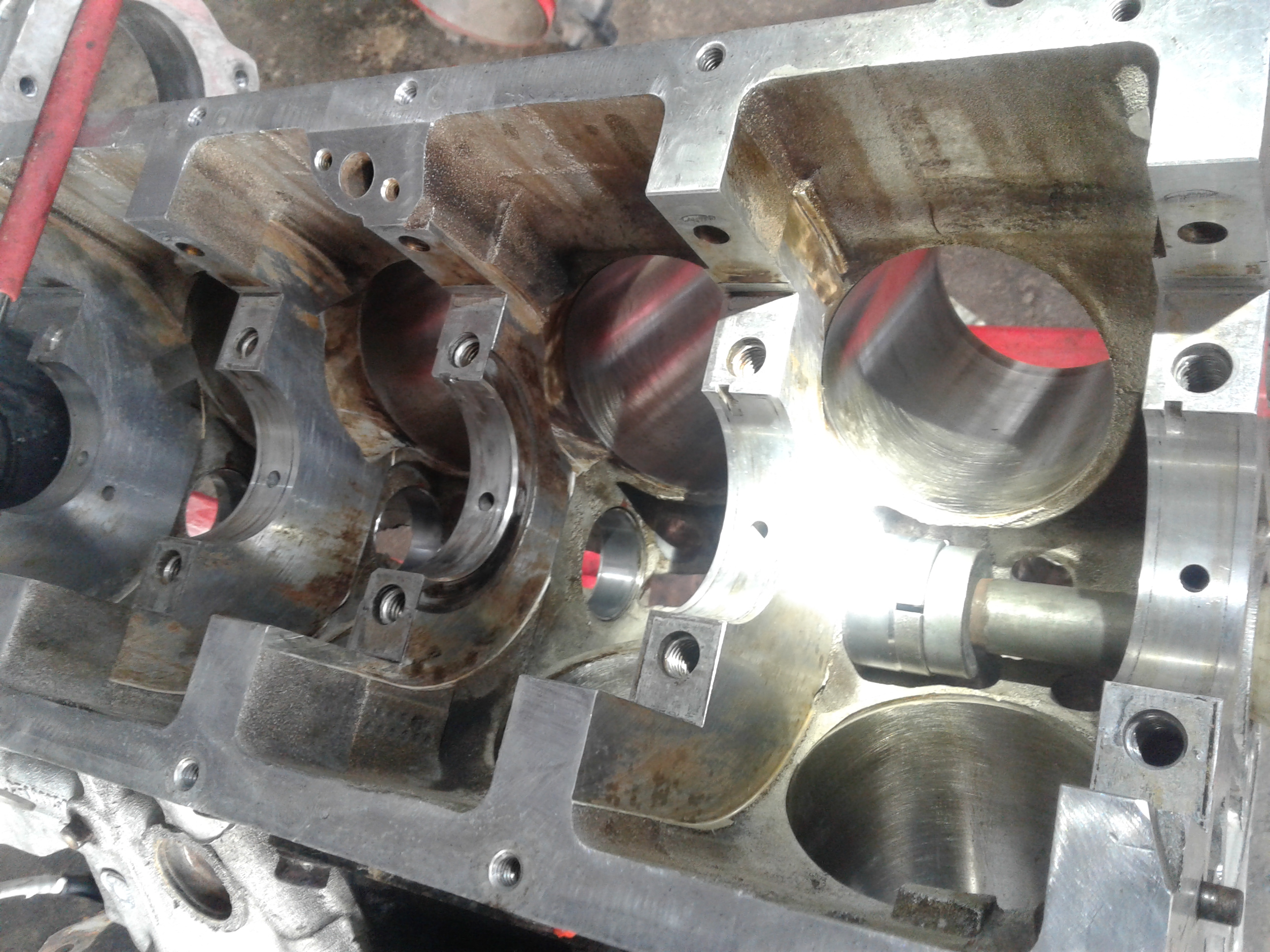

Installed the expensive new "finished" cam bearings, so the motor is now going back together!
Also cleaned the oil pan and pickup tube. ...and I used a special metal bar tool to verify that the deck of the block and bore of the cam area inside the block were perfectly flat+straight. Passed!

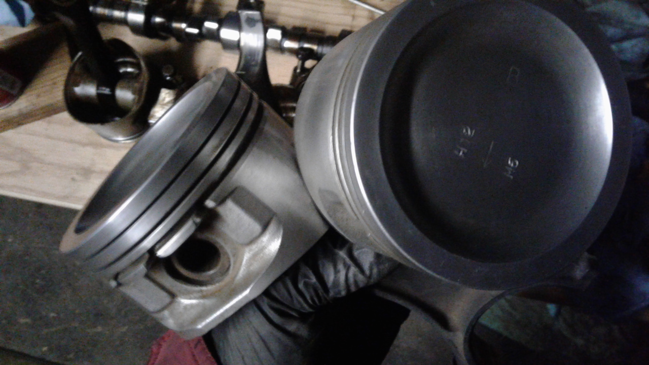

Grrr... crankshaft still isn't ready from the machine shop.
But, I've begun removing piston rings and cleaning pistons. Here's #2 cleaned next to #4 not yet cleaned, then both cleaned.
