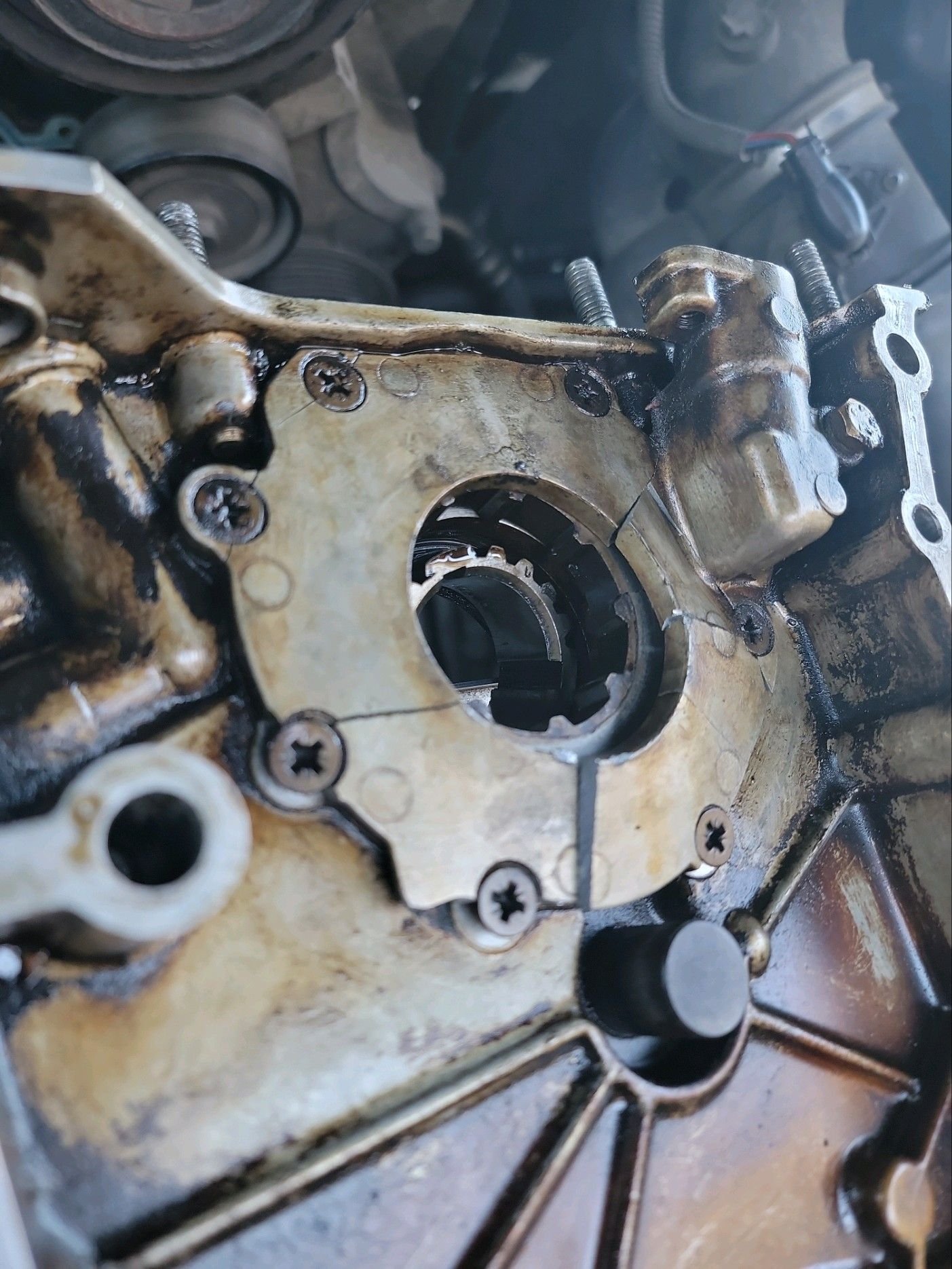

For anyone wondering about pulling timing cover without oulling water pump. 100% easy and fine. Its still pressed together by plenty of hardware
Thanks to Extinct, that picture shows what needs to be pulled. Those particular bolts also have clear channels behind the water pump where they go into the block.
As for my dumbass
I went to reinstall the harmonic balancer and pushed the oil pump gear through the back of the bracket inside the timing cover
oh well, live and learn, new hardware on the way. Everything will button up quick and easy after. Bringing new water pump that was recently replaced to the new timing cover. Gonna resurface the actual timing cover and keep and eye out for the planetary gears in the oil pump just in case of emergency.
That's where I've been. When the new timing cover comes, I'm considering putting in a pressure guage for the oil and a digital water temp sensor. Seen a few posts about this.
Hope everyone has had a better go with their rigs lately. Hope all is well with everyone.
This is how not to install a harmonic balancer
- Rainy
