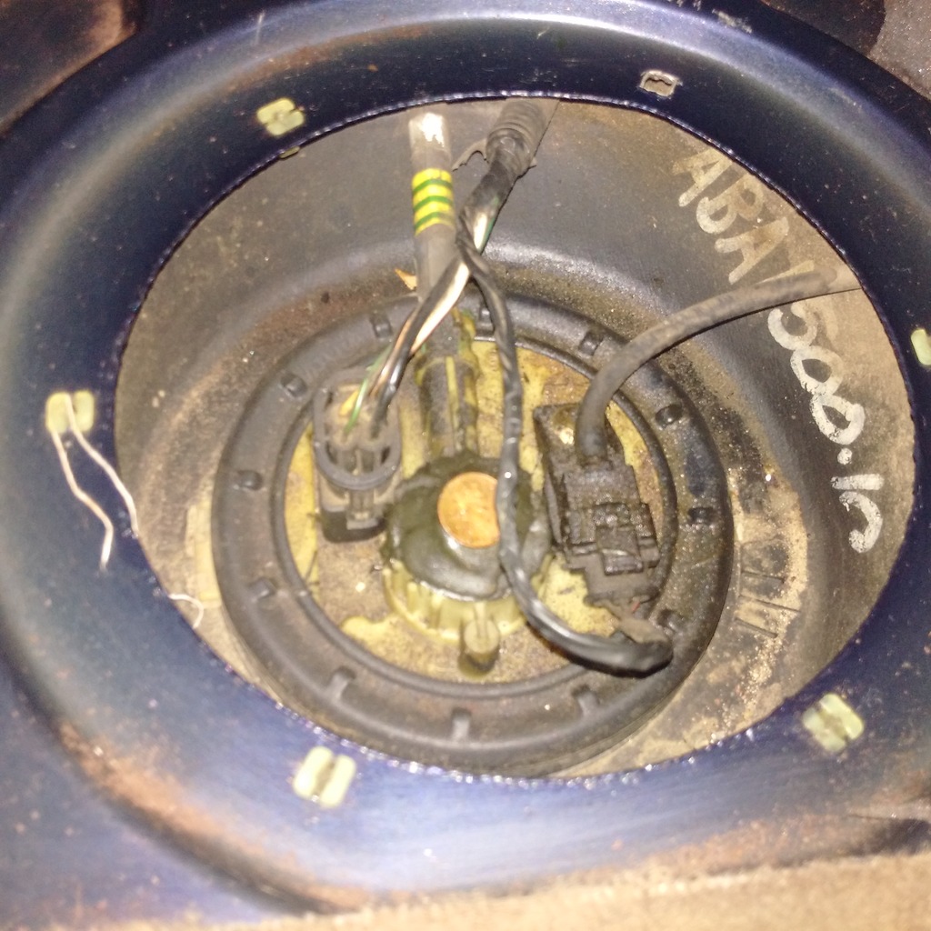

None of the new eBay ones would work. Mine has the pressure sensor on top. I finally found one for a little over 200. Since I have already fiddled with my pump one time, the carpet is cut and everything will be ready for its arrival. Sixteen years is a pretty good run for a pump.

A year ago it developed a tiny leak in the plastic 90 that goes to the hose. I JB Welded it with a lucky penny stuck to the top and, again, a year for that kind of jackassed repair isn't bad.
