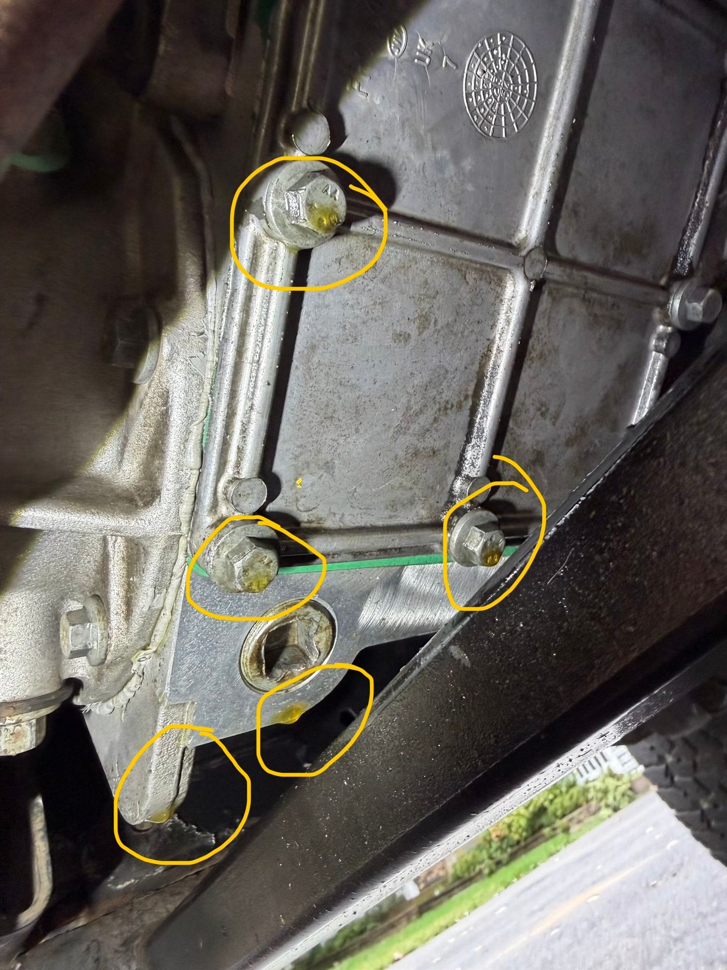

Update: at the beginning of July, I had an Indy LR shop drop and reseal the transfer case. They actually had to drop and reseal twice as they saw it was still leaking after the first time reinstalling. I’ve put about 1000 miles on it since (mostly around town) and it’s been dry.
This Friday I bailed on my father in laws birthday to go to my first MAR (he wanted me to go, wife is still pissed). Drove down (125 miles), paid, set up camp, and got about 2 hours of green and yellow trails in low range before I realized the tcase was leaking again. Unfortunately I didn’t have the fluid or tools with me to just keep it topped off and was in a bad mood as I just paid $2k less than 3 months ago to have it good to go for MAR so I ended up just packing up and went home. I’m sure I could have kept driving for the weekend and been fine but I’m an anxious guy and figured better safe than sorry. Huge bummer though.

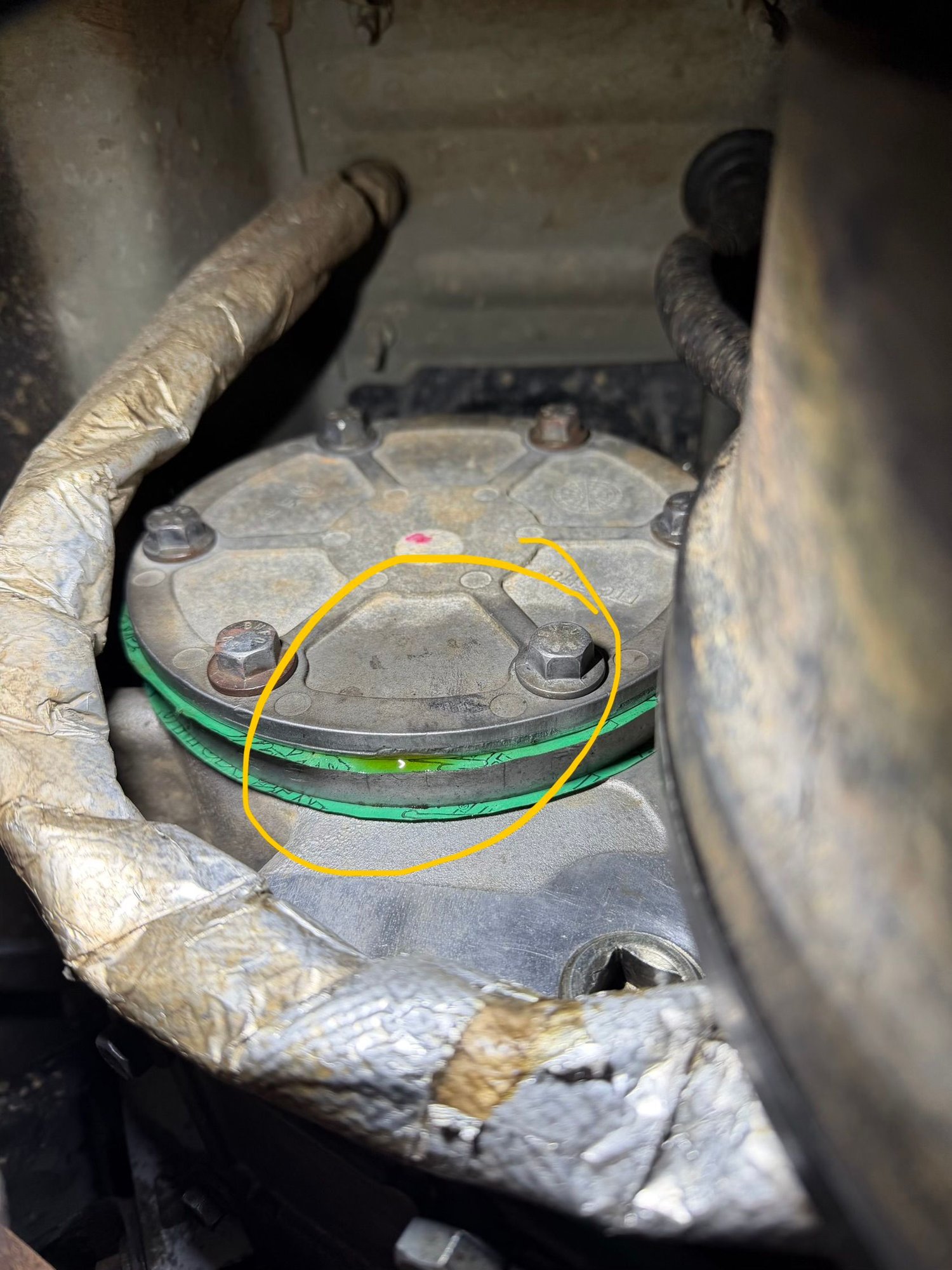

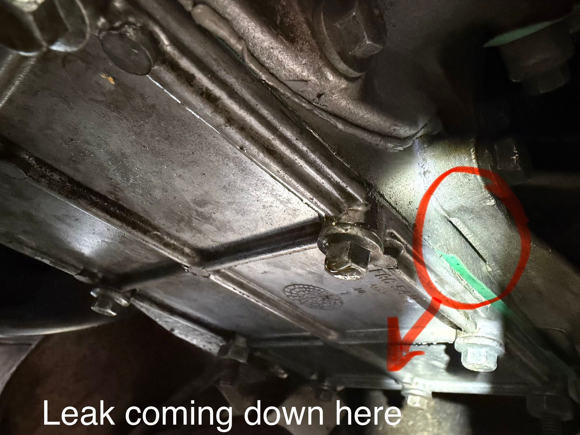

Anyway it’s not leaking from the intermediate shaft anymore. I think it’s leaking from the main input seal where it connects to the trans and definitely on the rear cover plate. Pictures below for reference. What do y’all think? Take it back to the shop and have them redo it again? Throw some blue devil in there and hope for the best? I think I can remove the rear cover plate without removing the tcase to throw some rtv on there but the tcase has to be dropped in order to replace the main input seal which is where the majority of the fluid is coming from.

Too bad I left early, I hoping to meet you Extinct! Could have shown you the nice new see through plug on my transfer case you made showing how low the fluid was in it lol. Next time!
Just wanted to throw a follow up to this thread - the indy shop did the right thing by dropping and resealing the tcase again at no cost to me. They blamed the paper gaskets from AB, said they would no longer be using those in the future and used RTV on everything instead the second time around. It's been almost 9 months and another couple thousand miles, and the tcase does seep but not bad. No active drips, it just looks like it's seeping from either the mainshaft oil seal or the front output RTV seal wasnt perfect. I just keep my eye on the level at this point.
