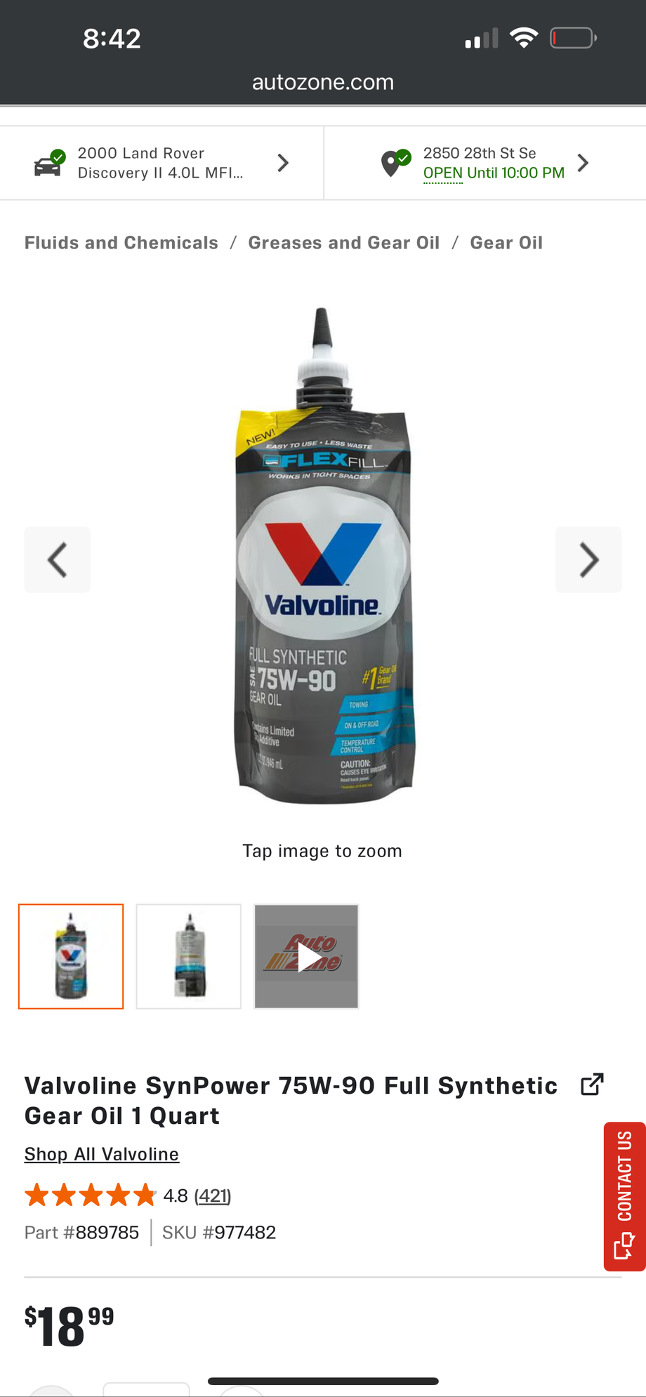

I own a 2000 Landrover discovery 2
says to Use Texaco Multi-Gear 75W/90R or oil meeting specification API GL5.
can’t seem to find Texaco so I found valvoline 75w90.
Will this work or what have you guys used that works well with transfer case?

Pretty much any good quality 75-90 will do. I personally use Mobil 1 Delvac 75-90.

If you live in hot climate you can consider going up to 75w-140 and slow down the inevitable leaks.
