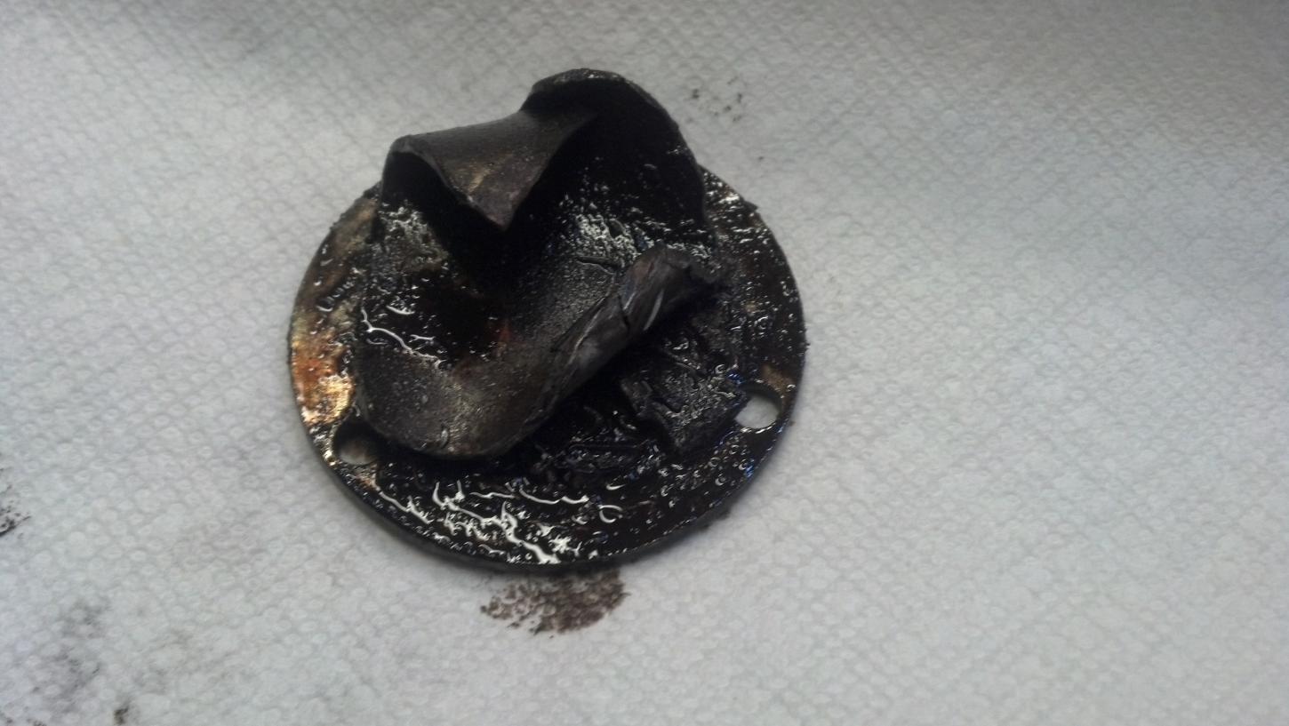

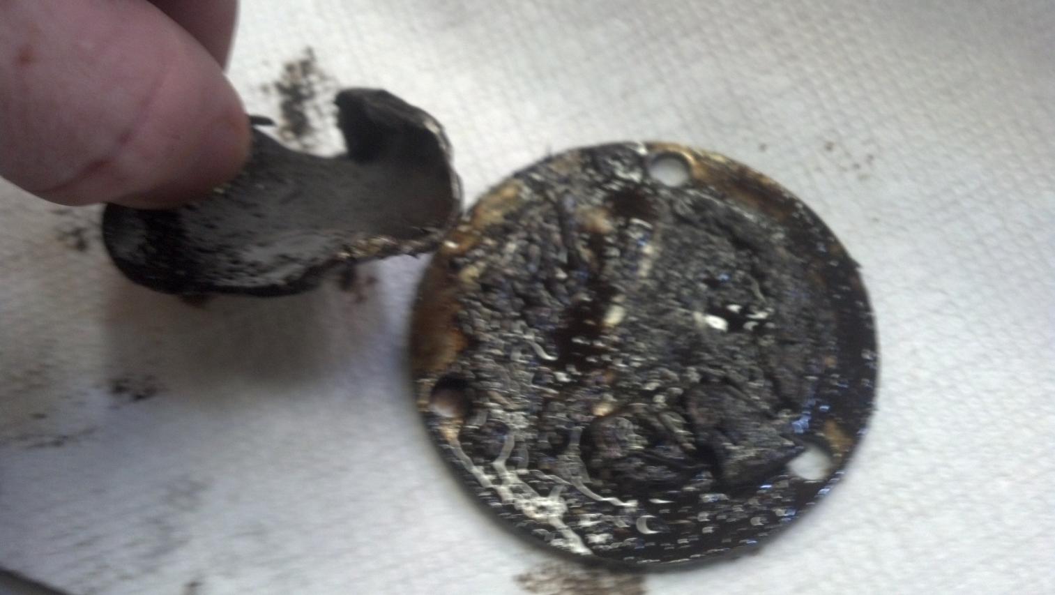

Thumbs down Problem diagnosed
This looks like a big chunk of metal from the flywheel... this is the Bell Housing inspection plate and it came out with this hunk of metal on it..

Your flex plate ground up.
Or your Torque convertor has gone south. Or north in the summer.
Transmission may be polluted with particles.
You need to get it all pulled apart now.
You may want to find a Discovery with a bad engine and put your good engine in to it.
That may be cheaper - believe it or not.
