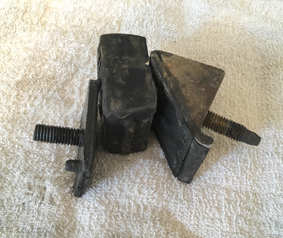

Here's a pic of the old mount. Y'all might oughta check yer engine and trans mounts.

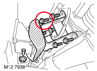

Do any of you have any tips and tricks about how to remove the bolt circled in the upper left of the attached screenshot from the RAVE? Thanks.

I used two long swivel extensions thru the holes in the mount/frame area.
