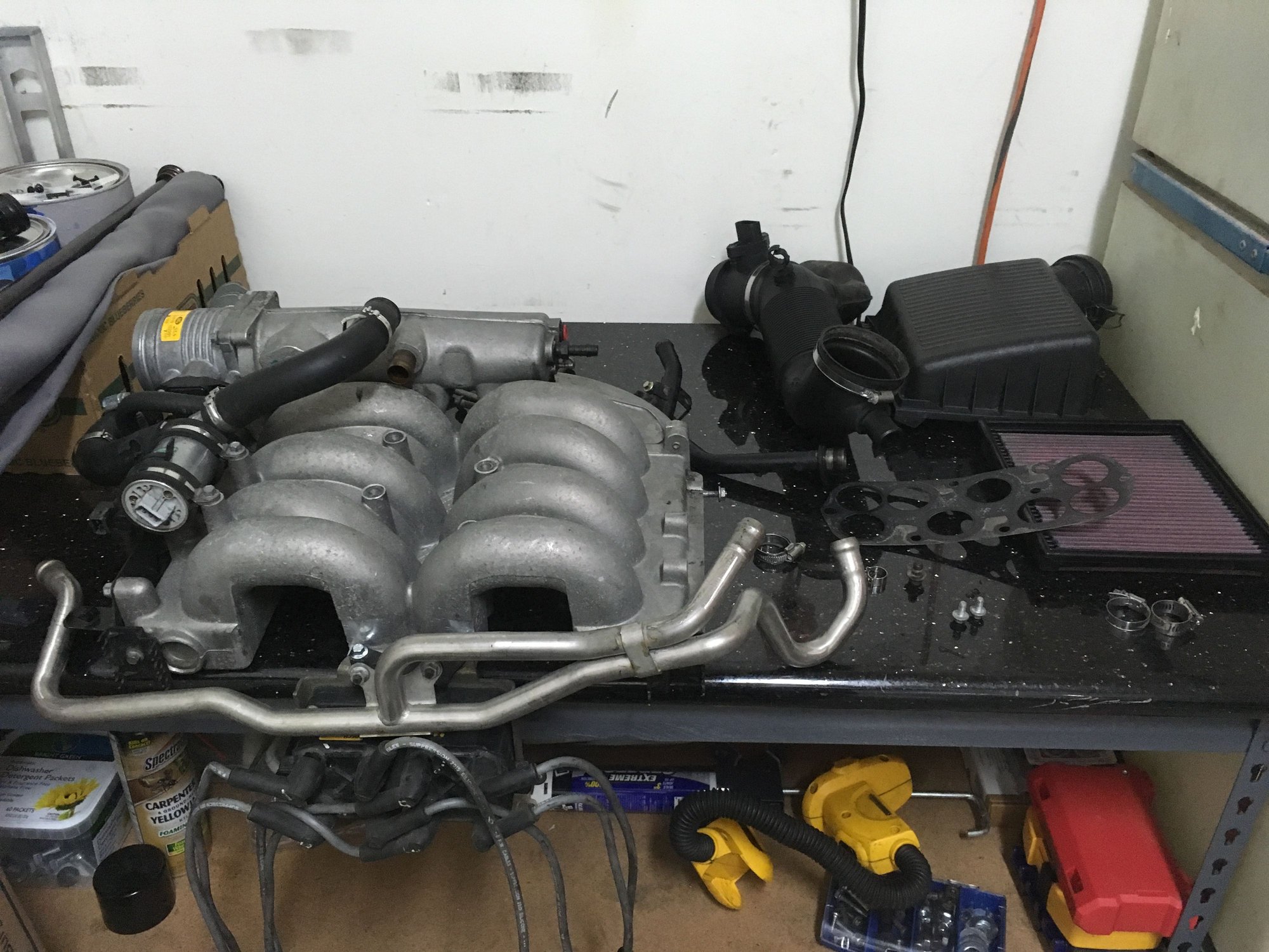

I was not planning on taking the truck apart till the new parts showed up but, I was bored and decided to pull it apart. Truth be told, I had all this off in about 1 hour 30 minutes.
Bad news...looks like I need to replace the heater inlet pipe as the gasket is shot to hell
