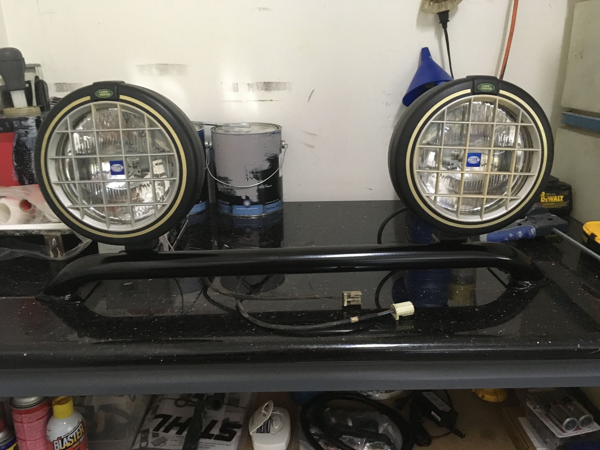

Oh yeah, I'de run all 4 as high beams, lol

Oh, they're not the factory lights. I'd compare the amp draw on the factory ones before running those on factory wires. And I wouldn't use those on the road or you'll get pulled over.
If it were me I would wire these up properly to an AUX fuse panel with proper wiring and a cruise control switch. Weatherpack connector for quick disconnect.

They are the Safari LR Aux lights from Best4x4
https://landroverforums.com/forum/pr...-lights-88390/
I have tested them out using the existing fog light wiring, connectors, and switch. All is good.
