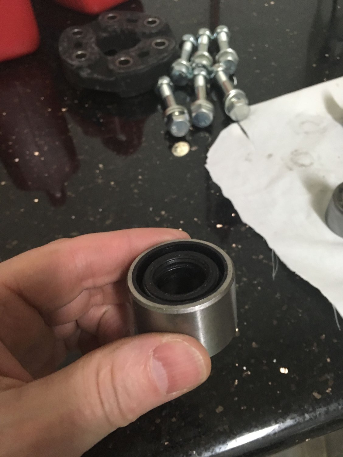

UPDATE
Got everything out (see picture) However, I also pulled a bearing out, seems like a little bit of play in the bearing. Should I replace??
My shopping list now
Corteco seal
GKN Rotoflex

UPDATE
I am stuck again. I need to get the grease seal out of the rear driveshaft and replace. How does one do this or rather what is the trick?
