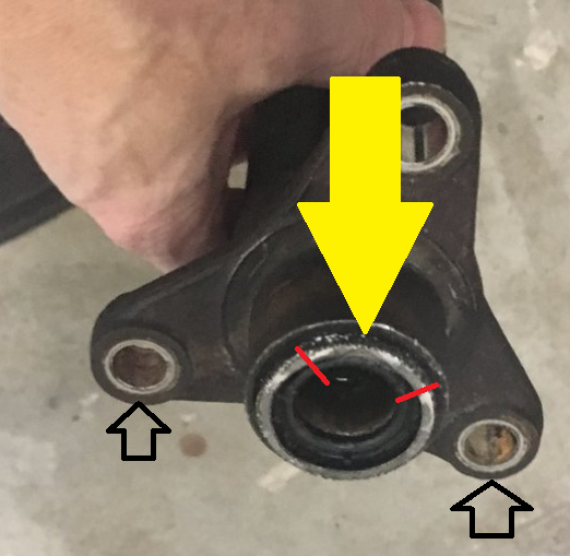

You can buy the tool, but you don't need it. All you need is a Sawzall ( reciprocating saw ) or a single blade hacksaw (no top hoop) and a chisel.
Put the drive shaft in a vise (or have someone hold it) and make 2 shallow cuts where the RED LINES are (see pic below).
Just go slow with the saw and you will only cut the bushing and not the drive shaft.
Now place the drive shaft on a bench so the flange makes 2 points on contact ( BLACK arrows ).
Then take a Chisel and strike the bushing down towards the bench ( YELLOW arrow ).
This will make enough relief in the bushing to be able to grab the rest with a pliers.
If not then tap the chisel between the bushing and the drive shaft to walk the remaining bushing out.
This is really simple and once you start these steps I think you'll agree.

Originally Posted by Friday Night Disco
Thanks for the feedback, I will take a shot at it in the morning and provide an update
Cool you'll definitely get it done.
Once cut, you will be amazed at how easy the metal around the bushing just twists apart.
Last tip; put the NEW bushing in the freezer over night.
Then in the morning clean the drive shaft end ( scotchbrite pad ), put some grease around the bushing (install it cold) and in it goes!

UPDATE
I got it out. Used the hacksaw to get the inner bushing out with aid of a screwdriver & hammer and used my Dremel tool to get the outer bushing out. Cleaned it up, put some axel grease in the opening, and knocked the frozen bushing in with a piece of wood and mallet.
