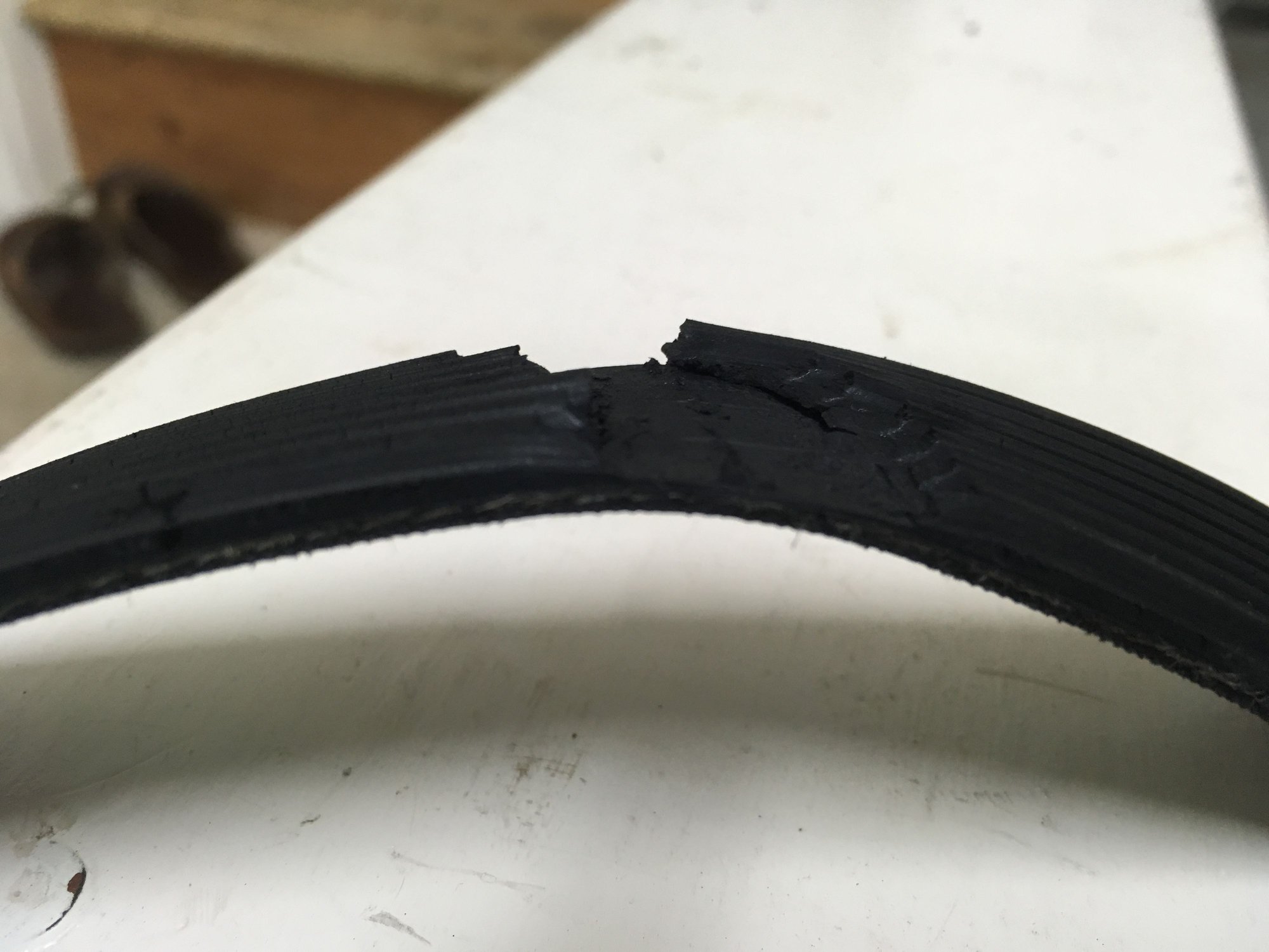

Update...
While wrapping up another project (removal of heating plate/ exhaust leak) I noticed that the serpentine belt had a large chunk missing. I just replaced the old with this new one about 1,000 miles ago. Luckily I saved the old one.
Next steps...
Remove bad belt
Check each pulley for any wobble or resistance
Old Dec 18, 2017 | 05:05 PM
Friday Night Disco's Avatar
Joined: Dec 2016
Posts: 1,603
Likes: 229
From: Fall City, WA
Update...
It was the serpentine belt (see below)
I also checked each pulley and no play easy to move forward and backwards. For good measure I hit all the pulleys with a scot brite pad.
Tick is gone, just need to order a new serpentine belt, odd how the new went bad so quick

What brand was the belt? I had a Goodyear Gatorback/Conti Elite belt fail catastrophically after ~7,500 miles.
AllMakes 4x4 from Amazon

WOW shocking another fine piece of from ALLMAKES! And +1 Avoid the Goodyear/Conti belts.
PLEASE get a GATES Belt and get back to HAPPY TOWN.
You either need a #K017065 if your truck has AC and ACE
OR #K070922 if you have AC and No ACE. You can get them online or any NAPA sells Gates Belts.

Going to order Land Rover brand from Amazon. Thanks for the feedback
