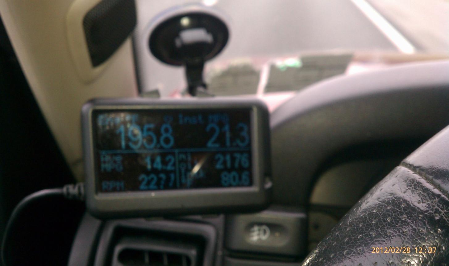

After playing around with mine and having for a wee bit now i personally only have it set to one page with the infomation that I want to see. Personally i dont need to know what the O2 sensors are doing or alot of the other peramiters until they go wrong so I have mine set to Temp, instant MPG, average MPG, RPM, oil milage and intake temp. SWMBO calls it my panic gauge and the only down side is that she can see the great MPG that I get BUT it means she drives slower now she can see the single digit MPG when she drives...lol

What range of temps do you get on the D2?

2000 D2 SE7 w 140k . Usually between 188 - 195F. Today w 70F ambient, turned on AC setting at 64f car
was @ 186F. Haven't seen 200's yet.
