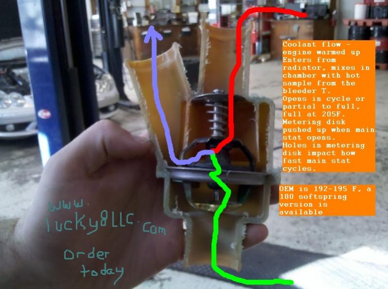

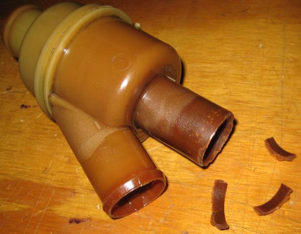

re: just because you have a soft stat doesn't mean you will run at 180. it means the coolant to your heater and radiator will flow at 180 degrees.
Seems like there is more to it. The soft spring allows the port to the heater to open at less pressure. There is only one thermostat element, and when the main opens it shoves the bypass element with the soft spring closed. Truck should not run with a working 180F Rover thermostat in cool weather with a good radiator at 195 - 205 F. The job of the thermostat is to set the lower temperature the engine is maintained at. As engine heat increases, thermostat opens more. At 20F over base temp, most stats are fully open, and no longer control the situation. The radiator, water pump, rpm, fan, fan clutch then become limit factors. I think radiator in this case is suspect. Or there is a lot of trash in the holes of the top disk of the stat, which will make it open late.
Because of the remote nature of the D2 stat (hanging in mid air instead of inside the block) there will be some "delta" between temp displayed (top of engine) and temp inside the stat. But not 20F.
Would agree that you are not in a danger hot zone. But if truck is running this temp (which for the state thermostat is wide open (205F) then what will be left to cool the truck on a hot day? And why do others have lower temps with the 180F stat? Seems to me thermostat is at the end of the range it is designed to work in, it is not normal to run wide open under moderate loads and temps.

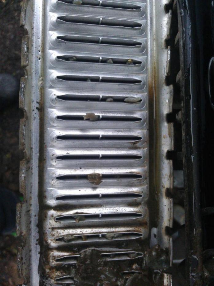

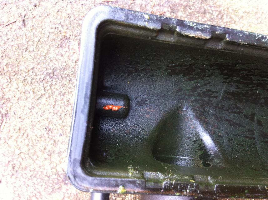

If tinkering with rad be careful about the plastic lines, they will snap off just to spite you. Not much on the back side of them.
Rad can have calcium buildup (those chips go all the way across).
