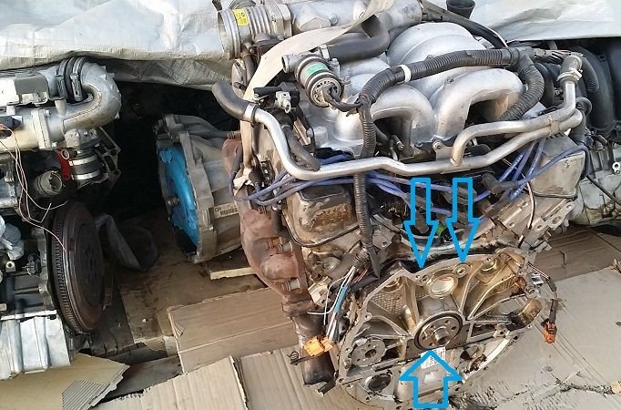

Probably the round Torque Converter plate in the bottom of bell housing.
IF it's leaking oil it can be a bad rear main seal and/or one of the 2 oil ports, or the camshaft cover (lives between the 2 oil ports).
Either way lots-o effort to fix. Good Luck!
I covered my camshaft cover (can you cover a cover??) with JB Weld because I did not want to have to pull my motor again...to fix that sort of leak in there.
Ugggh. Not fun.

Yup overover has the right pic thanks guys for the info
