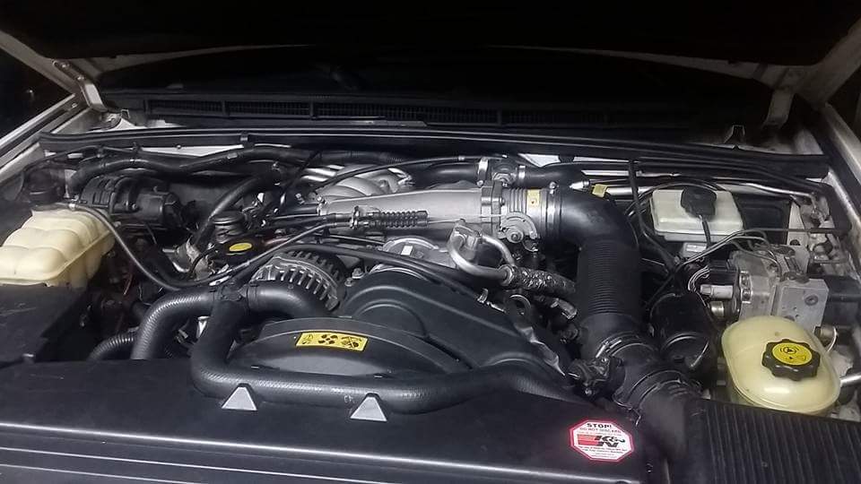

That is it. This thing will be 100% refeshed and daily maintained after that. The engine is a 4.0, it is strong and very clean it seems. Before - stripped out
Post Headgasket -- My local guy has a great shoppe, took great care of my heads for me.

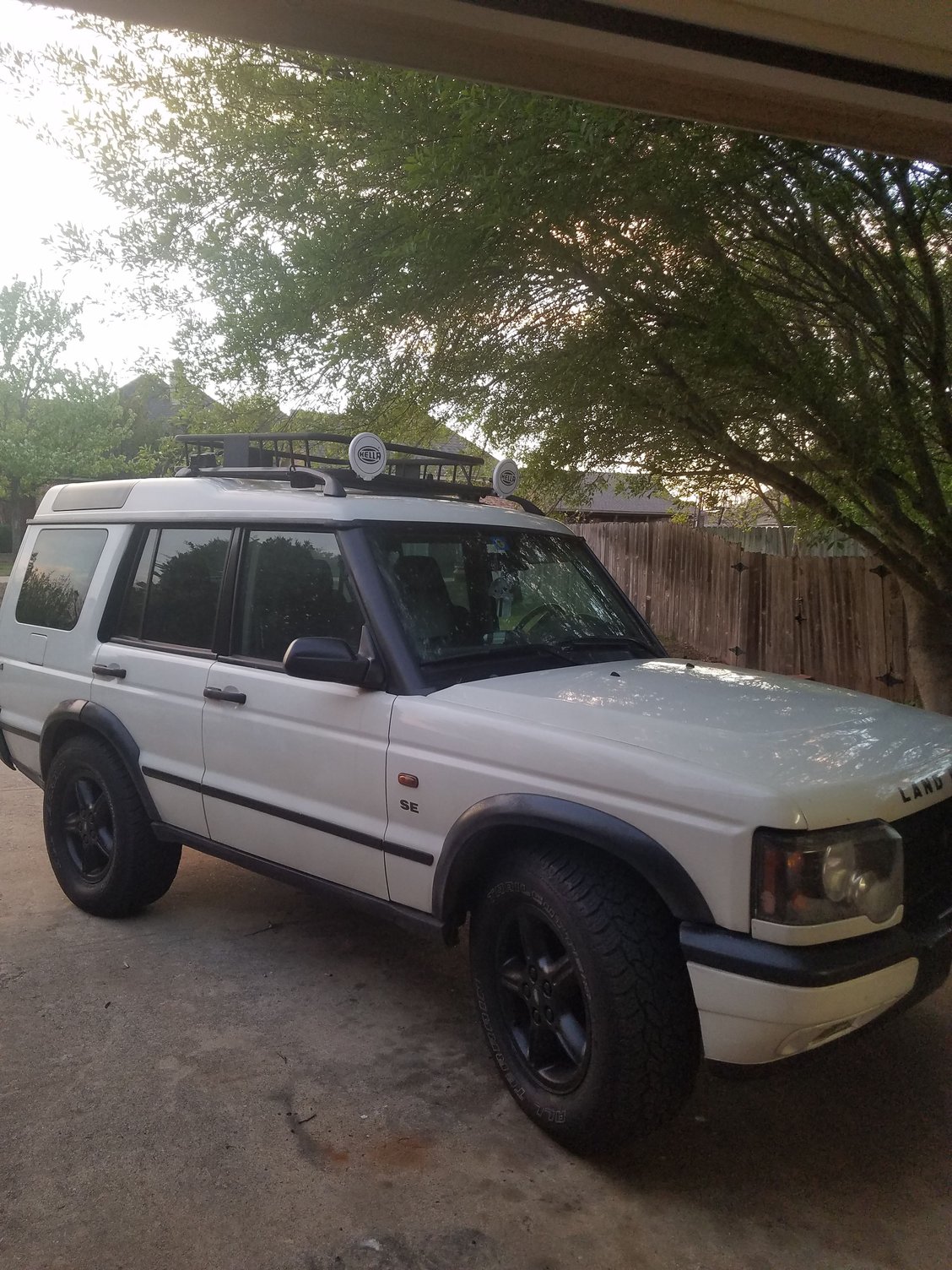

Final product phase 1
Current look. We are about to start phase 2, where most of these exterior changes will show.
Luckily, an older mom owned this Rover before me, the interior is just about perfect.

More pics of the saudi grille. Also, I hope you're not actually using a K&N filter in there
Old Apr 4, 2018 | 10:25 AM
RoverJayTX's Avatar
6th Gear
Joined: Dec 2015
Posts: 6
From: Dallas
I am, why?
I have been for 6 years now, same filter. I use a little dawn and water and tlc. Never had a problem there unless I don't know about it?
I have over 100k miles on it this way.
It is about time to get a new one though, this one barely shapes to the box anymore..
I've been running one for about 30k miles, no issues. BUT I am planning on going back to the paper filter just because of all the negative feedback the K&N gets on Land Rover applications. It's on the list. I don't over oil mine though either, so....
